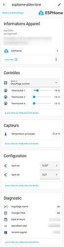

Ma config :
uart:
  baud_rate: 19200
  tx_pin: GPIO16
  rx_pin: GPIO17
  parity: EVEN
modbus_controller:
- address: 0x1
binary_sensor:
  - platform: modbus_controller
    device_class: problem
    entity_category: diagnostic
    icon: mdi:air-filter
    register_type: holding
    address: 0x0082
number:
    icon: "mdi:thermostat"
    unit_of_measurement: "°C"
    address: 0x96
    value_type: U_WORD
    min_value: 16
    max_value: 31
    use_write_multiple: true
    multiply: 100
  # - platform: modbus_controller
  #   name: "Thermostat 2"
  #   icon: "mdi:thermostat"
  #   unit_of_measurement: "°C"
  #   address: 0x97
  #   value_type: U_WORD
  #   min_value: 16
  #   max_value: 31
  #   use_write_multiple: true
  #   multiply: 100
    address: 0x98
    value_type: U_WORD
    min_value: 16
    max_value: 31
    multiply: 100
    address: 0x99
    value_type: U_WORD
    min_value: 16
    max_value: 31
    multiply: 100
    icon: mdi:currency-eur
    entity_category: config
    mode: box
    unit_of_measurement: "€"
    address: 0xA0
    value_type: U_WORD
    min_value: 0.05
    max_value: 1
    multiply: 1000
    step: 0.001
    mode: box
    address: 0xA1
    value_type: U_WORD
    min_value: 0.05
    max_value: 1
    multiply: 1000
    step: 0.001
select:
    icon: "mdi:hvac"
    address: 0x007A
    value_type: U_WORD
    optimistic: true
    optionsmap:
      "Eteint": 0
      "Chauffage confort": 1
      "Chauffage économique": 2
      "Programme chauffage A": 3
      "Programme chauffage B": 4
      "Climatisation confort" : 5
      "Climatisation boost" : 6
      "Programme climatisation C" : 7
      "Programme climatisation D" : 8
      # "Ventilation" : 9
sensor:
    name: "Version logiciel"
    disabled_by_default: true
    icon: mdi:package
    address: 0x0001
    value_type: U_WORD
    icon: mdi:identifier
    address: 0x000E
    value_type: U_DWORD
    name: "Date et heure"
    device_class: timestamp
    icon: mdi:calendar-clock
    address: 0x0010
    value_type: U_DWORD
    name: "Temperature principale"
    device_class: "temperature"
    state_class: "measurement"
    address: 0x0078
    value_type: S_WORD
    accuracy_decimals: 1
    filters:
      - multiply: 0.01
    internal: true
    address: 0x007A
    internal: yes
    address: 0x96
    value_type: U_WORD
    filters:
      - multiply: 0.01
    internal: yes
    address: 0x98
    value_type: U_WORD
    filters:
      - multiply: 0.01
    internal: yes
    address: 0x99
    value_type: U_WORD
    filters:
      - multiply: 0.01
    address: 0xA0
    value_type: U_WORD
    accuracy_decimals: 4
    filters:
      - multiply: 0.001
    address: 0xA1
    value_type: U_WORD
    filters:
      - multiply: 0.001
text_sensor:
    icon: mdi:valve
    address: 0x0064
    raw_encode: HEXBYTES
    lambda: |-
      uint16_t value = modbus_controller::word_from_hex_str(x, 0);
      switch (value) {
        case 0: return std::string("Etat initial");
        case 1: return std::string("ECS");
        case 2: return std::string("Air");
        case 3: return std::string("Standby");
        case 4: return std::string("Standby sécurité");
        case 5: return std::string("En cours de modification");
        default: return std::string("Inconnu");
      return x;
