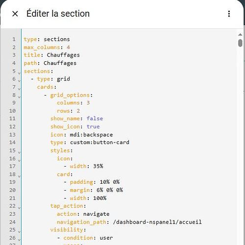

voici ma page final du moins pour la gestion des volets.
Vue PC
Vue NSPanel
Code
type: sections
max_columns: 3
path: volets
subview: true
sections:
  - type: grid
      - grid_options:
          columns: 3
          rows: 1
        show_name: false
        show_icon: true
        icon: mdi:backspace
        type: custom:button-card
        styles:
          icon:
            - width: 35%
          card:
            - padding: 10% 0%
            - margin: 6% 0% 0%
            - width: 100%
        tap_action:
          action: navigate
          navigation_path: /dashboard-nspanel1/accueil
      - variables:
        show_name: true
        show_icon: false
        name: "[[[ return variables.name]]]"
        tap_action:
          action: perform-action
          perform_action: input_text.set_value
            entity_id: input_text.selection_pieces
            value: "[[[ return variables.name]]]"
        styles:
          card:
            - padding: 18% 0%
            - margin: 5% 0% 0%
            - background: |
                  if (states['input_text.selection_pieces'].state == variables.name)
                    return "var(--paper-item-icon-color)";
                  else if (states['input_text.selection_pieces'].state == "2 Volets")
          custom_fields:
            card1:
              - position: absolute
              - width: 100%
        grid_options:
          columns: 3
          rows: auto
      - variables:
        show_name: true
        show_icon: false
        tap_action:
        styles:
          card:
            - padding: 18% 0%
            - margin: 5% 0% 0%
            - background: |
          custom_fields:
            card1:
              - width: 100%
        grid_options:
          columns: 3
          rows: 1
      - variables:
        show_name: true
        show_icon: false
        tap_action:
        styles:
          card:
            - padding: 18% 0%
            - margin: 5% 0% 0%
            - background: |
          custom_fields:
            card1:
              - width: 100%
        grid_options:
          columns: 3
          rows: 1
    column_span: 3
    visibility:
      - condition: screen
        media_query: "(min-width: 0px) and (max-width: 1023px)"
  - type: grid
      - show_name: false
        show_icon: false
        grid_options:
          columns: 1
          rows: auto
        styles:
          card:
            - background: none
            - border: none
            - height: 1px
      - show_name: true
        show_icon: false
        grid_options:
          columns: full
          rows: 1
        styles:
          card:
            - background: none
            - border: none
        visibility:
          - condition: screen
            media_query: "(min-width: 1024px)"
      - show_name: false
        show_icon: false
        grid_options:
          columns: 1
          rows: auto
        styles:
          card:
            - background: none
            - border: none
            - height: 1px
      - show_name: false
        show_icon: false
        grid_options:
          columns: 2
          rows: auto
        styles:
          card:
            - background: none
            - border: none
            - height: 1px
      - show_name: false
        show_icon: false
        grid_options:
          columns: 2
          rows: auto
        styles:
          card:
            - background: none
            - border: none
            - height: 1px
      - show_name: false
        show_icon: false
        grid_options:
          columns: 2
          rows: auto
        styles:
          card:
            - background: none
            - border: none
            - height: 1px
      - show_name: false
        show_icon: false
        grid_options:
          columns: 2
          rows: auto
        styles:
          card:
            - background: none
            - border: none
            - height: 1px
      - show_name: false
        show_icon: false
        grid_options:
          columns: 2
          rows: auto
        styles:
          card:
            - background: none
            - border: none
            - height: 1px
      - grid_options:
          columns: 4
          rows: auto
        variables:
          entitee: cover.tous_les_volets
          color: rgb(255,50,50)
        template: info
        show_name: true
        show_icon: false
        show_label: true
        label: |
            return 'Position - ' + (entity.attributes.current_position) + "%"
        entity: "[[[return variables.entitee]]]"
        name: "[[[return variables.name]]]"
      - grid_options:
          columns: 2
          rows: auto
        variables:
        show_name: false
        show_icon: true
        icon: mdi:arrow-up-bold
        tap_action:
          perform_action: cover.open_cover
            entity_id: "[[[return variables.entitee]]]"
        styles:
          icon:
            - width: 100%
            - color: |
                if (entity.attributes.current_position == 100)
                  return "grey";
                else
                  return variables.color;
          card:
            - height: 60px
            - width: 60px
            - border-radius: 30px
            - border-color: |
                  return "grey";
                else
      - grid_options:
          columns: 2
          rows: auto
        variables:
        show_name: false
        show_icon: true
        icon: mdi:stop
        tap_action:
          perform_action: cover.stop_cover
        styles:
          icon:
            - width: 100%
            - color: |
          card:
            - height: 60px
            - width: 60px
            - border-color: |
      - grid_options:
          columns: 2
          rows: auto
        variables:
        show_name: false
        show_icon: true
        icon: mdi:arrow-down-bold
        tap_action:
          perform_action: cover.close_cover
        styles:
          icon:
            - width: 100%
            - color: |
                if (entity.attributes.current_position == 0)
                  return "grey";
                else
          card:
            - height: 60px
            - width: 60px
            - border-color: |
                  return "grey";
                else
      - grid_options:
          columns: 2
          rows: auto
        variables:
        show_name: true
        show_icon: false
        tap_action:
          perform_action: cover.set_cover_position
            position: 25
        styles:
          card:
            - height: 60px
            - width: 60px
            - font-weight: 900
            - font-size: 25px
            - border: 1px solid
            - border-color: "[[[return variables.color]]]"
            - background: |
                if (entity.attributes.current_position == 25)
      - show_name: true
        show_icon: false
        grid_options:
          columns: full
          rows: 1
        styles:
          card:
            - background: none
            - border: none
    column_span: 3
  - type: grid
      - show_name: true
        show_icon: false
        grid_options:
          columns: full
          rows: 1
        styles:
          card:
            - font-size: 300%
            - color: white
            - background: none
            - border: none
            - border-bottom: 2px white double
            - margin: 0px
            - padding: 0px
            - font-weight: 500
          name:
            - align-self: start
        visibility:
          - condition: screen
      - variables:
        grid_options:
          columns: 4
          rows: auto
        template: info
        entity: cover.salon
        tap_action:
            value: "[[[return variables.name]]]"
        visibility:
          - condition: or
            conditions:
              - condition: and
                conditions:
                  - condition: state
                    entity: input_text.selection_pieces
                    state: Salon
                  - condition: screen
      - grid_options:
          columns: 2
          rows: auto
        template: up
        visibility:
          - condition: or
            conditions:
              - condition: and
                conditions:
                  - condition: state
                    state: Salon
                  - condition: screen
      - grid_options:
          columns: 2
          rows: auto
        template: volet
        visibility:
          - condition: or
            conditions:
              - condition: and
                conditions:
                  - condition: state
                    state: Salon
                  - condition: screen
      - grid_options:
          columns: 2
          rows: auto
        template: down
        visibility:
          - condition: or
            conditions:
              - condition: and
                conditions:
                  - condition: state
                    state: Salon
                  - condition: screen
      - grid_options:
          columns: 2
          rows: auto
        template: position
        visibility:
          - condition: or
            conditions:
              - condition: and
                conditions:
                  - condition: state
                    state: Salon
                  - condition: screen

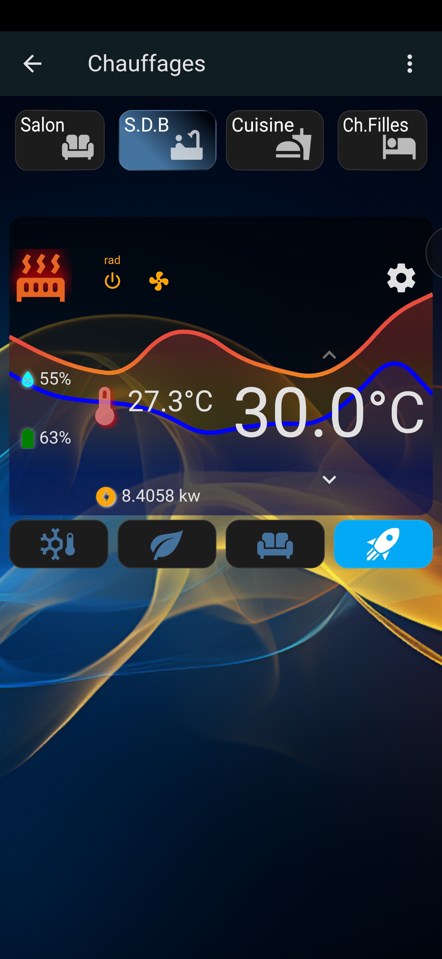

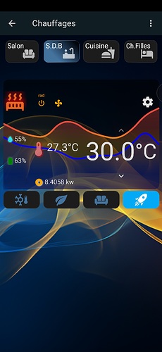

voici la suite avec la page de mes chauffages.
Vue PC
Vue NSPanel
Code

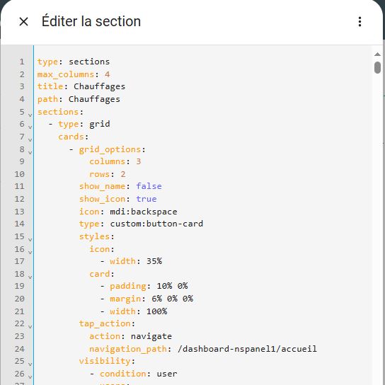

type: sections
max_columns: 4
title: Chauffages
path: Chauffages
sections:
  - type: grid
      - grid_options:
          columns: 3
          rows: 2
        show_name: false
        show_icon: true
        icon: mdi:backspace
        styles:
          icon:
            - width: 35%
          card:
            - padding: 10% 0%
            - margin: 6% 0% 0%
            - width: 100%
        tap_action:
          action: navigate
        visibility:
          - condition: user
            users:
              - fc5eca5eec334095bdbaf0583043a051

          columns: full
          rows: 0.5
        styles:
          card:
            - background: none
            - border: none
        visibility:
          - condition: screen
      - grid_options:
          columns: 2
          rows: auto
        entity: climate.thermostat_cuisine
        show_name: false
        show_icon: true
        show_label: false
        icon: |
            if (entity.attributes.hvac_action == "heating")
              return "mdi:radiator"
            if (entity.state == "off")
              return "mdi:radiator-off"
            else
              return "mdi:radiator-disabled"
        tap_action:
          action: toggle
        hold_action:
          action: none
        styles:
          card:
            - background: none
            - border: none
            - padding-top: 12px
      - grid_options:
          columns: 8
          rows: auto
        show_name: false
        show_icon: false
        show_label: false
        tap_action:
          action: none
        hold_action:
          action: none
        custom_fields:
          fen: |
              return `<br><ha-icon
                icon="mdi:window-open-variant"
                style="width: 20px; color:orange; ">
                </ha-icon>`
          alert: |
                icon="mdi:alert"
                style="width: 30px; ">
                </ha-icon>`
          power: |
              return `
              <span
                style="font-size: 10px; ">rad
              </span><br>
              <ha-icon
                icon="mdi:power"
                style="width: 20px; ">
              </ha-icon>`
        styles:
          card:
            - padding-bottom: 0px
            - border: none
            - background-color: transparent
          grid:
            - grid-template-areas: "'power power1 fen alert' "
            - grid-template-columns: 1fr 0.5fr 1fr 1fr
          custom_fields:
            power:
              - color: |
                  if (states['switch.cuisine_radiateur'].state == "on")
                    return "orange";
            fen:
              - display: |
                    if (states['binary_sensor.fenetres_cuisine_contact'].state == "on")
                      return "content"
                    else
                      return "none"
            alert:
              - display: |
                    if (entity.state == "unavailable")
                      return "content"
                    else
                      return "none"
              - color: red
              - animation: blink 2s ease infinite
      - grid_options:
          columns: 2
          rows: auto
        icon: mdi:cog
        tap_action:
          action: navigate
          navigation_path: /dashboard-nspanel1/param_chauff_cuisine
        styles:
          card:
            - position: relative
            - top: 20px
            - background: none
            - border: none
          icon:
            - align-items: end
      - type: custom:button-card
        variables:
          hum: sensor.cuisine_capteurs_humidity
          batterie: sensor.cuisine_capteurs_battery
        template: info_chauffe
        grid_options:
          columns: 6
          rows: auto
      - type: custom:simple-thermostat
        hide:
          state: true
          temperature: true
        label:
          temperature: T°
        layout:
          step: null
          mode:
            names: false
            icons: false
            headings: false
        control:
          - null
        header: false
        grid_options:
          columns: 6
          rows: auto
        card_mod:
          style: |
            ha-card {
                background: rgba(0,0,0, 0);
                border: none;
                --st-font-size-xl: 60px;
                --st-font-size-m: 50px;
                --st-spacing: 1px;
                --st-font-size-l: 60px;
      - variables:
          mode: frost
        template: mode_chauffe
        grid_options:
          columns: 3
          rows: 1
      - variables:
          mode: eco
        grid_options:
          columns: 3
          rows: 1
      - variables:
          mode: comfort
        grid_options:
          columns: 3
          rows: 1
      - variables:
          mode: boost
        grid_options:
          columns: 3
          rows: 1
    visibility:
      - condition: user
        users:
          - ef27be782c824f3298261b3dc9c614dc
          - 71ec97164a674471a182e3b838794a7d
          - 2d3459002c5b4154b2b4e701f3c964c0
          - a446ea61780348cb88b936b4c8f21558
          - 84678b3eb9e849498aa8ff85da35367c
      - condition: or
        conditions:
          - condition: and
            conditions:
              - condition: screen
              - condition: state
                state: Cuisine
          - condition: screen
  - type: grid
      - show_name: true
        show_icon: false
        grid_options:
          columns: full
          rows: 0.5
        styles:
          card:
            - background: none
            - border: none
        visibility:
          - condition: screen
      - show_name: true
        show_icon: false
        grid_options:
          columns: full
          rows: 1
        styles:
          card:
            - font-size: 300%
            - color: white
            - background: none
            - border: none
            - margin: 0px
            - padding: 0px
            - font-weight: 500
          name:
            - align-self: start
        visibility:
          - condition: screen
      - show_name: true
        show_icon: false
        grid_options:
          columns: full
          rows: 0.5
        styles:
          card:
            - background: none
            - border: none
        visibility:
          - condition: screen
      - grid_options:
          columns: 2
          rows: auto
        entity: climate.thermostat_s_d_b
        show_name: false
        show_icon: true
        show_label: false
        icon: |
            else
        tap_action:
          action: toggle
        hold_action:
          action: none
        styles:
          card:
            - background: none
            - border: none
            - padding-top: 12px
      - grid_options:
          columns: 8
          rows: auto
        show_name: false
        show_icon: false
        show_label: false
        tap_action:
          action: none
        hold_action:
          action: none
        custom_fields:
          fen: |
                </ha-icon>`
          alert: |
                icon="mdi:alert"
                </ha-icon>`
          power: |
              return `
              <span
              </span><br>
              <ha-icon
                icon="mdi:power"
              </ha-icon>`
          power1: |
              return `
              <span
              </span><br>
              <ha-icon
                icon="mdi:fan"
              </ha-icon>`
        styles:
          card:
            - border: none
          grid:
            - grid-template-columns: 1fr 0.5fr 1fr 1fr 1fr
          custom_fields:
            power:
              - color: |
                  if (states['switch.s_d_b_radiateur'].state == "on")
                    return "orange";
            power1:
              - color: |
                  if (states['switch.s_d_b_soufflerie'].state == "on")
                    return "orange";
            fen:
              - display: |
                    if (states['binary_sensor.fenetres_salon'].state == "on")
                      return "content"
                    else
                      return "none"
            alert:
              - display: |
                      return "content"
                    else
                      return "none"
              - color: red
      - grid_options:
          columns: 2
          rows: auto
        icon: mdi:cog
        tap_action:
          action: navigate
          navigation_path: /dashboard-nspanel1/parametre_chauff_s-d-b
        styles:
          card:
            - top: 20px
            - background: none
            - border: none
          icon:
            - align-items: end
        variables:
          hum: sensor.s_d_b_capteurs_humidity
          batterie: sensor.s_d_b_capteurs_battery
        grid_options:
          columns: 6
          rows: auto
        hide:
          state: true
          temperature: true
        label:
          temperature: T°
        layout:
          step: null
          mode:
            names: false
            icons: false
            headings: false
        control:
          - null
        header: false
        grid_options:
          columns: 6
          rows: auto
        card_mod:
          style: |
            ha-card {
                border: none;
                --st-spacing: 1px;
      - variables:
          mode: frost
        grid_options:
          columns: 3
          rows: 1
      - variables:
          mode: eco
        grid_options:
          columns: 3
          rows: 1
      - variables:
          mode: comfort
        grid_options:
          columns: 3
          rows: 1
      - variables:
          mode: boost
        grid_options:
          columns: 3
          rows: 1
    visibility:
      - condition: user
        users:
      - condition: or
        conditions:
          - condition: and
            conditions:
              - condition: screen
              - condition: state
                state: S.D.B
          - condition: screen
  - type: grid
      - show_name: true
        show_icon: false
        grid_options:
          columns: full
          rows: 0.5
        styles:
          card:
            - background: none
            - border: none
        visibility:
          - condition: screen
      - show_name: true
        show_icon: false
        grid_options:
          columns: full
          rows: 1
        styles:
          card:
            - font-size: 300%
            - color: white
            - background: none
            - border: none
            - margin: 0px
            - padding: 0px
            - font-weight: 500
          name:
            - align-self: start
        visibility:
          - condition: screen
      - show_name: true
        show_icon: false
        grid_options:
          columns: full
          rows: 0.5
        styles:
          card:
            - background: none
            - border: none
        visibility:
          - condition: screen
      - grid_options:
          columns: full
          rows: auto
        entity: climate.thermostat_ch_filles
        show_name: false
        show_icon: false
        show_label: false
        tap_action:
          action: toggle
        hold_action:
          action: none
        custom_fields:
          fen: |
                </ha-icon>`
          rad: |
              return `<ha-icon
                icon="mdi:radiator"
                style="width: 50px; ">
                </ha-icon>`
            else
              return `<ha-icon
                icon="mdi:radiator-disabled"
                </ha-icon>`
          para:
            card:
              icon: mdi:cog
              tap_action:
                action: navigate
              styles:
                card:
                  - top: 10px
                  - background: none
                  - border: none
          alert: |
                icon="mdi:alert"
                </ha-icon>`
          power: |
              return `
              <span
              </span><br>
              <ha-icon
                icon="mdi:power"
              </ha-icon>`
        styles:
          card:
            - border: none
          grid:
            - grid-template-areas: "'rad power power1 fen alert para' "
            - grid-template-columns: 1fr 1fr 0.5fr 1fr 1fr 1fr
          custom_fields:
            rad:
              - color: |
                    return "#E92F00";
                  else if (entity.state == "heat")
                  else
                    return "grey";
            power:
              - color: |
                  if (states['switch.chambre_filles_radiateur'].state == "on")
                    return "orange";
            fen:
              - display: |
                    if (states['binary_sensor.fenetre_filles_contact'].state == "on")
                      return "content"
                    else
                      return "none"
            alert:
              - display: |
                      return "content"
                    else
                      return "none"
              - color: red
        variables:
          hum: sensor.ch_filles_capteurs_humidity
          batterie: sensor.ch_filles_capteurs_battery
        grid_options:
          columns: 6
          rows: auto
        hide:
          state: true
          temperature: true
        label:
          temperature: T°
        layout:
          step: null
          mode:
            names: false
            icons: false
            headings: false
        control:
          - null
        header: false
        grid_options:
          columns: 6
          rows: auto
        card_mod:
          style: |
            ha-card {
                border: none;
                --st-spacing: 1px;
      - variables:
          mode: frost
        grid_options:
          columns: 3
          rows: 1
      - variables:
          mode: eco
        grid_options:
          columns: 3
          rows: 1
      - variables:
          mode: comfort
        grid_options:
          columns: 3
          rows: 1
      - variables:
          mode: boost
        grid_options:
          columns: 3
          rows: 1
    visibility:
      - condition: user
        users:
      - condition: or
        conditions:
          - condition: and
            conditions:
              - condition: screen
              - condition: state
                state: Ch.Filles
          - condition: screen
  - type: grid
      - show_name: true
        show_icon: false
        grid_options:
          columns: full
          rows: 0.5
        styles:
          card:
            - background: none
            - border: none
        visibility:
          - condition: screen
      - show_name: true
        show_icon: false
        grid_options:
          columns: full
          rows: 1
        styles:
          card:
            - font-size: 300%
            - color: white
            - background: none
            - border: none
            - margin: 0px
            - padding: 0px
            - font-weight: 500
          name:
            - align-self: start
        visibility:
          - condition: screen
      - show_name: true
        show_icon: false
        grid_options:
          columns: full
          rows: 0.5
        styles:
          card:
            - background: none
            - border: none
        visibility:
          - condition: screen
      - grid_options:
          columns: full
          rows: auto
        entity: climate.thermostat_parent
        show_name: false
        show_icon: false
        show_label: false
        tap_action:
          action: toggle
        hold_action:
          action: none
        custom_fields:
          fen: |
                </ha-icon>`
          rad: |
              return `<ha-icon
                icon="mdi:radiator"
                </ha-icon>`
            else
              return `<ha-icon
                </ha-icon>`
          para:
            card:
              icon: mdi:cog
              tap_action:
                action: navigate
                navigation_path: /dashboard-nspanel1/param_chauff_parent
              styles:
                card:
                  - top: 10px
                  - background: none
                  - border: none
          alert: |
                icon="mdi:alert"
                </ha-icon>`
          power: |
              return `
              <span
              </span><br>
              <ha-icon
                icon="mdi:power"
              </ha-icon>`
        styles:
          card:
            - border: none
          grid:
          custom_fields:
            rad:
              - color: |
                    return "FireBrick";
                  else
                    return "grey";
            power:
              - color: |
                  if (states['switch.chambre_parents_radiateur'].state == "on")
                    return "orange";
            fen:
              - display: |
                    if (states['binary_sensor.fenetre_parents_contact'].state == "on")
                      return "content"
                    else
                      return "none"
            alert:
              - display: |
                      return "content"
                    else
                      return "none"
              - color: red
        variables:
          hum: sensor.ch_parents_capteurs_humidity
          batterie: sensor.ch_parents_capteurs_battery
        grid_options:
          columns: 6
          rows: auto
        hide:
          state: true
          temperature: true
        label:
          temperature: T°
        layout:
          step: null
          mode:
            names: false
            icons: false
            headings: false
        control:
          - null
        header: false
        grid_options:
          columns: 6
          rows: auto
        card_mod:
          style: |
            ha-card {
                border: none;
                --st-spacing: 1px;
      - variables:
          mode: frost
        grid_options:
          columns: 3
          rows: 1
      - variables:
          mode: eco
        grid_options:
          columns: 3
          rows: 1
      - variables:
          mode: comfort
        grid_options:
          columns: 3
          rows: 1
      - variables:
          mode: boost
        grid_options:
          columns: 3
          rows: 1
    visibility:
      - condition: user
        users:
      - condition: or
        conditions:
          - condition: and
            conditions:
              - condition: screen
              - condition: state
                state: Ch.Parents
          - condition: screen
  - type: grid
      - show_name: true
        show_icon: false
        grid_options:
          columns: full
          rows: 0.5
        styles:
          card:
            - background: none
            - border: none
        visibility:
          - condition: screen
      - show_name: true
        show_icon: false
        grid_options:
          columns: full
          rows: 1
        styles:
          card:
            - font-size: 300%
            - color: white
            - background: none
            - border: none
            - margin: 0px
            - padding: 0px
            - font-weight: 500
          name:
            - align-self: start
        visibility:
          - condition: screen
      - show_name: true
        show_icon: false
        grid_options:
          columns: full
          rows: 0.5
        styles:
          card:
            - background: none
            - border: none
        visibility:
          - condition: screen
      - grid_options:
          columns: full
          rows: auto
        entity: climate.thermostat_bureau
        show_name: false
        show_icon: false
        show_label: false
        tap_action:
          action: toggle
        hold_action:
          action: none
        custom_fields:
          fen: |
                </ha-icon>`
          rad: |
              return `<ha-icon
                icon="mdi:radiator"
                </ha-icon>`
            else
              return `<ha-icon
                </ha-icon>`
          para:
            card:
              icon: mdi:cog
              tap_action:
                action: navigate
                navigation_path: /dashboard-nspanel1/param_chauff_bureau
              styles:
                card:
                  - top: 10px
                  - background: none
                  - border: none
          alert: |
                icon="mdi:alert"
                </ha-icon>`
          power: |
              return `
              <span
              </span><br>
              <ha-icon
                icon="mdi:power"
              </ha-icon>`
        styles:
          card:
            - border: none
          grid:
          custom_fields:
            rad:
              - color: |
                    return "#E92F00";
                  else
                    return "grey";
            power:
              - color: |
                  if (states['switch.chambre1_radiateur'].state == "on")
                    return "orange";
            fen:
              - display: |
                    if (states['binary_sensor.fenetre_bureau'].state == "on")
                      return "content"
                    else
                      return "none"
            alert:
              - display: |
                      return "content"
                    else
                      return "none"
              - color: red
        variables:
          hum: sensor.bureau_capteur_humidity
          batterie: sensor.bureau_capteur_battery
        grid_options:
          columns: 6
          rows: auto
        hide:
          state: true
          temperature: true
        label:
          temperature: T°
        layout:
          step: null
          mode:
            names: false
            icons: false
            headings: false
        control:
          - null
        header: false
        card_mod:
          style: |
            ha-card {
                border: none;
                --st-spacing: 1px;
        grid_options:
          columns: 6
          rows: auto
      - variables:
          mode: frost
        grid_options:
          columns: 3
          rows: 1
      - variables:
          mode: eco
        grid_options:
          columns: 3
          rows: 1
      - variables:
          mode: comfort
        grid_options:
          columns: 3
          rows: 1
      - variables:
          mode: boost
        grid_options:
          columns: 3
          rows: 1
    visibility:
      - condition: user
        users:
      - condition: or
        conditions:
          - condition: and
            conditions:
              - condition: screen
              - condition: state
                state: Bureau
          - condition: screen
  - type: grid
      - show_name: true
        show_icon: false
        grid_options:
          columns: full
          rows: 0.5
        styles:
          card:
            - background: none
            - border: none
        hide:
          state: true
          temperature: true
        control:
          preset:
            eco:
              icon: mdi:leaf
            frost:
              icon: mdi:snowflake
            comfort:
              icon: mdi:sofa
            boost:
              icon: mdi:rocket-launch
            none: false
        layout:
          step: null
          mode:
            icons: true
            headings: false
            names: true
        sensors:
          - entity: sensor.s_d_b_capteurs_temperature
            icon: mdi:thermometer
          - entity: sensor.s_d_b_capteurs_humidity
            icon: mdi:water-percent
          - entity: sensor.s_d_b_capteurs_battery
            icon: mdi:battery
        header:
          faults:
            - entity: switch.s_d_b_radiateur
              icon: mdi:power
            - entity: switch.s_d_b_soufflerie
              icon: mdi:fan
              hide_inactive: true
        card_mod:
          style: |
            ha-card {
                background: rgba(0,0,0, 0.5);
                --st-font-size-title: 0px;
                --st-font-size-sensors: 20px;
                --st-spacing: 1px;
                --st-font-size-toggle-label: px;
    visibility:
      - condition: user
        users:
      - condition: state
        state: S.D.B

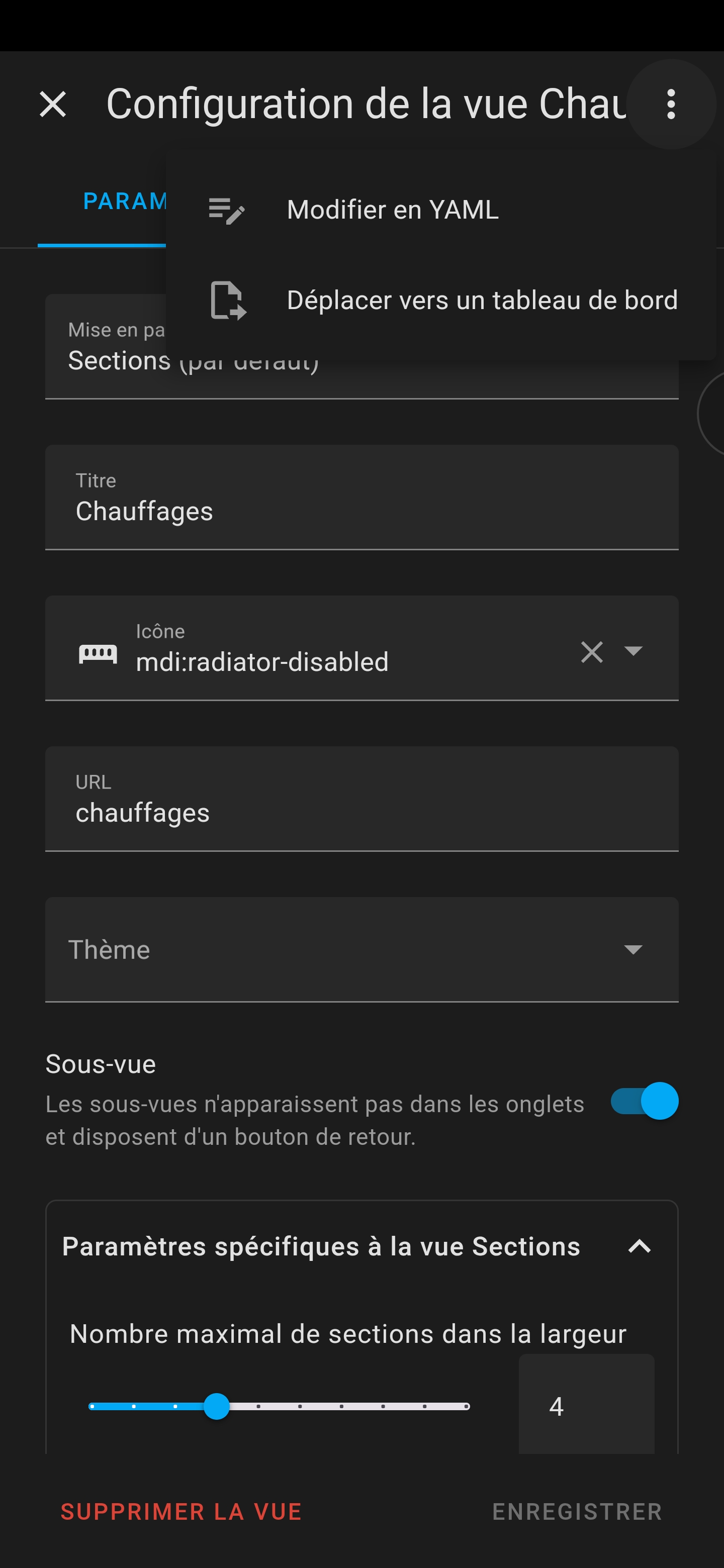

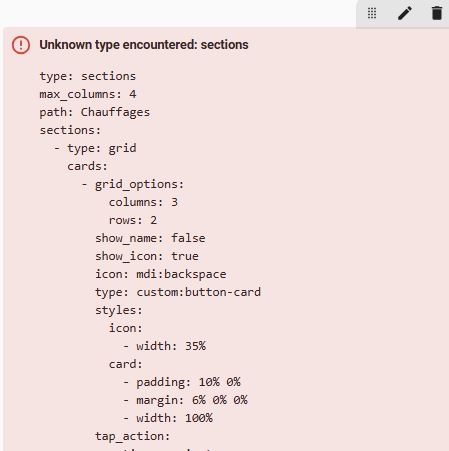

Bonjour, je possède un NS panel pro 120 et souhaite créer un dashboard dédié chauffage sur le modèle de ce que tu as fait .
Problème : le code type: sections me renvoie l’erreur « Unknown type encountered: sections »
je suis en version 2024.12.5

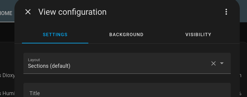

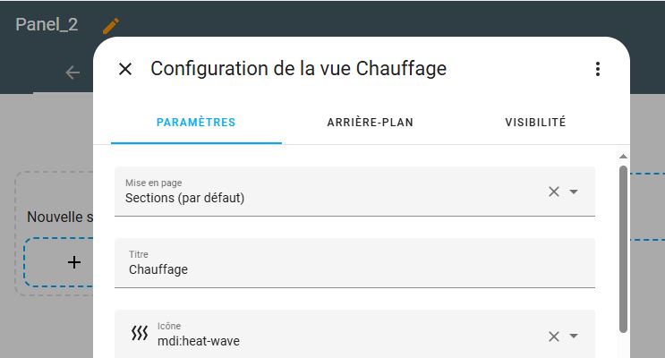

il faut créer ton dashboard avec le mode section, il est disponible depuis 2024.8 je crois
vérifies qu’il est bien en sections dans la configuration (layout) de ton dashboard
c’est bien le cas

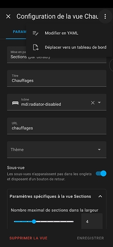

ou a tu copié le code? Il faut le copié dans la page de configuration de la vue, les 3points, modif yaml

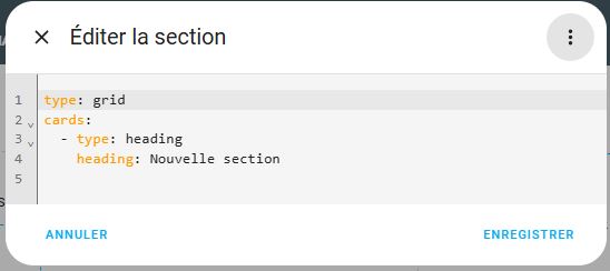

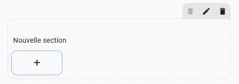

il me semble que je suis au bon endroit , ci-dessous où je copie le code
après « enregistrer » j’ai l’erreur
Non la tu est sur la section.
Après, tu choisis modifier en yaml
OK , compris
cela fonctionne,

Si tu veux tu peux modifier le menu
code
`type: custom:swipe-card
