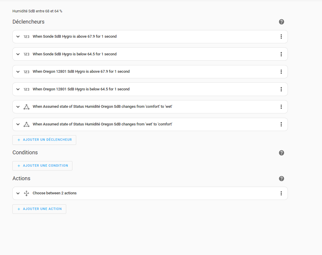

Il faut voir le trigger !
un exemple un peu plus compliqué chez moi, avec 2 sondes et une vérification du status !
Qui enclenche le déshumidificateur et sèche serviette si besoin ( chauffage)
automation SdB
le Yaml
alias: Humidité Salle de Bain
description: Humidité SdB entre 68 et 64 %
  - platform: numeric_state
    entity_id: sensor.thgn122_123_thgn132_thgr122_228_238_268_32_01_humidity
    for:
      hours: 0
      minutes: 0
      seconds: 1
    above: 67.9
    for:
      hours: 0
      minutes: 0
      seconds: 1
    below: 64.5
    entity_id: sensor.oregon_12801hygrometry
    above: 67.9
    for:
      hours: 0
      minutes: 0
      seconds: 1
    below: 64.5
    for:
      hours: 0
      minutes: 0
      seconds: 1
  - platform: state
    entity_id:
      - sensor.thgn122_123_thgn132_thgr122_228_238_268_32_01_humidity_status
    attribute: assumed_state
    from: comfort
    to: wet
    for:
      hours: 0
      minutes: 0
      seconds: 0
  - platform: state
    entity_id:
    from: wet
    to: comfort
    for:
      hours: 0
      minutes: 0
      seconds: 0
condition: []
  - choose:
      - conditions:
          - condition: or
            conditions:
              - condition: trigger
        sequence:
          - type: turn_on
            device_id: 885e6ab527e72840d6e835cf211f719f
            entity_id: switch.shellyswitch25_c45bbe792269_channel_1
            domain: switch
          - type: turn_on
            entity_id: switch.shellyswitch25_c45bbe792269_channel_2
            domain: switch
          - service: notify.mobile_app_m2012k11ag
              message: >-
                {{ states ("sensor.time") }} Humidité salle de bain {{ states
                ("sensor.oregon_12801hygrometry") }}
      - conditions:
          - condition: or
            conditions:
        sequence:
          - type: turn_off
            domain: switch
              message: >-
mode: restart
Merci, @Doubledom, j’ai fait un mix des vos 2 solutions avec le sensor et je pense que je tiens la solution parfaite :wink:
