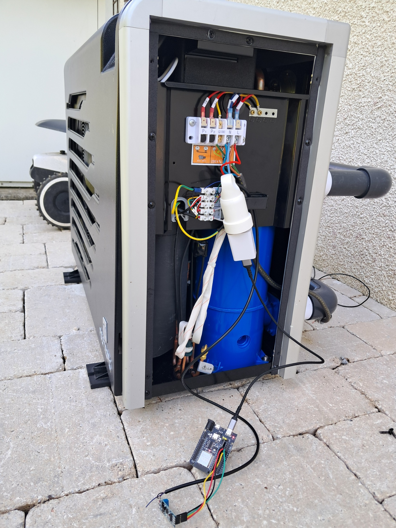

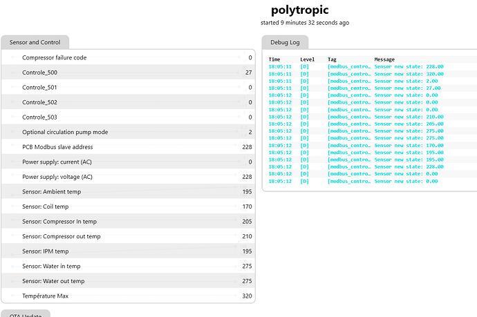

Integrer PAC Desjoyaux/Polytropic sous HA (Modbus)

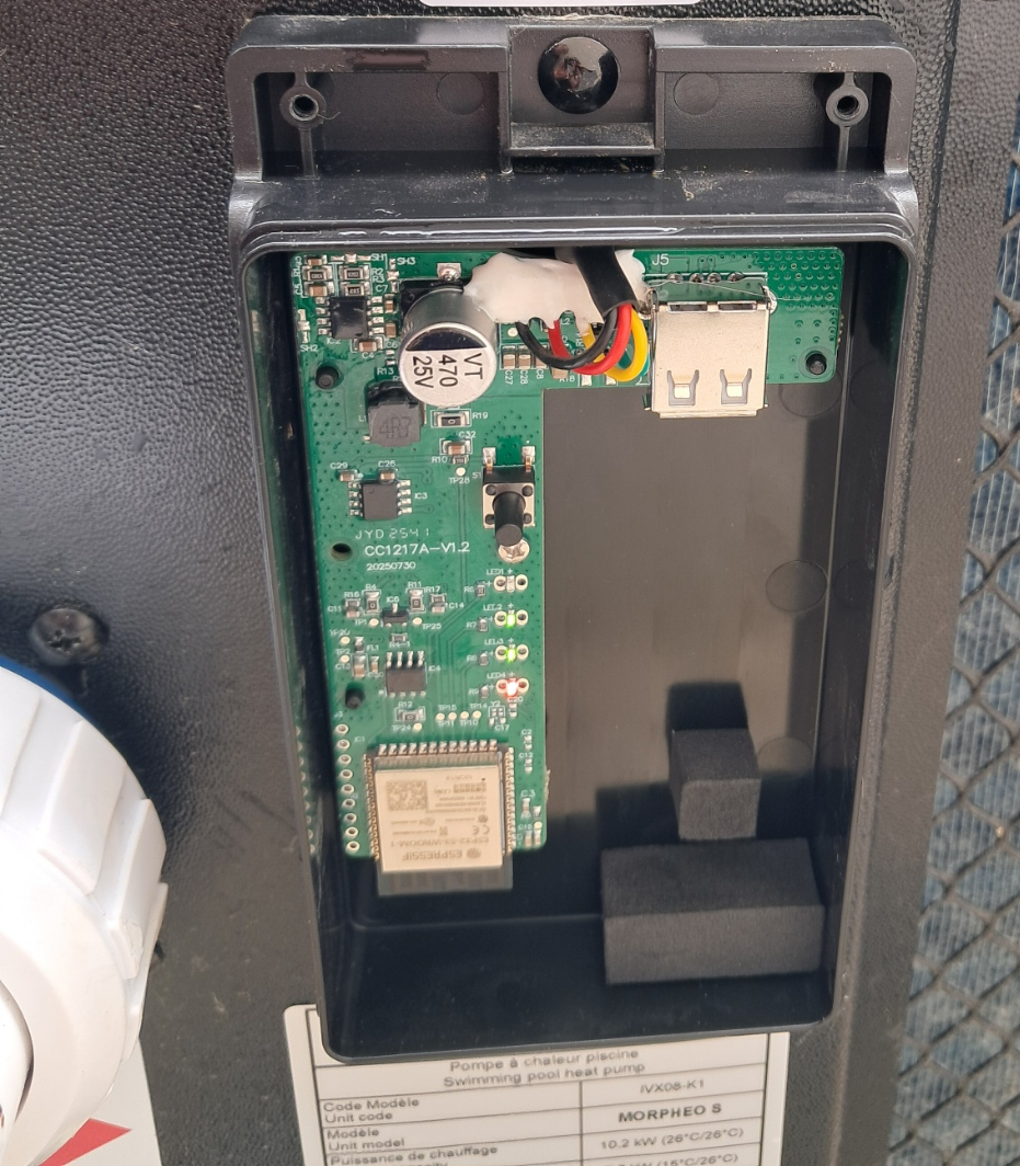

ca c’est mon module wifi, à l’arriere de la PàC
j’ai trouvé un connecteur à l’avant avec les mêmes couleurs, et quand le le débranche, le carte wifi s’éteint, et le bluetooth aussi.
par contre, ca n’accroche pas, j’envoie mais il n’y a pas de retour.

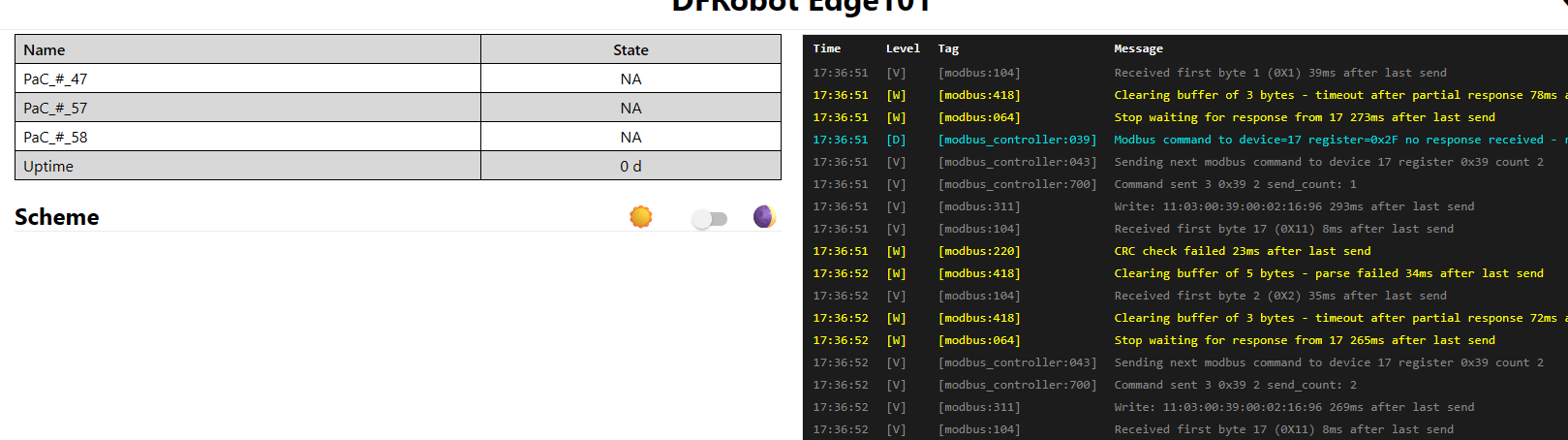

j’ai ca dans les logs:

[17:27:52.926][W][component:522]: api took a long time for an operation (177 ms), max is 30 ms
[17:27:52.926][I][app:154]: ESPHome version 2026.4.3 compiled on 2026-05-02 17:27:24 +0200
[17:27:52.926][I][app:161]: ESP32 Chip: ESP32 rev3.1, 2 core(s)
[17:27:52.938][W][app:174]: Chip rev >= 3.0 detected. Set minimum_chip_revision: "3.1" under esp32 > framework > advanced to reduce binary size
[17:27:52.959][W][app:201]: Bootloader supports SRAM1 as IRAM (+40KB). Set sram1_as_iram: true under esp32 > framework > advanced
[17:27:52.959][C][logger:219]: Logger:
[17:27:52.959][C][logger:219]:   Max Level: VERY_VERBOSE
[17:27:52.959][C][logger:219]:   Initial Level: VERY_VERBOSE
[17:27:52.959][C][logger:226]:   Log Baud Rate: 115200
[17:27:52.959][C][logger:226]:   Hardware UART: UART0
[17:27:52.971][C][logger:235]:   Task Log Buffer Size: 768 bytes
[17:27:53.004][W][logger:251]: VERY_VERBOSE logging is active — significant performance impact, short-term debugging only
[17:27:53.004][W][logger:251]:   May cause connection instability. Set log level to DEBUG or lower for long-term use.
[17:27:53.004][W][modbus:064]: Stop waiting for response from 17 328ms after last send
[17:27:53.004][V][modbus_controller:043]: Sending next modbus command to device 17 register 0x2F count 1
[17:27:53.007][V][modbus_controller:700]: Command sent 3 0x2F 1 send_count: 4

[17:27:53.335][V][modbus:311]: Write: 11:03:00:2F:00:01:B7:53 670ms after last send

[17:27:53.515][V][modbus:104]: Received first byte 17 (0X11) 179ms after last send
[17:27:53.518][VV][modbus:107]: Received byte 3 (0X3) 182ms after last send
[17:27:53.523][VV][modbus:107]: Received byte 0 (0X0) 187ms after last send
[17:27:53.526][VV][modbus:107]: Received byte 47 (0X2f) 190ms after last send
[17:27:53.534][VV][modbus:107]: Received byte 0 (0X0) 198ms after last send
[17:27:53.545][W][modbus:220]: CRC check failed 209ms after last send
[17:27:53.556][VV][modbus:224]:   (3521 != 2F) 11:03:00:2F:00
[17:27:53.559][W][modbus:418]: Clearing buffer of 5 bytes - parse failed 223ms after last send

[17:27:53.668][W][modbus:418]: Clearing buffer of 3 bytes - timeout after partial response 332ms after last send
[17:27:53.679][W][modbus:064]: Stop waiting for response from 17 343ms after last send
[17:27:53.690][V][modbus_controller:043]: Sending next modbus command to device 17 register 0x2F count 1
[17:27:53.701][V][modbus_controller:700]: Command sent 3 0x2F 1 send_count: 5

[17:27:53.757][V][modbus:311]: Write: 11:03:00:2F:00:01:B7:53 421ms after last send
[17:27:53.768][C][uptime.sensor:017]: Uptime Sensor 'Uptime'
[17:27:53.768][C][uptime.sensor:017]:   State Class: 'total_increasing'
[17:27:53.768][C][uptime.sensor:017]:   Unit of Measurement: 'd'
[17:27:53.768][C][uptime.sensor:017]:   Accuracy Decimals: 0
[17:27:53.778][C][uptime.sensor:232]:   Device Class: 'duration'
[17:27:53.790][C][uptime.sensor:223]:   Icon: 'mdi:timer-outline'
[17:27:53.792][C][uptime.sensor:019]:   Type: Seconds
[17:27:53.801][V][modbus:104]: Received first byte 17 (0X11) 33ms after last send
[17:27:53.812][VV][modbus:107]: Received byte 3 (0X3) 44ms after last send
[17:27:53.815][VV][modbus:107]: Received byte 0 (0X0) 46ms after last send
[17:27:53.824][VV][modbus:107]: Received byte 47 (0X2f) 55ms after last send
[17:27:53.827][VV][modbus:107]: Received byte 0 (0X0) 59ms after last send
[17:27:53.834][W][modbus:220]: CRC check failed 66ms after last send
[17:27:53.837][VV][modbus:224]:   (3521 != 2F) 11:03:00:2F:00
[17:27:53.846][W][modbus:418]: Clearing buffer of 5 bytes - parse failed 77ms after last send
[17:27:53.848][V][modbus:104]: Received first byte 1 (0X1) 81ms after last send
[17:27:53.856][VV][modbus:107]: Received byte 183 (0Xb7) 89ms after last send
[17:27:53.859][VV][modbus:107]: Received byte 83 (0X53) 90ms after last send

[17:27:54.082][W][modbus:064]: Stop waiting for response from 17 311ms after last send
[17:27:54.090][W][modbus_controller:027]: Modbus device=17 set offline
[17:27:54.093][D][modbus_controller:039]: Modbus command to device=17 register=0x2F no response received - removed from send queue

[17:27:54.137][V][modbus:311]: Write: 11:03:00:39:00:02:16:96 369ms after last send
[17:27:54.146][C][safe_mode:026]: Safe Mode:
[17:27:54.146][C][safe_mode:026]:   Successful after: 60s
[17:27:54.146][C][safe_mode:026]:   Invoke after: 10 attempts
[17:27:54.146][C][safe_mode:026]:   Duration: 300s
[17:27:54.156][C][safe_mode:043]:   Bootloader rollback: not supported
[17:27:54.162][V][modbus:104]: Received first byte 17 (0X11) 16ms after last send
[17:27:54.165][VV][modbus:107]: Received byte 3 (0X3) 20ms after last send
[17:27:54.169][VV][modbus:107]: Received byte 0 (0X0) 24ms after last send
[17:27:54.179][VV][modbus:107]: Received byte 57 (0X39) 34ms after last send
[17:27:54.182][VV][modbus:107]: Received byte 0 (0X0) 36ms after last send
[17:27:54.190][W][modbus:220]: CRC check failed 45ms after last send
[17:27:54.193][VV][modbus:224]:   (3521 != 39) 11:03:00:39:00
[17:27:54.201][W][modbus:418]: Clearing buffer of 5 bytes - parse failed 56ms after last send
[17:27:54.204][V][modbus:104]: Received first byte 2 (0X2) 58ms after last send
[17:27:54.212][VV][modbus:107]: Received byte 22 (0X16) 67ms after last send
[17:27:54.223][VV][modbus:107]: Received byte 150 (0X96) 78ms after last send
[17:27:54.227][C][api:235]: Server:
[17:27:54.227][C][api:235]:   Address: 192.168.1.39:6053
[17:27:54.227][C][api:235]:   Listen backlog: 4
[17:27:54.227][C][api:235]:   Max connections: 8
[17:27:54.245][C][api:242]:   Noise encryption: YES
[17:27:54.248][W][modbus:418]: Clearing buffer of 3 bytes - timeout after partial response 103ms after last send
[17:27:54.251][C][mdns:194]: mDNS:
[17:27:54.251][C][mdns:194]:   Hostname: edge101
[17:27:54.256][V][mdns:199]:   Services:
[17:27:54.259][V][mdns:201]:   - _esphomelib, _tcp, 6053
[17:27:54.261][V][mdns:204]:     TXT: friendly_name = DFRobot Edge101
[17:27:54.267][V][mdns:204]:     TXT: version = 2026.4.3
[17:27:54.278][V][mdns:204]:     TXT: mac = 80f3da6ae4d4
[17:27:54.281][V][mdns:204]:     TXT: platform = ESP32
[17:27:54.283][V][mdns:204]:     TXT: board = esp32dev
[17:27:54.289][V][mdns:204]:     TXT: network = ethernet
[17:27:54.292][V][mdns:204]:     TXT: api_encryption = Noise_NNpsk0_25519_ChaChaPoly_SHA256
[17:27:54.301][V][mdns:201]:   - _http, _tcp, 80
[17:27:54.416][W][modbus:064]: Stop waiting for response from 17 271ms after last send
[17:27:54.420][V][modbus_controller:043]: Sending next modbus command to device 17 register 0x39 count 2
[17:27:54.423][V][modbus_controller:700]: Command sent 3 0x39 2 send_count: 2
[17:27:54.426][V][modbus:311]: Write: 11:03:00:39:00:02:16:96 281ms after last send
[17:27:54.435][V][modbus:104]: Received first byte 17 (0X11) 7ms after last send
[17:27:54.438][VV][modbus:107]: Received byte 3 (0X3) 10ms after last send
[17:27:54.441][VV][modbus:107]: Received byte 0 (0X0) 12ms after last send
[17:27:54.444][VV][modbus:107]: Received byte 57 (0X39) 15ms after last send
[17:27:54.447][VV][modbus:107]: Received byte 0 (0X0) 18ms after last send
[17:27:54.450][W][modbus:220]: CRC check failed 21ms after last send
[17:27:54.452][VV][modbus:224]:   (3521 != 39) 11:03:00:39:00
[17:27:54.459][W][modbus:418]: Clearing buffer of 5 bytes - parse failed 31ms after last send
[17:27:54.462][V][modbus:104]: Received first byte 2 (0X2) 33ms after last send
[17:27:54.474][VV][modbus:107]: Received byte 22 (0X16) 42ms after last send
[17:27:54.475][VV][modbus:107]: Received byte 150 (0X96) 44ms after last send
[17:27:54.497][W][modbus:418]: Clearing buffer of 3 bytes - timeout after partial response 69ms after last send
[17:27:54.692][W][modbus:064]: Stop waiting for response from 17 263ms after last send
[17:27:54.695][V][modbus_controller:043]: Sending next modbus command to device 17 register 0x39 count 2
[17:27:54.698][V][modbus_controller:700]: Command sent 3 0x39 2 send_count: 3
[17:27:54.701][V][modbus:311]: Write: 11:03:00:39:00:02:16:96 273ms after last send
[17:27:54.710][V][modbus:104]: Received first byte 17 (0X11) 6ms after last send
[17:27:54.713][VV][modbus:107]: Received byte 3 (0X3) 8ms after last send
[17:27:54.716][VV][modbus:107]: Received byte 0 (0X0) 11ms after last send
[17:27:54.718][VV][modbus:107]: Received byte 57 (0X39) 13ms after last send
[17:27:54.723][VV][modbus:107]: Received byte 0 (0X0) 19ms after last send
[17:27:54.725][W][modbus:220]: CRC check failed 22ms after last send
[17:27:54.728][VV][modbus:224]:   (3521 != 39) 11:03:00:39:00
[17:27:54.734][W][modbus:418]: Clearing buffer of 5 bytes - parse failed 30ms after last send
[17:27:54.737][V][modbus:104]: Received first byte 2 (0X2) 32ms after last send
[17:27:54.745][VV][modbus:107]: Received byte 22 (0X16) 41ms after last send
[17:27:54.748][VV][modbus:107]: Received byte 150 (0X96) 43ms after last send
[17:27:54.774][W][modbus:418]: Clearing buffer of 3 bytes - timeout after partial response 69ms after last send
[17:27:54.967][W][modbus:064]: Stop waiting for response from 17 263ms after last send
[17:27:54.971][V][modbus_controller:043]: Sending next modbus command to device 17 register 0x39 count 2
[17:27:54.974][V][modbus_controller:700]: Command sent 3 0x39 2 send_count: 4
[17:27:54.977][V][modbus:311]: Write: 11:03:00:39:00:02:16:96 273ms after last send
[17:27:54.986][V][modbus:104]: Received first byte 17 (0X11) 6ms after last send
[17:27:54.989][VV][modbus:107]: Received byte 3 (0X3) 9ms after last send
[17:27:54.991][VV][modbus:107]: Received byte 0 (0X0) 12ms after last send
[17:27:54.994][VV][modbus:107]: Received byte 57 (0X39) 14ms after last send
[17:27:54.997][VV][modbus:107]: Received byte 0 (0X0) 17ms after last send
[17:27:55.000][W][modbus:220]: CRC check failed 20ms after last send
[17:27:55.008][VV][modbus:224]:   (3521 != 39) 11:03:00:39:00
[17:27:55.010][W][modbus:418]: Clearing buffer of 5 bytes - parse failed 31ms after last send
[17:27:55.013][V][modbus:104]: Received first byte 2 (0X2) 33ms after last send
[17:27:55.030][VV][modbus:107]: Received byte 22 (0X16) 50ms after last send
[17:27:55.033][VV][modbus:107]: Received byte 150 (0X96) 53ms after last send
[17:27:55.057][W][modbus:418]: Clearing buffer of 3 bytes - timeout after partial response 77ms after last send
[17:27:55.254][W][modbus:064]: Stop waiting for response from 17 274ms after last send
[17:27:55.258][V][modbus_controller:043]: Sending next modbus command to device 17 register 0x39 count 2
[17:27:55.261][V][modbus_controller:700]: Command sent 3 0x39 2 send_count: 5
[17:27:55.264][V][modbus:311]: Write: 11:03:00:39:00:02:16:96 284ms after last send
[17:27:55.273][V][modbus:104]: Received first byte 17 (0X11) 6ms after last send
[17:27:55.276][VV][modbus:107]: Received byte 3 (0X3) 9ms after last send
[17:27:55.279][VV][modbus:107]: Received byte 0 (0X0) 12ms after last send
[17:27:55.281][VV][modbus:107]: Received byte 57 (0X39) 15ms after last send
[17:27:55.286][VV][modbus:107]: Received byte 0 (0X0) 19ms after last send
[17:27:55.289][W][modbus:220]: CRC check failed 22ms after last send
[17:27:55.291][VV][modbus:224]:   (3521 != 39) 11:03:00:39:00
[17:27:55.297][W][modbus:418]: Clearing buffer of 5 bytes - parse failed 30ms after last send
[17:27:55.300][V][modbus:104]: Received first byte 2 (0X2) 33ms after last send
[17:27:55.308][VV][modbus:107]: Received byte 22 (0X16) 41ms after last send
[17:27:55.311][VV][modbus:107]: Received byte 150 (0X96) 43ms after last send
[17:27:55.336][W][modbus:418]: Clearing buffer of 3 bytes - timeout after partial response 69ms after last send
[17:27:55.533][W][modbus:064]: Stop waiting for response from 17 265ms after last send
[17:27:55.536][D][modbus_controller:039]: Modbus command to device=17 register=0x39 no response received - removed from send queue
[17:28:12.501][VV][app:471]: ethernet loop enabled from ISR
[17:28:12.505][VV][app:471]: logger loop enabled from ISR
[17:28:12.509][VV][component:292]: ethernet loop disabled
[17:28:12.511][VV][web_server_idf:219][httpd]: Enter AsyncWebServer::request_handler. method=1, uri=/
[17:28:12.514][VV][component:292]: logger loop disabled
[17:28:12.594][VV][app:471]: logger loop enabled from ISR
[17:28:12.599][VV][web_server_idf:219][httpd]: Enter AsyncWebServer::request_handler. method=1, uri=/events
[17:28:12.603][VV][app:471]: web_server loop enabled from ISR
[17:28:12.610][VV][component:292]: logger loop disabled
[17:28:32.823][VV][api.service:020]: on_ping_request: {}
[17:28:32.827][VV][api.service:013]: send_message ping_response: PingResponse {}
[17:28:33.288][VV][api.service:020]: on_ping_request: {}
[17:28:33.292][VV][api.service:013]: send_message ping_response: PingResponse {}
[17:28:48.279][I][safe_mode:091]: Boot seems successful; resetting boot loop counter
[17:28:48.283][VV][preferences:043]: s_pending_save: key: 233825507, len: 4
[17:28:48.342][VV][component:292]: safe_mode loop disabled
[17:28:48.345][W][component:522]: safe_mode took a long time for an operation (67 ms), max is 30 ms
[17:28:51.801][V][modbus_controller:354]: Updating modbus component
[17:28:51.805][VV][modbus_controller:358]: Updating range 0x2F
[17:28:51.808][V][modbus_controller:320]: Range : 2F Size: 1 (3) skip: 0
[17:28:51.812][VV][modbus_controller:358]: Updating range 0x39
[17:28:51.815][V][modbus_controller:320]: Range : 39 Size: 2 (3) skip: 0
[17:28:51.820][V][sensor:077]: 'Uptime': Received new state 63.680000
[17:28:51.824][VV][sensor.filter:023]: Filter(0x3ffb28fc)::input(63.680000)
[17:28:51.828][VV][sensor.filter:030]: Filter(0x3ffb28fc)::output(0.000737) -> SENSOR
[17:28:51.832][V][sensor:125]: 'Uptime' >> 0 d
[17:28:51.838][V][preferences:121]: Saving 1 items...
[17:28:51.842][VV][preferences:129]: Checking if NVS data 233825507 has changed
[17:28:51.852][V][preferences:132]: sync: key: 233825507, len: 4
[17:28:51.855][D][preferences:152]: Writing 1 items: 0 cached, 1 written, 0 failed
[17:28:51.859][V][modbus_controller:043]: Sending next modbus command to device 17 register 0x2F count 1
[17:28:51.863][V][modbus_controller:700]: Command sent 3 0x2F 1 send_count: 1
[17:28:51.867][V][modbus:311]: Write: 11:03:00:2F:00:01:B7:53 56599ms after last send
[17:28:51.876][V][modbus:104]: Received first byte 17 (0X11) 4ms after last send
[17:28:51.879][VV][modbus:107]: Received byte 3 (0X3) 7ms after last send
[17:28:51.883][VV][modbus:107]: Received byte 0 (0X0) 11ms after last send
[17:28:51.895][VV][modbus:107]: Received byte 47 (0X2f) 22ms after last send
[17:28:51.898][VV][modbus:107]: Received byte 0 (0X0) 27ms after last send
[17:28:51.905][W][modbus:220]: CRC check failed 33ms after last send
[17:28:51.908][VV][modbus:224]:   (3521 != 2F) 11:03:00:2F:00
[17:28:51.911][W][modbus:418]: Clearing buffer of 5 bytes - parse failed 40ms after last send
[17:28:51.927][V][modbus:104]: Received first byte 1 (0X1) 55ms after last send
[17:28:51.930][VV][modbus:107]: Received byte 183 (0Xb7) 59ms after last send
[17:28:51.938][VV][modbus:107]: Received byte 83 (0X53) 66ms after last send
[17:28:51.945][VV][api.service:013]: send_message sensor_state_response: SensorStateResponse {
[17:28:51.945][VV][api.service:013]:   key: 1324261225
[17:28:51.945][VV][api.service:013]:   state: 0.000737037
[17:28:51.945][VV][api.service:013]:   missing_state: NO
[17:28:51.945][VV][api.service:013]:  }
[17:28:51.952][VV][api.service:013]: send_message sensor_state_response: SensorStateResponse {
[17:28:51.952][VV][api.service:013]:   key: 1324261225
[17:28:51.952][VV][api.service:013]:   state: 0.000737037
[17:28:51.952][VV][api.service:013]:   missing_state: NO
[17:28:51.952][VV][api.service:013]:  }
[17:28:51.972][W][modbus:418]: Clearing buffer of 3 bytes - timeout after partial response 100ms after last send
[17:28:52.134][W][modbus:064]: Stop waiting for response from 17 262ms after last send
[17:28:52.138][V][modbus_controller:043]: Sending next modbus command to device 17 register 0x2F count 1
[17:28:52.142][V][modbus_controller:700]: Command sent 3 0x2F 1 send_count: 2
[17:28:52.146][V][modbus:311]: Write: 11:03:00:2F:00:01:B7:53 274ms after last send
[17:28:52.155][V][modbus:104]: Received first byte 17 (0X11) 7ms after last send
[17:28:52.158][VV][modbus:107]: Received byte 3 (0X3) 11ms after last send
[17:28:52.161][VV][modbus:107]: Received byte 0 (0X0) 14ms after last send
[17:28:52.165][VV][modbus:107]: Received byte 47 (0X2f) 17ms after last send
[17:28:52.168][VV][modbus:107]: Received byte 0 (0X0) 21ms after last send
[17:28:52.171][W][modbus:220]: CRC check failed 24ms after last send
[17:28:52.175][VV][modbus:224]:   (3521 != 2F) 11:03:00:2F:00
[17:28:52.178][W][modbus:418]: Clearing buffer of 5 bytes - parse failed 31ms after last send
[17:28:52.182][V][modbus:104]: Received first byte 1 (0X1) 34ms after last send
[17:28:52.187][VV][modbus:107]: Received byte 183 (0Xb7) 39ms after last send
[17:28:52.197][VV][modbus:107]: Received byte 83 (0X53) 50ms after last send
[17:28:52.225][W][modbus:418]: Clearing buffer of 3 bytes - timeout after partial response 77ms after last send
[17:28:52.422][W][modbus:064]: Stop waiting for response from 17 274ms after last send
[17:28:52.426][V][modbus_controller:043]: Sending next modbus command to device 17 register 0x2F count 1
[17:28:52.429][V][modbus_controller:700]: Command sent 3 0x2F 1 send_count: 3
[17:28:52.433][V][modbus:311]: Write: 11:03:00:2F:00:01:B7:53 286ms after last send
[17:28:52.442][V][modbus:104]: Received first byte 17 (0X11) 5ms after last send
[17:28:52.445][VV][modbus:107]: Received byte 3 (0X3) 9ms after last send
[17:28:52.449][VV][modbus:107]: Received byte 0 (0X0) 12ms after last send
[17:28:52.452][VV][modbus:107]: Received byte 47 (0X2f) 16ms after last send
[17:28:52.455][VV][modbus:107]: Received byte 0 (0X0) 19ms after last send
[17:28:52.459][W][modbus:220]: CRC check failed 22ms after last send
[17:28:52.463][VV][modbus:224]:   (3521 != 2F) 11:03:00:2F:00
[17:28:52.467][W][modbus:418]: Clearing buffer of 5 bytes - parse failed 29ms after last send
[17:28:52.470][V][modbus:104]: Received first byte 1 (0X1) 34ms after last send
[17:28:52.485][VV][modbus:107]: Received byte 183 (0Xb7) 49ms after last send
[17:28:52.489][VV][modbus:107]: Received byte 83 (0X53) 51ms after last send
[17:28:52.512][W][modbus:418]: Clearing buffer of 3 bytes - timeout after partial response 76ms after last send
[17:28:52.710][W][modbus:064]: Stop waiting for response from 17 273ms after last send
[17:28:52.714][V][modbus_controller:043]: Sending next modbus command to device 17 register 0x2F count 1
[17:28:52.718][V][modbus_controller:700]: Command sent 3 0x2F 1 send_count: 4
[17:28:52.723][V][modbus:311]: Write: 11:03:00:2F:00:01:B7:53 285ms after last send
[17:28:52.731][V][modbus:104]: Received first byte 17 (0X11) 6ms after last send
[17:28:52.734][VV][modbus:107]: Received byte 3 (0X3) 10ms after last send
[17:28:52.737][VV][modbus:107]: Received byte 0 (0X0) 13ms after last send
[17:28:52.741][VV][modbus:107]: Received byte 47 (0X2f) 16ms after last send
[17:28:52.745][VV][modbus:107]: Received byte 0 (0X0) 20ms after last send
[17:28:52.748][W][modbus:220]: CRC check failed 24ms after last send
[17:28:52.752][VV][modbus:224]:   (3521 != 2F) 11:03:00:2F:00
[17:28:52.756][W][modbus:418]: Clearing buffer of 5 bytes - parse failed 31ms after last send
[17:28:52.760][V][modbus:104]: Received first byte 1 (0X1) 33ms after last send
[17:28:52.764][VV][modbus:107]: Received byte 183 (0Xb7) 39ms after last send
[17:28:52.773][VV][modbus:107]: Received byte 83 (0X53) 49ms after last send
[17:28:52.794][W][modbus:418]: Clearing buffer of 3 bytes - timeout after partial response 69ms after last send
[17:28:52.992][W][modbus:064]: Stop waiting for response from 17 266ms after last send
[17:28:52.995][V][modbus_controller:043]: Sending next modbus command to device 17 register 0x2F count 1
[17:28:52.999][V][modbus_controller:700]: Command sent 3 0x2F 1 send_count: 5
[17:28:53.003][V][modbus:311]: Write: 11:03:00:2F:00:01:B7:53 278ms after last send
[17:28:53.011][V][modbus:104]: Received first byte 17 (0X11) 5ms after last send
[17:28:53.016][VV][modbus:107]: Received byte 3 (0X3) 9ms after last send
[17:28:53.018][VV][modbus:107]: Received byte 0 (0X0) 11ms after last send
[17:28:53.021][VV][modbus:107]: Received byte 47 (0X2f) 15ms after last send
[17:28:53.025][VV][modbus:107]: Received byte 0 (0X0) 18ms after last send
[17:28:53.028][W][modbus:220]: CRC check failed 22ms after last send
[17:28:53.032][VV][modbus:224]:   (3521 != 2F) 11:03:00:2F:00
[17:28:53.035][W][modbus:418]: Clearing buffer of 5 bytes - parse failed 28ms after last send
[17:28:53.040][V][modbus:104]: Received first byte 1 (0X1) 32ms after last send
[17:28:53.043][VV][modbus:107]: Received byte 183 (0Xb7) 37ms after last send
[17:28:53.055][VV][modbus:107]: Received byte 83 (0X53) 48ms after last send
[17:28:53.075][W][modbus:418]: Clearing buffer of 3 bytes - timeout after partial response 68ms after last send
[17:28:53.274][W][modbus:064]: Stop waiting for response from 17 266ms after last send
[17:28:53.277][D][modbus_controller:039]: Modbus command to device=17 register=0x2F no response received - removed from send queue
[17:28:53.281][V][modbus_controller:043]: Sending next modbus command to device 17 register 0x39 count 2
[17:28:53.285][V][modbus_controller:700]: Command sent 3 0x39 2 send_count: 1
[17:28:53.297][V][modbus:311]: Write: 11:03:00:39:00:02:16:96 291ms after last send
[17:28:53.306][V][modbus:104]: Received first byte 17 (0X11) 6ms after last send
[17:28:53.309][VV][modbus:107]: Received byte 3 (0X3) 10ms after last send
[17:28:53.312][VV][modbus:107]: Received byte 0 (0X0) 13ms after last send
[17:28:53.316][VV][modbus:107]: Received byte 57 (0X39) 16ms after last send
[17:28:53.320][VV][modbus:107]: Received byte 0 (0X0) 20ms after last send
[17:28:53.323][W][modbus:220]: CRC check failed 24ms after last send
[17:28:53.328][VV][modbus:224]:   (3521 != 39) 11:03:00:39:00
[17:28:53.331][W][modbus:418]: Clearing buffer of 5 bytes - parse failed 30ms after last send
[17:28:53.334][V][modbus:104]: Received first byte 2 (0X2) 35ms after last send
[17:28:53.339][VV][modbus:107]: Received byte 22 (0X16) 39ms after last send
[17:28:53.342][VV][modbus:107]: Received byte 150 (0X96) 43ms after last send
[17:28:53.368][W][modbus:418]: Clearing buffer of 3 bytes - timeout after partial response 68ms after last send
[17:28:53.566][W][modbus:064]: Stop waiting for response from 17 265ms after last send
[17:28:53.569][V][modbus_controller:043]: Sending next modbus command to device 17 register 0x39 count 2
[17:28:53.573][V][modbus_controller:700]: Command sent 3 0x39 2 send_count: 2
[17:28:53.577][V][modbus:311]: Write: 11:03:00:39:00:02:16:96 277ms after last send
[17:28:53.586][V][modbus:104]: Received first byte 17 (0X11) 6ms after last send
[17:28:53.589][VV][modbus:107]: Received byte 3 (0X3) 10ms after last send
[17:28:53.592][VV][modbus:107]: Received byte 0 (0X0) 13ms after last send
[17:28:53.596][VV][modbus:107]: Received byte 57 (0X39) 16ms after last send
[17:28:53.599][VV][modbus:107]: Received byte 0 (0X0) 20ms after last send
[17:28:53.602][W][modbus:220]: CRC check failed 23ms after last send
[17:28:53.606][VV][modbus:224]:   (3521 != 39) 11:03:00:39:00
[17:28:53.609][W][modbus:418]: Clearing buffer of 5 bytes - parse failed 30ms after last send
[17:28:53.614][V][modbus:104]: Received first byte 2 (0X2) 33ms after last send
[17:28:53.618][VV][modbus:107]: Received byte 22 (0X16) 38ms after last send
[17:28:53.628][VV][modbus:107]: Received byte 150 (0X96) 49ms after last send
[17:28:53.649][W][modbus:418]: Clearing buffer of 3 bytes - timeout after partial response 69ms after last send
[17:28:53.848][W][modbus:064]: Stop waiting for response from 17 267ms after last send
[17:28:53.851][V][modbus_controller:043]: Sending next modbus command to device 17 register 0x39 count 2
[17:28:53.855][V][modbus_controller:700]: Command sent 3 0x39 2 send_count: 3
[17:28:53.859][V][modbus:311]: Write: 11:03:00:39:00:02:16:96 279ms after last send
[17:28:53.867][V][modbus:104]: Received first byte 17 (0X11) 6ms after last send
[17:28:53.871][VV][modbus:107]: Received byte 3 (0X3) 10ms after last send
[17:28:53.874][VV][modbus:107]: Received byte 0 (0X0) 13ms after last send
[17:28:53.878][VV][modbus:107]: Received byte 57 (0X39) 16ms after last send
[17:28:53.881][VV][modbus:107]: Received byte 0 (0X0) 19ms after last send
[17:28:53.884][W][modbus:220]: CRC check failed 23ms after last send
[17:28:53.889][VV][modbus:224]:   (3521 != 39) 11:03:00:39:00
[17:28:53.892][W][modbus:418]: Clearing buffer of 5 bytes - parse failed 31ms after last send
[17:28:53.896][V][modbus:104]: Received first byte 2 (0X2) 34ms after last send
[17:28:53.899][VV][modbus:107]: Received byte 22 (0X16) 38ms after last send
[17:28:53.911][VV][modbus:107]: Received byte 150 (0X96) 49ms after last send
[17:28:53.931][W][modbus:418]: Clearing buffer of 3 bytes - timeout after partial response 69ms after last send
[17:28:54.130][W][modbus:064]: Stop waiting for response from 17 267ms after last send
[17:28:54.133][V][modbus_controller:043]: Sending next modbus command to device 17 register 0x39 count 2
[17:28:54.137][V][modbus_controller:700]: Command sent 3 0x39 2 send_count: 4
[17:28:54.141][V][modbus:311]: Write: 11:03:00:39:00:02:16:96 279ms after last send
[17:28:54.150][V][modbus:104]: Received first byte 17 (0X11) 6ms after last send
[17:28:54.153][VV][modbus:107]: Received byte 3 (0X3) 8ms after last send
[17:28:54.156][VV][modbus:107]: Received byte 0 (0X0) 12ms after last send
[17:28:54.160][VV][modbus:107]: Received byte 57 (0X39) 15ms after last send
[17:28:54.163][VV][modbus:107]: Received byte 0 (0X0) 18ms after last send
[17:28:54.166][W][modbus:220]: CRC check failed 22ms after last send
[17:28:54.170][VV][modbus:224]:   (3521 != 39) 11:03:00:39:00
[17:28:54.173][W][modbus:418]: Clearing buffer of 5 bytes - parse failed 30ms after last send
[17:28:54.178][V][modbus:104]: Received first byte 2 (0X2) 32ms after last send
[17:28:54.182][VV][modbus:107]: Received byte 22 (0X16) 38ms after last send
[17:28:54.193][VV][modbus:107]: Received byte 150 (0X96) 49ms after last send
[17:28:54.213][W][modbus:418]: Clearing buffer of 3 bytes - timeout after partial response 69ms after last send
[17:28:54.412][W][modbus:064]: Stop waiting for response from 17 267ms after last send
[17:28:54.418][V][modbus_controller:043]: Sending next modbus command to device 17 register 0x39 count 2
[17:28:54.420][V][modbus_controller:700]: Command sent 3 0x39 2 send_count: 5
[17:28:54.422][V][modbus:311]: Write: 11:03:00:39:00:02:16:96 276ms after last send
[17:28:54.428][V][modbus:104]: Received first byte 17 (0X11) 3ms after last send
[17:28:54.432][VV][modbus:107]: Received byte 3 (0X3) 6ms after last send
[17:28:54.435][VV][modbus:107]: Received byte 0 (0X0) 10ms after last send
[17:28:54.438][VV][modbus:107]: Received byte 57 (0X39) 13ms after last send
[17:28:54.443][VV][modbus:107]: Received byte 0 (0X0) 18ms after last send
[17:28:54.447][W][modbus:220]: CRC check failed 21ms after last send
[17:28:54.455][VV][modbus:224]:   (3521 != 39) 11:03:00:39:00
[17:28:54.458][W][modbus:418]: Clearing buffer of 5 bytes - parse failed 33ms after last send
[17:28:54.463][V][modbus:104]: Received first byte 2 (0X2) 36ms after last send
[17:28:54.467][VV][modbus:107]: Received byte 22 (0X16) 41ms after last send
[17:28:54.477][VV][modbus:107]: Received byte 150 (0X96) 51ms after last send
[17:28:54.497][W][modbus:418]: Clearing buffer of 3 bytes - timeout after partial response 71ms after last send
[17:28:54.687][W][modbus:064]: Stop waiting for response from 17 261ms after last send
[17:28:54.690][D][modbus_controller:039]: Modbus command to device=17 register=0x39 no response received - removed from send queue

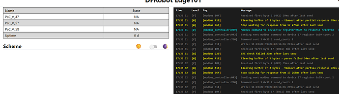

la je suis avec un hw-519, je vois passer des données mais les entités ne remontent pas:
J’ai aussi regardé tes logs — il y a un truc intéressant. Tu envoies :
11 03 00 2F 00 01 B7 53
et tu reçois en retour : d’abord 11 03 00 2F 00 (CRC fail), puis après une courte pause 01 B7 53. C’est exactement ta propre trame — à mon avis la PAC ne répond pas, tu entends ton propre écho sur le bus.
La cause la plus probable : DE et RE sur VCC, ton MAX485 émet en permanence et ne peut pas recevoir. À mon sens la solution la plus simple et la plus fiable, c’est de prendre un module avec gestion automatique du sens, comme l’ATOM Lite + Tail485 que j’utilise. ~20 €, ça fonctionne tout de suite avec ESPHome, sans bricolage de GPIO. Si tu veux absolument garder ton Edge101 (Ethernet, c’est sympa), un module RS485 générique avec auto-direction (XY-K485 ou similaire) résout aussi le problème.
Si ça ne suffit pas : A/B inversés ou terminaison 120 Ω manquante peuvent donner des symptômes similaires, mais c’est moins probable.
Une chose encore — je suis allé jeter un œil à la doc de ton Edge101, et j’ai vu que la carte a un port RS485 isolé intégré. Tu l’utilises, ou tu as branché le HW-519 en plus en externe ? Si c’est en externe : pourquoi ne pas plutôt utiliser le port intégré ? Il a déjà la gestion automatique du sens. Tu peux décrire ton setup en détail ? J’ai du mal à voir d’après le log quelles broches tu utilises exactement.
les 120 ohms branchés ou pas, inversion A B et BA, c’est déja fait.
y’a pas de DE et RE sur mon montage HW-519
donne moi des references HW de ce qui marche.
j’ai testé ces deux configs:
uart:
  • id: uart_RS485
    tx_pin: GPIO17 # vers RO (RX)
    rx_pin: GPIO36 # vers DI (TX)
    baud_rate: 9600
    stop_bits: 1
    parity: NONE
et
uart:
  • id: uart_ext
    rx_pin: GPIO14
    tx_pin: GPIO15
    baud_rate: 9600
    stop_bits: 1
    parity: NONE
avec le module hw-machin connecté sur les gpio externes
donc, je veux d’abord un hardware qui marche, apres j’adapterai.
le probleme est que m’sieur polytropic ne donne pas les docs techniques disant où exactement débrancher le bouzin. d’un autre coté, ca se comprend, ils perdent les relevés en temps réel des machines en clientelle…
Une chose me frappe : si tu vois le même comportement d’écho avec le RS485 intégré de l’Edge101 ET avec le HW-519 externe, alors le problème ne vient probablement pas du matériel, mais de quelque chose que les deux setups ont en commun — donc le câblage vers la PAC ou la PAC elle-même.
Deux questions :

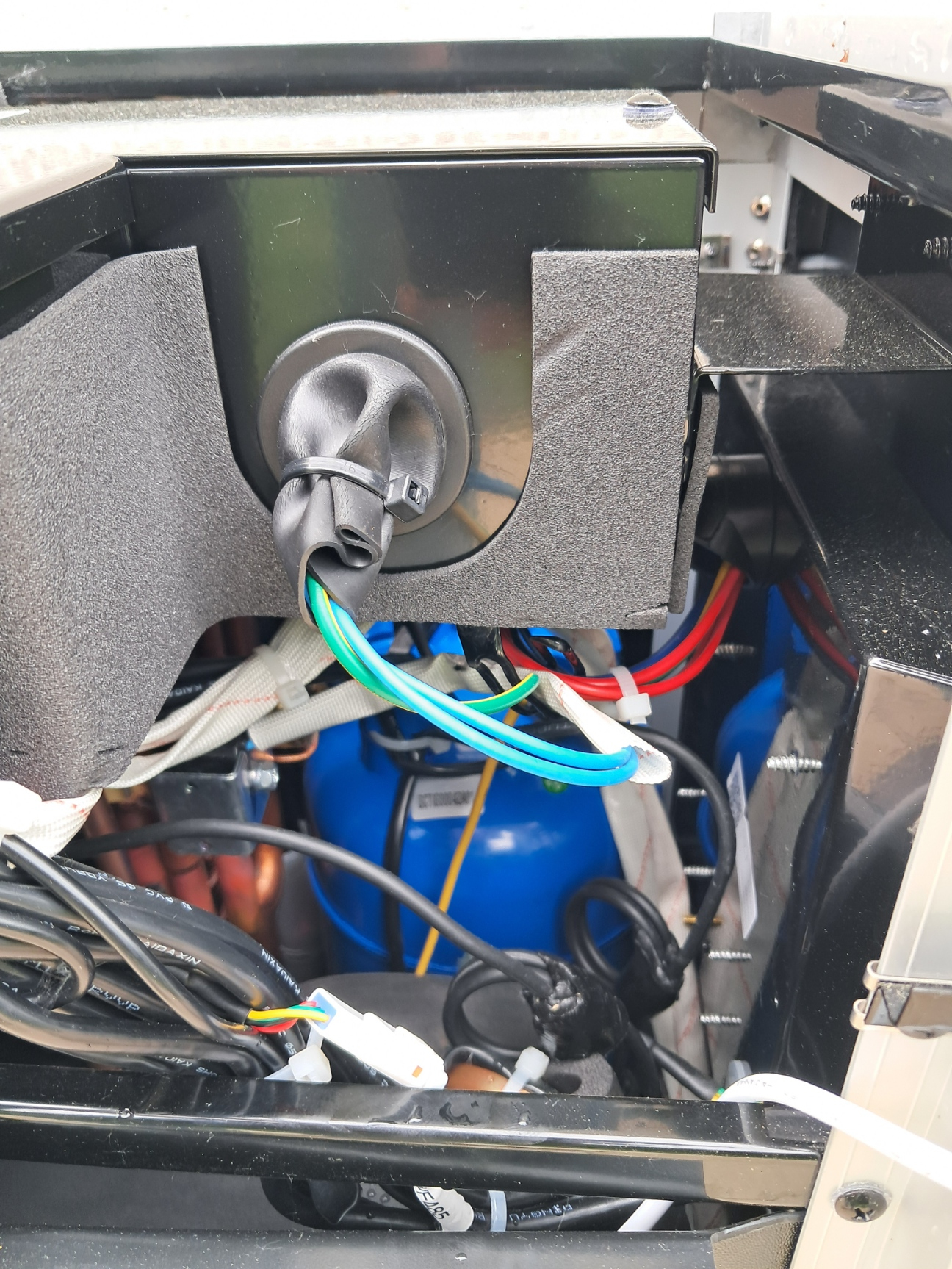

  1. Comment exactement es-tu connecté à la PAC ? Sur le bornier RS485 de Polytropic, il y a trois bornes : A, B et GND. Est-ce que tu as aussi raccordé GND ? Sans masse commune entre l’ESP et la PAC, le RS485 peut produire exactement ce comportement d’écho — et ça expliquerait pourquoi tu vois la même chose avec les deux variantes de matériel. Si tu as une photo du raccordement, ça aiderait.
  2. Est-ce que tu as fini par recevoir la table Modbus de Poly pour ta Morpheo Inverter S ? Tu avais écrit il y a quelques semaines que tu n’avais pas eu de réponse. Poly avait précisé que chaque modèle a sa propre table — l’adresse esclave, les registres et peut-être même la vitesse pourraient être différents sur ta Morpheo S par rapport aux valeurs qui circulent dans le forum pour d’autres modèles.
Pour la question matérielle : chez moi, le M5Stack ATOM Lite + Tail485 tourne nickel depuis quelques jours (~20 € l’ensemble). Auto-direction, DC/DC intégré pour l’alimentation 12 V du bus, fonctionne tout de suite avec ESPHome. Attention quand même — si le problème vient par exemple du point 1 ou du point 2 ci-dessus, du nouveau matériel ne résoudra rien. D’abord clarifier le câblage et la table, ensuite éventuellement changer de matériel.
Oui, j’ai bien la table Modbus officielle fournie par Polytropic.
par contre, non je n’ai pas relié le gnd, il va falloir que je reprenne mon cablage.
Très bien — la masse manquante pourrait bien expliquer le comportement que tu vois. Tiens-moi au courant après le re-câblage, je suis curieux de savoir si ça résout le problème.

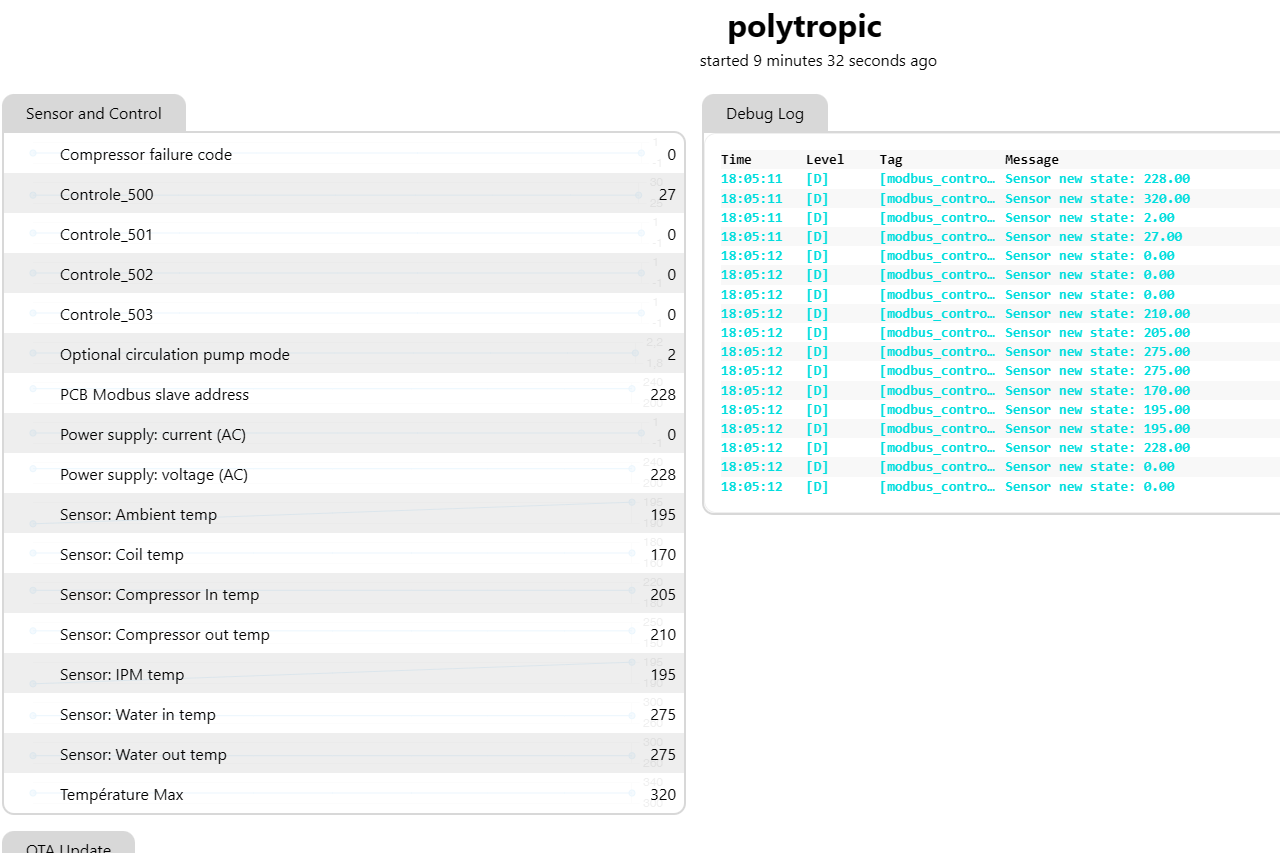

alors, avec des fils de 20cm et la masse, Ca tourne:
je sais pas encore décoder les 16 binary sensors sur 2 octets, mais ca va venir…
faudra trouver une alim plus petite, voire un +5V ou un +12V…
j’ai juste débranché un connecteur celui qu’on voit en bas au centre.
mais, plus de connexion wifi (et pas de Bluetooth)

Pour le BT/WiFi : oui, c’est perdu dès que tu débranches le connecteur — pareil chez moi. Du coup l’idée du proxy Bluetooth que tu avais au départ tombe à l’eau.
Pour l’alim, je vais me brancher sur le 12v qui alimentait le boitier wifi ca sera plus simple.

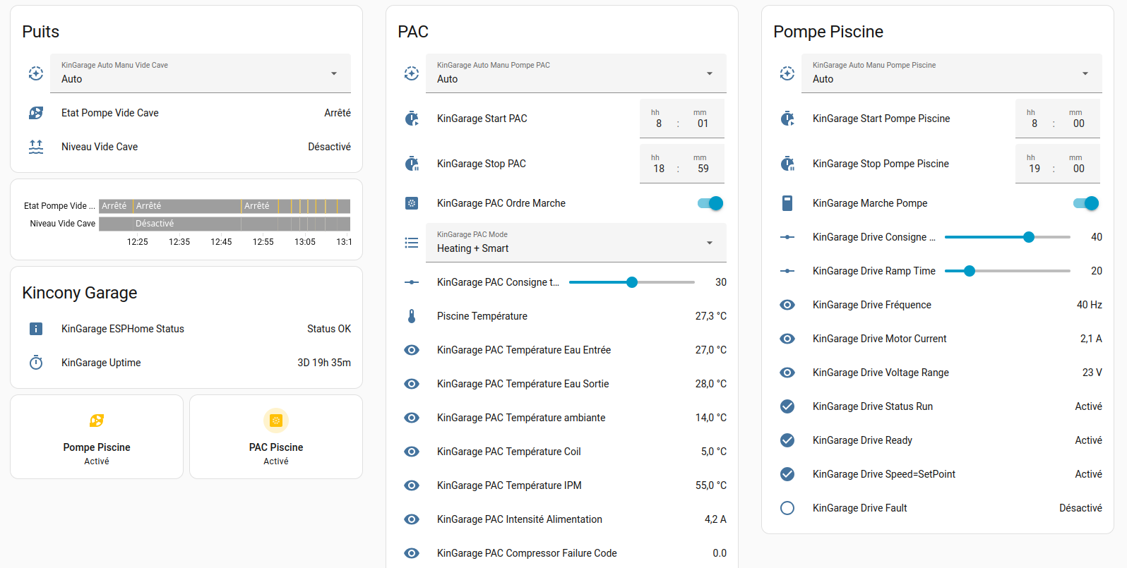

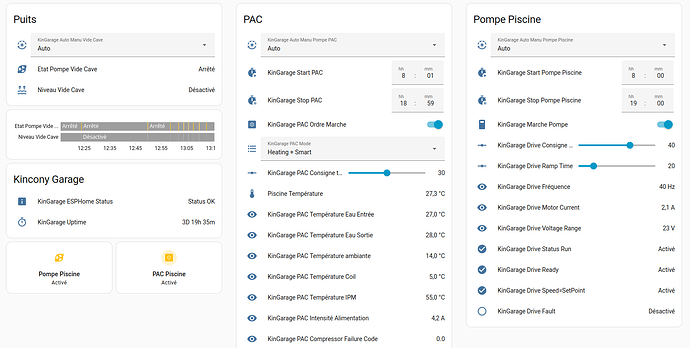

pour les binary sensor, j’ai suivi la doc esphome, pour le moment c’est que de la lecture…
- platform: modbus_controller
  modbus_controller_id: modbus_controller_1
  name: High pressure switch status
  register_type: read
  address: 500
  bitmask: 0x1
  name: Low pressure switch status
  register_type: read
  address: 500
  bitmask: 0x2
  name: Water flow switch status
  register_type: read
  address: 500
  bitmask: 0x8
j’ai pas trop pigé les différences entre holding, read, coil, custom…

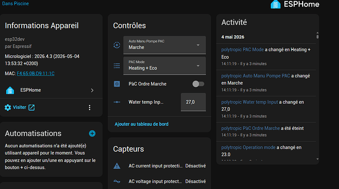

et faut que je trouve comment rentrer une valeur de température
Joliment résolu avec bitmask directement dans le modbus_controller — plus élégant que la voie lambda que j’avais montrée. Je vais m’y pencher aussi.
Pour les types de registres : à ma connaissance, chez Polytropic tous les registres avec lesquels on travaille sont du type holding (lisibles et inscriptibles, 16 bits). Que ça fonctionne aussi chez toi avec read, c’est bon à savoir — je pense donc qu’il nous suffit d’utiliser holding. Les coil seraient des bits individuels directement adressables, mais Polytropic n’utilise pas ça. custom est pour des implémentations propres.
Pour écrire une température : il y a la plateforme number dans le modbus_controller. Chez moi ça ressemble à ça :
number:
    modbus_controller_id: poly
    name: "Polytropic Soll-Temperatur Stellwert"
    address: 1001
    value_type: U_WORD
    register_type: holding
    min_value: 20
    max_value: 35
    step: 0.5
    multiply: 10
    mode: box
Le registre 1001 est chez Polytropic la consigne de température d’eau. La valeur est stockée en dixièmes de degré (28.5°C = 285), d’où le multiply: 10 — tu saisis « 28.5 » dans HA, ESPHome écrit 285 dans le registre.
Nickel pour l’input de la consigne. ca marche au poil.

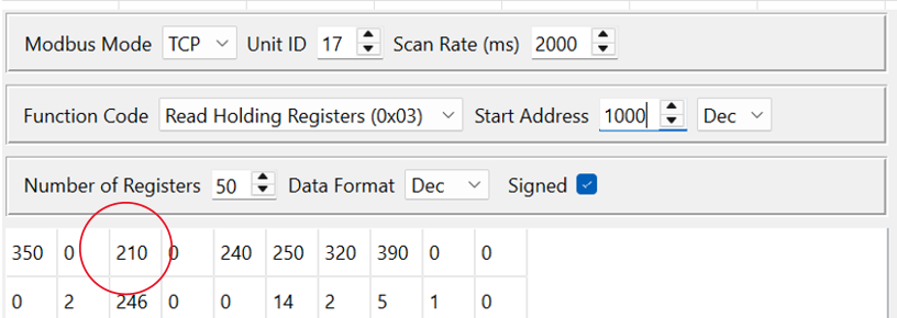

Update : session d’écoute passive sur le bus Modbus
J’ai écouté passivement aujourd’hui le bus RS485 sur ma Polytropic Master Inverter L Tri (IVS18T-K0), pour mieux comprendre ce qui se passe sur le bus externe quand on manipule le panneau.
Configuration matérielle de la PAC :
  • Carte réseau (PolyConnect Gateway) débranchée du CN16
  • Sur le CN16 ainsi libéré, le bornier externe (A, B, GND) est raccordé
  • Sur le CN17 est branché le panneau de commande
  • CN16 et CN17 sont mécaniquement identiques (même connecteur, même brochage)
Dispositif de mesure :
  • Adaptateur USB-RS485 (DSD TECH SH-U11GL, FTDI, isolé) en parallèle du bornier externe
  • Trois fils (A, B, GND), écoute pure sans émission propre
  • Sniffer Python avec détection de trames Modbus RTU, 9600/8N1
  • Mon maître ESPHome (ATOM Lite + Tail485) est resté actif et a continué à interroger normalement
Observations sur environ 11 minutes d’enregistrement :
  1. Le polling de l’ATOM est bien visible — Reg 500/510/521/1000/1001 toutes les 30 secondes
  2. Bouton Off pressé sur le panneau — aucune trame d’écriture visible sur le bus
  3. Bouton On repressé sur le panneau — aucune trame d’écriture visible sur le bus
  4. Consigne de température modifiée sur le panneau de 21°C à 16°C — aucune trame d’écriture visible sur le bus
  5. Quelques secondes plus tard, au cycle de polling suivant : Reg 1001 a la nouvelle valeur (210 → 160)
Je ne peux pas en déduire directement comment le panneau communique exactement en interne avec la carte principale — seulement que les écritures du panneau n’apparaissent pas sur le bus externe que j’observe.
Le Reg 1000 reste chez moi non-inscriptible via l’interface externe — timeout avec FC6, FC16 et multi-registres, toutes les tentatives reproduites plusieurs fois. Mail à Polytropic concernant le Reg 1000 envoyé, réponse en attente.
Si quelqu’un a d’autres observations — notamment si quelqu’un a déjà réussi à écrire dans le Reg 1000, ou des indices concernant le CN17 — je suis très preneur.

Voici mon fichier Esphome pour ma PAC POLYTROPIC MORPHEO XXS.
C’est installé sur un B8M Kincony.
Je gère aussi dans cette configuration un variateur de vitesse EATRON (RS485) pour ma pompe de piscine, un onduleur DEYE(RS485), un pompe vide cave pour mon puits de décompression piscine, une électrovanne pour arrosage.
il faut donc faire le tri dans mon fichier pour ne garder que la partie PAC POLYTROPIC.
Ce n’est pas parfait mais si cela peut aider…
il me reste encore à remonter les codes d’erreurs de la PAC lorsque je trouverai un peu de temps.
Attention, les adresses Modbus correspondent à ma PAC : il faut demander votre table modbus à POLYTROPIC en fonction de votre modèle et de votre N° de série.
    modbus_controller_id: polytropic_modbus_device
    name: "PAC Température Eau Entrée"
    address: 512
    unit_of_measurement: "°C"
    accuracy_decimals: 1
    value_type: U_WORD
      - multiply: 0.1
    name: "PAC Température Eau Sortie"
    address: 513
    value_type: U_WORD
      - multiply: 0.1
    name: "PAC Température Coil"
    address: 514
    value_type: S_WORD
      - multiply: 0.1
    name: "PAC Température ambiante"
    address: 515
    value_type: U_WORD
      - multiply: 0.1
    name: "PAC Température IPM"
    address: 516
    value_type: U_WORD
      - multiply: 0.1
    name: "PAC Tension Alimentation"
    address: 521
    unit_of_measurement: "V"
    value_type: U_WORD
    name: "PAC Intensité Alimentation"
    address: 522
    unit_of_measurement: "A"
    value_type: U_WORD
      - multiply: 0.1
    name: "PAC Compressor Failure Code"
    address: 523
    #unit_of_measurement: "A"
    value_type: U_WORD
    name: "PAC Puissance"
    unit_of_measurement: "W"
    icon: mdi:meter-electric-outline
    update_interval: 2s
      return id(deye_grid_voltage).state*id(polytropic_power_current).state;

Ma page Home Assistant :
Le seul truc que je pige pas, c’est le PàC Ordre de Marche qui une fois sur off ne se remet pas à on… à part ca c’est royal !!!
la pompe dans mon puits de décompression se gère avec un flotteur interne, pas besoin de la commander, mais le switch tongu qui la commande me remonte la puissance consommée.
Le selecteur Auto/Marche /Arrêt pour le Marche et Arrêt active le switch PAC Ordre Marche seulement lorsque l’on change la valeur de ce selecteur.
C’est vrai que ce switch PAC Ordre Marche ne devrait pas être visible sur la page de mon HA.
Pour le mode Auto du selecteur, je me sert des 2 variables Time pour démarrer la PAC aux heures définies sur HA (voir mon code à la fin de mon fichier ESPHOME).
Pour info, lorsque le switch PAC Ordre Marche est basculé sur On, la PAC met au moins 1 minute pour démarrer suite à un cycle interne à la PAC.

je suis paumé… j’arrive pas à allumer ma pac.
son fonctionnement normal est quand operation mode est sur 23.
j’ai rajouté le démarrage à 8h01 avec ton script esphome, mais elle veut passer en mode 8
10:23:54 [D] [modbus_controller.sensor:025] Sensor new state: 2.00
10:23:54 [D] [modbus_controller.sensor:025] Sensor new state: 0.00
10:23:54 [D] [modbus_controller.select:014] New select value 8 from payload
10:23:54 [D] [Reg1000:722] Received value 8
10:23:54 [E] [modbus_controller.select:035] No option found for mapping 8
10:23:54 [D] [modbus_controller.sensor:025] Sensor new state: 8.00
10:23:54 [D] [modbus_controller.sensor:025] Sensor new state: 260.00
10:23:54 [D] [modbus.number:027] Number new state : 26.00
10:23:55 [D] [modbus_controller.sensor:025] Sensor new state: 150.00
10:23:55 [D] [modbus_controller.sensor:025] Sensor new state: 165.00
10:23:55 [D] [modbus_controller.sensor:025] Sensor new state: 250.00
10:23:55 [D] [modbus_controller.sensor:025] Sensor new state: 225.00
10:23:55 [D] [modbus_controller.sensor:025] Sensor new state: 228.00
10:23:55 [D] [modbus_controller.sensor:025] Sensor new state: 0.00
avant, j’avais ma pac en mode auto et heating eco, quand ma filtration est activée (selon sa loi d’eau interne), elle démarre toute seule et quand la filtration s’arrete elle s’arrete. elle s’arrete aussi quand la temperature de consigne est atteinte.

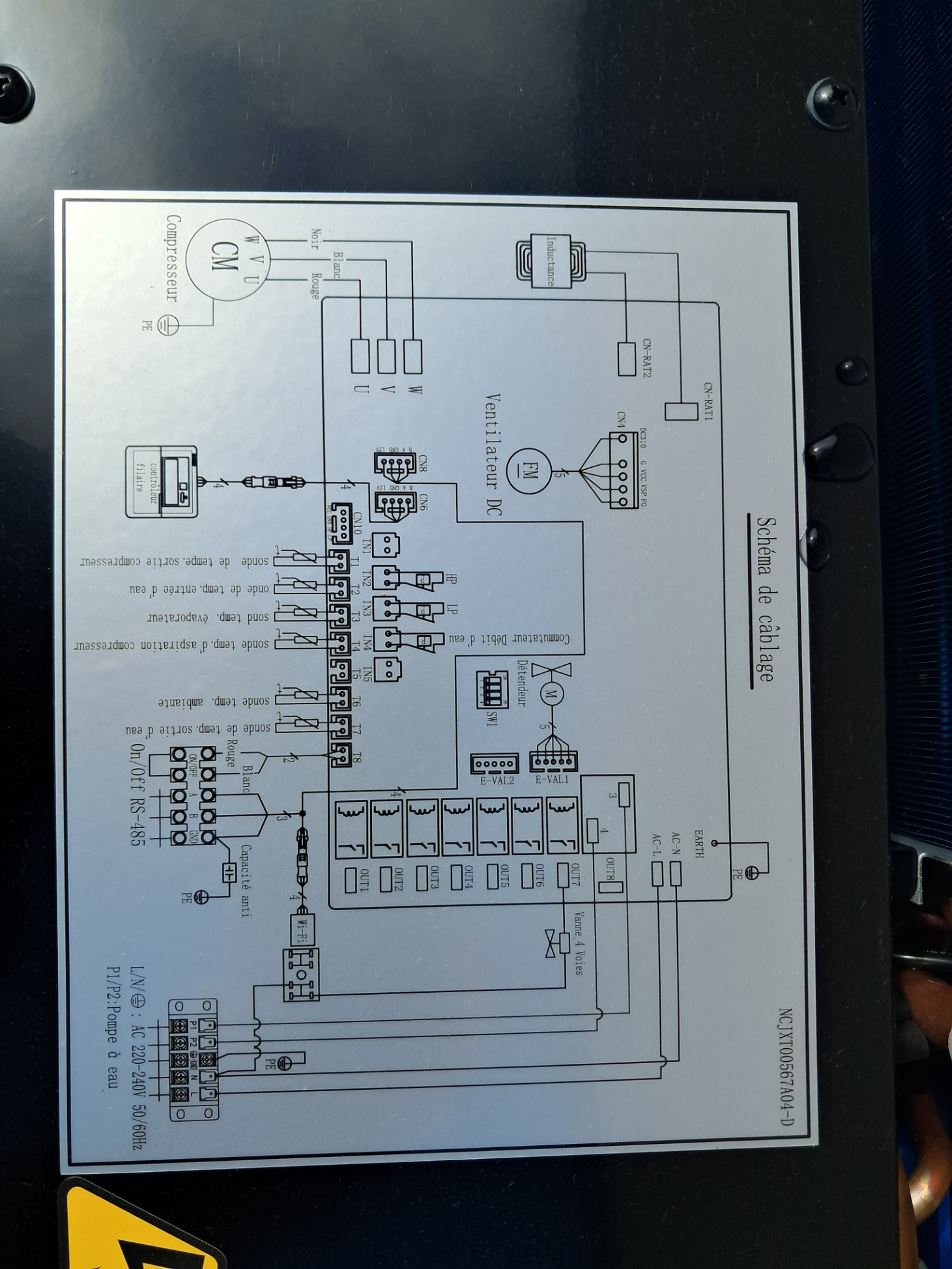

Salut à tous.
J’ai une PAC pour ma piscine de marque CF type comfort inverter R290.
En voyant les photos postées par tona et bentou, j’ai reconnu les connecteurs et le module wifi de ma PAC. D’après ce que j’ai pu trouver, elles partagent aussi l’écran tactile intégré de commande et l’application smartphone. Il semblerait que ces machines soient des variantes commerciales issues d’un même fabriquant (Aquacal Tropical) ?
J’ai connecté un Waveshare RS232/485/422 to RJ45 Ethernet Module POE au bornier RS485. Malheureusement, le « fabriquant » CF ne publie pas la table des Modbus, et j’avance un peu à l’aveuglette. La seule possibilité qu’il mettent en avant c’est l’application smartphone wifi que je n’ai pas pu interfacer avec Home Assistant.
En modifiant la consigne de température, j’ai pu constater que ce paramètre était à la même adresse que sur la PAC de Stephane_L62 (On la trouve dans le code qu’il a partagé).
L’un de vous pourrait-il me faire parvenir en mp la table Modbus de sa PAC ? Même s’il y a des différences, cela me ferait probablement gagner du temps.

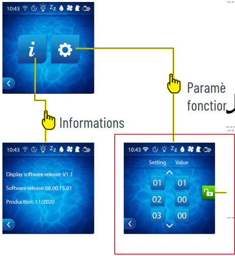

Il y a une autre partie que je n’ai pas réussi a trouver dans la documentation, c’est à quoi correspondent les paramètres de fonctionnement que l’on voit dans le panneau de commande (écran tactile).
L’un d’entre vous sait-il à quoi correspondent ces paramètres ?
