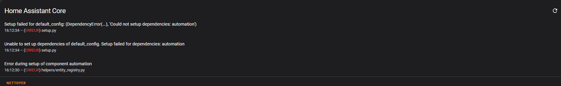

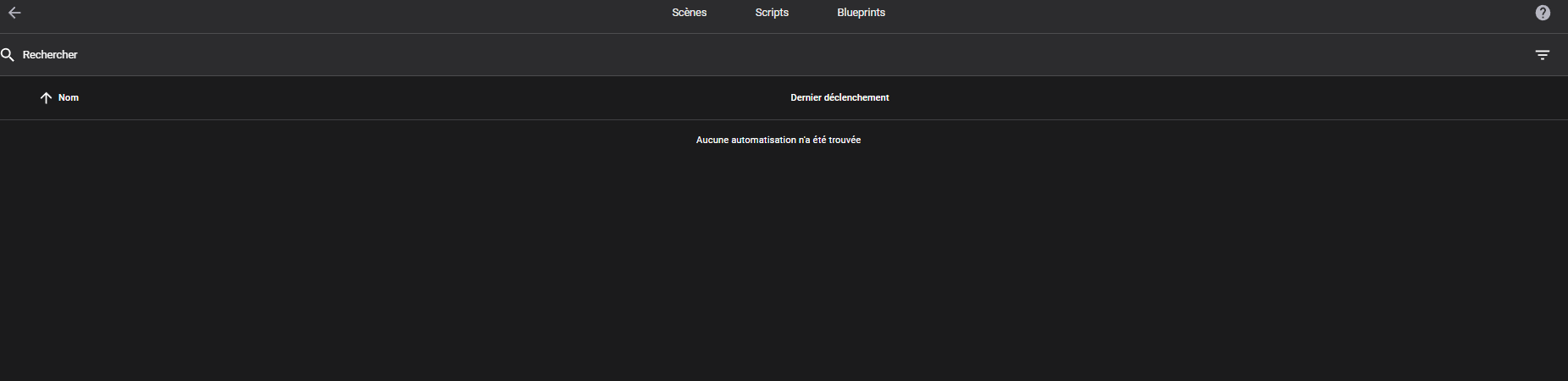

"Invalid Config" Plus aucune Automatisation
J’ai un message d’erreur depuis aujourd’hui, et je n’ai plus aucune automatisation !
1
J’ai l’impression que c’est arrivé juste après avoir fait la dernière mise à jour de HA, sans en être sûr à 100%…
J’ai fait une restauration antérieure, mais rien ne change.
Je suis sous un Raspberry 4 8go, ssd nvme sous hub alimenté.
Voici mes logs:
2023-08-12 16:11:56.575 WARNING (SyncWorker_4) [homeassistant.loader] We found a custom integration husqvarna_automower which has not been tested by Home Assistant. This component might cause stability problems, be sure to disable it if you experience issues with Home Assistant
2023-08-12 16:11:56.578 WARNING (SyncWorker_4) [homeassistant.loader] We found a custom integration hacs which has not been tested by Home Assistant. This component might cause stability problems, be sure to disable it if you experience issues with Home Assistant
2023-08-12 16:11:56.582 WARNING (SyncWorker_4) [homeassistant.loader] We found a custom integration daikin_residential which has not been tested by Home Assistant. This component might cause stability problems, be sure to disable it if you experience issues with Home Assistant
2023-08-12 16:11:56.585 WARNING (SyncWorker_4) [homeassistant.loader] We found a custom integration xiaomi_miot which has not been tested by Home Assistant. This component might cause stability problems, be sure to disable it if you experience issues with Home Assistant
2023-08-12 16:12:01.184 WARNING (Recorder) [homeassistant.components.recorder.util] The system could not validate that the sqlite3 database at //config/home-assistant_v2.db was shutdown cleanly
2023-08-12 16:12:25.987 WARNING (MainThread) [homeassistant.config_entries] Config entry '55OLED807/12' for androidtv_remote integration not ready yet: Couldn't connect to 192.168.1.10:6466; Retrying in background
2023-08-12 16:12:26.612 WARNING (MainThread) [homeassistant.config_entries] Config entry '55OLED807/12' for androidtv_remote integration not ready yet: Couldn't connect to 192.168.1.16:6466; Retrying in background
2023-08-12 16:12:30.217 ERROR (MainThread) [homeassistant.setup] Error during setup of component automation

voluptuous.error.Invalid: Unknown entity registry entry b4d7fe192ac1cdd44510bdfc866a0963
2023-08-12 16:12:34.852 ERROR (MainThread) [homeassistant.setup] Unable to set up dependencies of default_config. Setup failed for dependencies: automation
2023-08-12 16:12:34.855 ERROR (MainThread) [homeassistant.setup] Setup failed for default_config: (DependencyError(...), 'Could not setup dependencies: automation')

  File "/usr/local/lib/python3.11/site-packages/cryptography/hazmat/primitives/serialization/base.py", line 25, in load_pem_private_key
    return ossl.load_pem_private_key(
  File "/usr/local/lib/python3.11/site-packages/cryptography/hazmat/backends/openssl/backend.py", line 747, in load_pem_private_key
    return self._load_key(
  File "/usr/local/lib/python3.11/site-packages/cryptography/hazmat/backends/openssl/backend.py", line 929, in _load_key
    self._handle_key_loading_error()
  File "/usr/local/lib/python3.11/site-packages/cryptography/hazmat/backends/openssl/backend.py", line 984, in _handle_key_loading_error
    raise ValueError(
ValueError: ('Could not deserialize key data. The data may be in an incorrect format, it may be encrypted with an unsupported algorithm, or it may be an unsupported key type (e.g. EC curves with explicit parameters).', [<OpenSSLError(code=503841036, lib=60, reason=524556, reason_text=unsupported)>])
Merci Beaucoup pour votre aide ! :pray: :wink:
version core-2023.8.2
python_version 3.11.4
os_version 6.1.21-v8
GitHub API Calls Remaining 4778
Installed Version 1.32.1
Available Repositories 1269
Downloaded Repositories 11
host_os Home Assistant OS 10.4
supervisor_version supervisor-2023.08.1
agent_version 1.5.1
docker_version 23.0.6
disk_total 457.7 GB
disk_used 58.1 GB
board rpi4-64
installed_addons Samba share (10.0.2), Terminal & SSH (9.7.1), Z-Wave JS UI (1.15.5), Studio Code Server (5.10.0), OneDrive Backup (2.1.2), Network UPS Tools (0.12.0), Samba Backup (5.2.0), Zigbee2MQTT (1.32.2-1), Mosquitto broker (6.2.1)
Husqvarna Automower
can_reach_server ok
dashboards 2
resources 6
views 10
oldest_recorder_run 2 août 2023 à 20:22
current_recorder_run 12 août 2023 à 16:12
estimated_db_size 856.56 MiB
database_version 3.41.2
Xiaomi Miot Auto
component_version 0.7.10
can_reach_server ok
can_reach_spec ok
logged_accounts 1
total_devices 1
Suite des Logs:

Copie le fichier automatisation.yaml dans un coin, et efface son contenu pour redémarrer HA.
Ensuite, réimporte les automatisations 1 à 1, l’une d’elles sans doute incorrect au niveau de la syntaxe.
Ok, merci.
Mais j’ai énormément d’automatisations.
Comment je les importe une à une ?
Je copie le code associé dans automatisation.yaml ?
Je dois redémarrer HA à chaque importation ?
ça risque d’être long, mais plus rapide que de tout réécrire
Confirme d’abord que c’est bien ce fichier là qui bloque.
Ensuite,tu peux importer les automatisations en mode YAML ça ressemble à ça :
Et dans le fichier à ça

Apres pas mal de temps et plus de 6000 lignes de codes… j’ai fini par trouver les deux automatisations en cause.
Les deux sont en relation avec mon alarme et ma porte de garage.
Elles font également buguer HA lorsque je les rentre via l’éditeur visuel.
