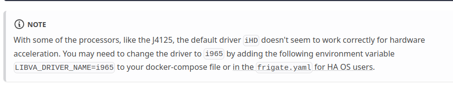

il te manque ceci dans ton confi.yaml
environment_vars:
    LIBVA_DRIVER_NAME: i965
tu peux aussi le passer dans ton docker compose :wink:
Quèsaco ce paramètre ??
J’ai ajouté le paramètre à mon config.yml, big error :
2024-03-20 17:22:34.577414409  [2024-03-20 17:22:34] watchdog.salon                 ERROR   : The following ffmpeg logs include the last 100 lines prior to exit.
2024-03-20 17:22:34.577415956  [2024-03-20 17:22:34] ffmpeg.salon.detect            ERROR   : [AVHWDeviceContext @ 0x63ae5e5d63c0] libva: /usr/lib/x86_64-linux-gnu/dri/i965_drv_video.so init failed
2024-03-20 17:22:34.577417281  [2024-03-20 17:22:34] ffmpeg.salon.detect            ERROR   : [AVHWDeviceContext @ 0x63ae5e5d63c0] Failed to initialise VAAPI connection: -1 (unknown libva error).
2024-03-20 17:22:34.577418343  [2024-03-20 17:22:34] ffmpeg.salon.detect            ERROR   : Device creation failed: -5.
2024-03-20 17:22:34.577419560  [2024-03-20 17:22:34] ffmpeg.salon.detect            ERROR   : [h264 @ 0x63ae5e521580] No device available for decoder: device type vaapi needed for codec h264.
2024-03-20 17:22:34.577420734  [2024-03-20 17:22:34] ffmpeg.salon.detect            ERROR   : Device setup failed for decoder on input stream #0:0 : Input/output error
2024-03-20 17:22:36.634582933  [2024-03-20 17:22:36] frigate.video                  ERROR   : estrade: Unable to read frames from ffmpeg process.
2024-03-20 17:22:36.634673357  [2024-03-20 17:22:36] frigate.video                  ERROR   : estrade: ffmpeg process is not running. exiting capture thread...
2024-03-20 17:22:37.600987899  [2024-03-20 17:22:37] frigate.video                  ERROR   : salon: Unable to read frames from ffmpeg process.
2024-03-20 17:22:37.601010921  [2024-03-20 17:22:37] frigate.video                  ERROR   : salon: ffmpeg process is not running. exiting capture thread...
2024-03-20 17:22:39.200523754  [2024-03-20 17:22:39] frigate.video                  ERROR   : exterieur: Unable to read frames from ffmpeg process.
2024-03-20 17:22:39.200526689  [2024-03-20 17:22:39] frigate.video                  ERROR   : exterieur: ffmpeg process is not running. exiting capture thread...
c’est le paramètre qui dit a frigate quel driver utiliser pour la partie GPU. atta je te retrouve ça hillico
dans mon cas j’ai un AMD j’ai donc mis
 environment:
      LIBVA_DRIVER_NAME: radeonsi
et vu que la doc est toujours aussi moisie, cela peut passer rapidement inaperçu
