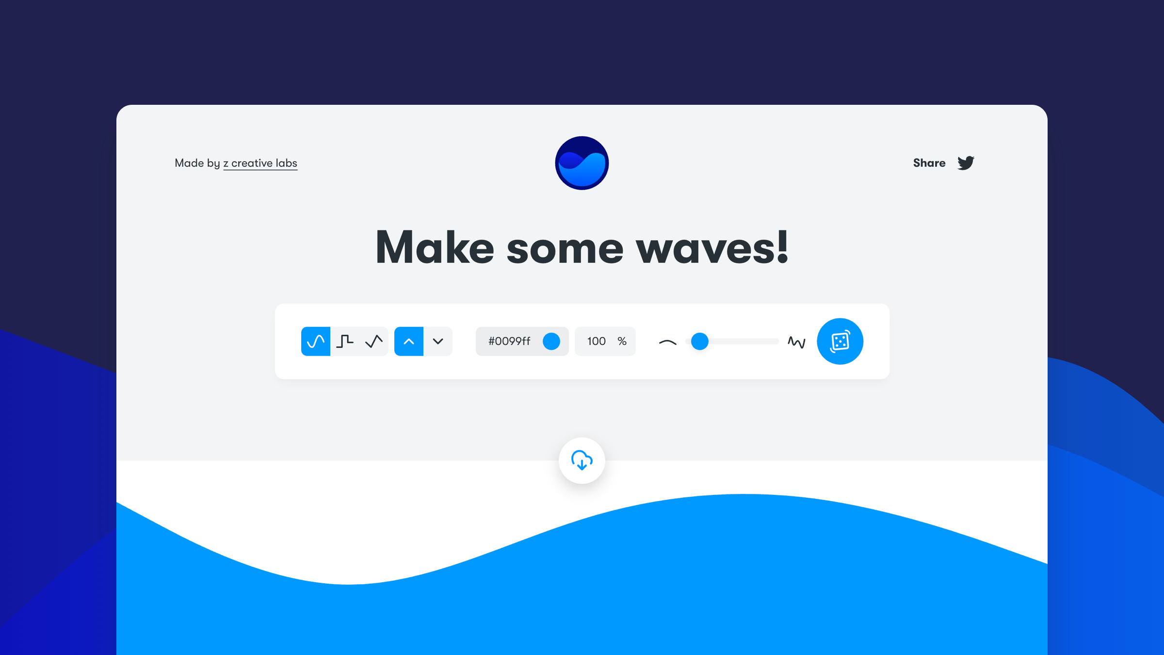

J’avais trouvé ce site pour le SVG : SVG Wave Generator – Create SVG waves for your designs

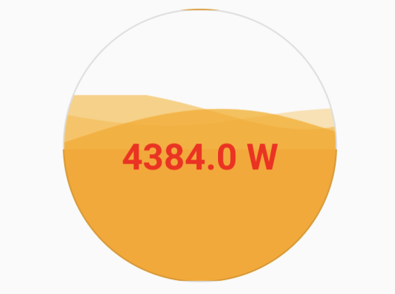

J’essaie encore, pour le moment j’ai triché dans le code, car je n’arrive pas à grandir les vagues…
1000778555
type: custom:button-card
entity: input_number.test
show_name: false
show_state: true
state_display: '[[[ return states[entity.entity_id].state + " W"; ]]]'
styles:
  card:
    - left: 130px
    - margin-bottom: 10px
    - height: 150px
    - width: 150px
    - font-size: 20px
    - font-weight: bold
    - line-height: 150px
    - border-radius: 75px
    - background-color: dimgrey
    - position: relative
    - overflow: hidden
    - display: flex
    - align-items: center
    - justify-content: center
    - background: |
          var value = parseFloat(states['input_number.test'].state);
          var max = 6400;
          var color = 'orange';
          var percent = Math.min(100, (value/max*100)) -20;
          return `linear-gradient(to top, ${color} ${percent}%, transparent ${percent}%)`;
  state:
    - color: red
    - text-align: center
    - font-size: 20px
    - font-weight: bold
    - z-index: 2
extra_styles: |
  @keyframes wave {
    0% { transform: translateX(0); }
    100% { transform: translateX(-50%); }
  .wave-container {
    position: absolute;
    bottom: 0;
    left: 0;
    width: 100%;
    height: 100%;
    overflow: hidden;
    display: flex;
    align-items: flex-end;
    background-color: transparent;
  .wave {
    position: absolute;
    bottom: 0;
    left: 0;
    width: 200%;
    height: 200%;
    fill: rgba(255, 165, 0, 0.5);
    animation: wave 4s infinite linear;
    transform-origin: bottom;
  .wave:nth-of-type(2) {
    fill: rgba(255, 165, 0, 0.7);
    animation-delay: -1.33s;
  .wave:nth-of-type(3) {
    fill: rgba(255, 165, 0, 0.3);
    animation-delay: -2.66s;
custom_fields:
  wave: |
      var max = 6400;
      var percent = Math.min(100, (value / max * 100));
      var height = percent + "%";
      return `
        <div class="wave-container" style="height: ${height};">
          <svg class="wave" viewBox="0 0 1440 320"><path d="M0,224L48,213.3C96,203,192,181,288,165.3C384,149,480,139,576,144C672,149,768,171,864,197.3C960,224,1056,256,1152,250.7C1248,245,1344,203,1392,181.3L1440,160L1440,320L0,320Z"></path></svg>
          <svg class="wave" viewBox="0 0 1440 320"><path d="M0,288L48,272C96,256,192,224,288,208C384,192,480,192,576,213.3C672,235,768,277,864,288C960,299,1056,277,1152,250.7C1248,224,1344,192,1392,176L1440,320L0,320Z"></path></svg>
          <svg class="wave" viewBox="0 0 1440 320"><path d="M0,160L48,170.7C96,181,192,203,288,218.7C384,235,480,245,576,240C672,235,768,213,864,202.7C960,192,1056,192,1152,181.3C1248,171,1344,149,1392,138.7L1440,320L0,320Z"></path></svg>
        </div>

          const scale = percent / 100;
          return `
            <div class="wave-container" style="z-index: 1;">
              <svg class="wave" style="transform: scaleY(${scale}); animation-duration: ${duration};" viewBox="0 0 1440 320"><path d="M0,224L48,213.3C96,203,192,181,288,165.3C384,149,480,139,576,144C672,149,768,171,864,197.3C960,224,1056,256,1152,250.7C1248,245,1344,203,1392,181.3L1440,160L1440,320L1392,320C1344,320,1248,320,1152,320C1056,320,960,320,864,320C768,320,672,320,576,320C480,320,384,320,288,320C192,320,96,320,48,320L0,320Z"></path></svg>
              <svg class="wave" style="transform: scaleY(${scale}); animation-duration: ${duration};" viewBox="0 0 1440 320"><path d="M0,288L48,272C96,256,192,224,288,208C384,192,480,192,576,213.3C672,235,768,277,864,288C960,299,1056,277,1152,250.7C1248,224,1344,192,1392,176L1440,160L1440,320L1392,320C1344,320,1248,320,1152,320C1056,320,960,320,864,320C768,320,672,320,576,320C480,320,384,320,288,320C192,320,96,320,48,320L0,320Z"></path></svg>
              <svg class="wave" style="transform: scaleY(${scale}); animation-duration: ${duration};" viewBox="0 0 1440 320"><path d="M0,160L48,170.7C96,181,192,203,288,218.7C384,235,480,245,576,240C672,235,768,213,864,202.7C960,192,1056,192,1152,181.3C1248,171,1344,149,1392,138.7L1440,128L1440,320L1392,320C1344,320,1248,320,1152,320C1056,320,960,320,864,320C768,320,672,320,576,320C480,320,384,320,288,320C192,320,96,320,48,320L0,320Z"></path></svg>
            </div>

Merci pour le partage.
J’ai cherché une astuce pour que la première carte soit toujours centrée, quelle que soit la largeur de colonne ou le type de consultation (iphone, tablette ou navigateur) avec du horizontal-stack, 3 colonnes et des boutons vides transparents et sans bordures.
type: vertical-stack
  - square: false
    type: horizontal-stack
    columns: 3
      - type: button
        card_mod:
          style: |
            ha-card {
              border: none;
              background: transparent;
      - type: custom:button-card
        entity: sensor.ecu_current_power
        show_name: false
        show_state: true
        styles:
          card:
            - height: 150px
            - width: 150px
            - font-size: 20px
            - font-weight: bold
            - overflow: hidden
            - background-color: whitesnow
            - display: flex
            - margin: 0 auto
            - display: block
          state:
            - color: black
            - font-size: 20px
            - font-weight: bold
            - z-index: 2
        extra_styles: |
          @keyframes pulse-grow {
            0%, 100% {
              box-shadow: 0 0 0 0 rgba(255, 165, 0, 0.7);
              transform: scale(1);
            50% {
              box-shadow: 0 0 0 10px rgba(255, 165, 0, 0);
              transform: scale(1.1);
          @keyframes spin {
            from { transform: rotate(0deg); }
            to { transform: rotate(360deg); }
          @keyframes wave {
          .wave-container {
            position: absolute;
            bottom: 0;
            left: 0;
            width: 100%;
            height: 100%;
            overflow: hidden;
            display: flex;
          .wave {
            position: absolute;
            bottom: 0;
            left: 0;
            width: 200%;
            height: 44%;
            animation: wave infinite linear;
            animation-delay: -1s;

        custom_fields:
          outer_circle: >
            [[[ return `<div class="outer_circle" style="position: absolute;
            top: 0px; left: 0px; right: 0px; bottom: 0px; border-radius: 50%;
            border: 4px solid transparent; background: conic-gradient(orange 0%,
            orange 90%, yellow 90% 100%); box-shadow: 0 0 10px rgba(255, 165, 0,
            0.5); animation: spin 5s linear infinite; z-index: 0;"></div>`; ]]]
          highlight: >
            [[[ return `
            <style>
            .highlight {
              animation: spin 5s linear infinite reverse;
              z-index: 0;
            </style>
            <div class="highlight" style="position: absolute; top: -4px; left:
            -4px; width: 100%; height: 100%; border-radius: 50%; border: 4px
            solid transparent; border-top-color: yellow;"></div>`; ]]]
          inner_circle: >
            [[[ return `<div class="inner_circle" style="position: absolute;
            top: 4px; left: 4px; right: 4px; bottom: 4px; border-radius: 50%;
            background-color: white; border: 2px solid rgba(255, 165, 0, 0.3);
          wave: |
              const value = parseFloat(states['sensor.ecu_current_power'].state);
              const max = 800;
              let duration;
              if (value <= 100) {
                duration = '4.6s';
              } else if (value <= 200) {
                duration = '4s';
              } else if (value <= 300) {
                duration = '3.6s';
              } else if (value <= 400) {
                duration = '3.3s';
              } else if (value <= 500) {
                duration = '2.8s';
              } else if (value <= 600) {
                duration = '2.6s';
              } else if (value <= 700) {
                duration = '2.4s';
              } else if (value <= 800) {
                duration = '2.2s';
              } else if (value <= 900) {
                duration = '1.8s';
              } else if (value <= 1000) {
                duration = '1.5s';
              } else {
                duration = '1s';
              const percent = Math.min(100, (value / max * 100));
              return `
                </div>
      - type: button
