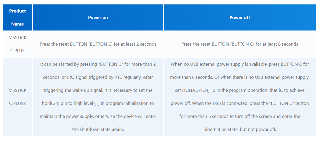

on_boot:
- priority: 600
then:
- output.turn_on: output_high
- then:
- light.turn_on:
brightness: 75%
on_shutdown:
- priority: 600
then:
- output.turn_off: output_high
