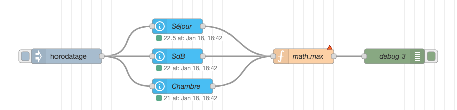

J’ai besoin de ressortir la T° maximum de ces 3 consignes pour l’exploiter en réseau primaire.
Je pense à la fonction math.max mais je ne vois pas comment la formuler.
Dans l’exemple, je veux retenir la valeur 22.5 (celle du Séjour).
Merci pour vos conseils,

[{"id":"c0b182ce4823d1ee","type":"api-current-state","z":"efc74f09177072ce","name":"Séjour","server":"f1388c55.bbcd1","version":3,"outputs":1,"halt_if":"","halt_if_type":"str","halt_if_compare":"is","entity_id":"sensor.consigne_sejour_2","state_type":"num","blockInputOverrides":true,"outputProperties":[{"property":"payload","propertyType":"msg","value":"","valueType":"entityState"},{"property":"data","propertyType":"msg","value":"","valueType":"entity"}],"for":"0","forType":"num","forUnits":"minutes","override_topic":false,"state_location":"payload","override_payload":"msg","entity_location":"data","override_data":"msg","x":410,"y":1760,"wires":[["1dbce4652ccfb00e"]]},{"id":"7a3b4a5cd8701e23","type":"api-current-state","z":"efc74f09177072ce","name":"SdB","server":"f1388c55.bbcd1","version":3,"outputs":1,"halt_if":"","halt_if_type":"str","halt_if_compare":"is","entity_id":"sensor.consigne_sdb_sauna_2","state_type":"num","blockInputOverrides":true,"outputProperties":[{"property":"payload","propertyType":"msg","value":"","valueType":"entityState"},{"property":"data","propertyType":"msg","value":"","valueType":"entity"}],"for":"0","forType":"num","forUnits":"minutes","override_topic":false,"state_location":"payload","override_payload":"msg","entity_location":"data","override_data":"msg","x":410,"y":1820,"wires":[["1dbce4652ccfb00e"]]},{"id":"1762d0338ddaf518","type":"api-current-state","z":"efc74f09177072ce","name":"Chambre","server":"f1388c55.bbcd1","version":3,"outputs":1,"halt_if":"","halt_if_type":"str","halt_if_compare":"is","entity_id":"sensor.consigne_chambre_2","state_type":"num","blockInputOverrides":true,"outputProperties":[{"property":"payload","propertyType":"msg","value":"","valueType":"entityState"},{"property":"data","propertyType":"msg","value":"","valueType":"entity"}],"for":"0","forType":"num","forUnits":"minutes","override_topic":false,"state_location":"payload","override_payload":"msg","entity_location":"data","override_data":"msg","x":420,"y":1880,"wires":[["1dbce4652ccfb00e"]]},{"id":"c101072e850d94a9","type":"inject","z":"efc74f09177072ce","name":"","props":[{"p":"payload"},{"p":"topic","vt":"str"}],"repeat":"","crontab":"","once":false,"onceDelay":0.1,"topic":"","payload":"","payloadType":"date","x":190,"y":1820,"wires":[["c0b182ce4823d1ee","7a3b4a5cd8701e23","1762d0338ddaf518"]]},{"id":"307ab5db045623bf","type":"debug","z":"efc74f09177072ce","name":"debug 3","active":true,"tosidebar":true,"console":false,"tostatus":false,"complete":"true","targetType":"full","statusVal":"","statusType":"auto","x":840,"y":1820,"wires":[]},{"id":"1dbce4652ccfb00e","type":"function","z":"efc74f09177072ce","name":"math.max","func":"msg.payload = Math.max(xxx);\nreturn msg;","outputs":1,"timeout":0,"noerr":1,"initialize":"","finalize":"","libs":[],"x":660,"y":1820,"wires":[["307ab5db045623bf"]]},{"id":"f1388c55.bbcd1","type":"server","name":"Home Assistant RBT","addon":true,"rejectUnauthorizedCerts":true,"ha_boolean":"","connectionDelay":false,"cacheJson":false,"heartbeat":false,"heartbeatInterval":"","statusSeparator":"","enableGlobalContextStore":false}]

Capture d'écran 2025-01-18 190633
Même sans le commentaire d’entrée, il n’a pas l’air d’aimer…
Mais une fois la correction faite, je voudrais tester ces valeurs en permanence, alors que le node Fonction réclame un node en entrée…
Pour l’exemple j’ai mis un inject mais ce serait plutôt un events:state
Merci d’avance,
