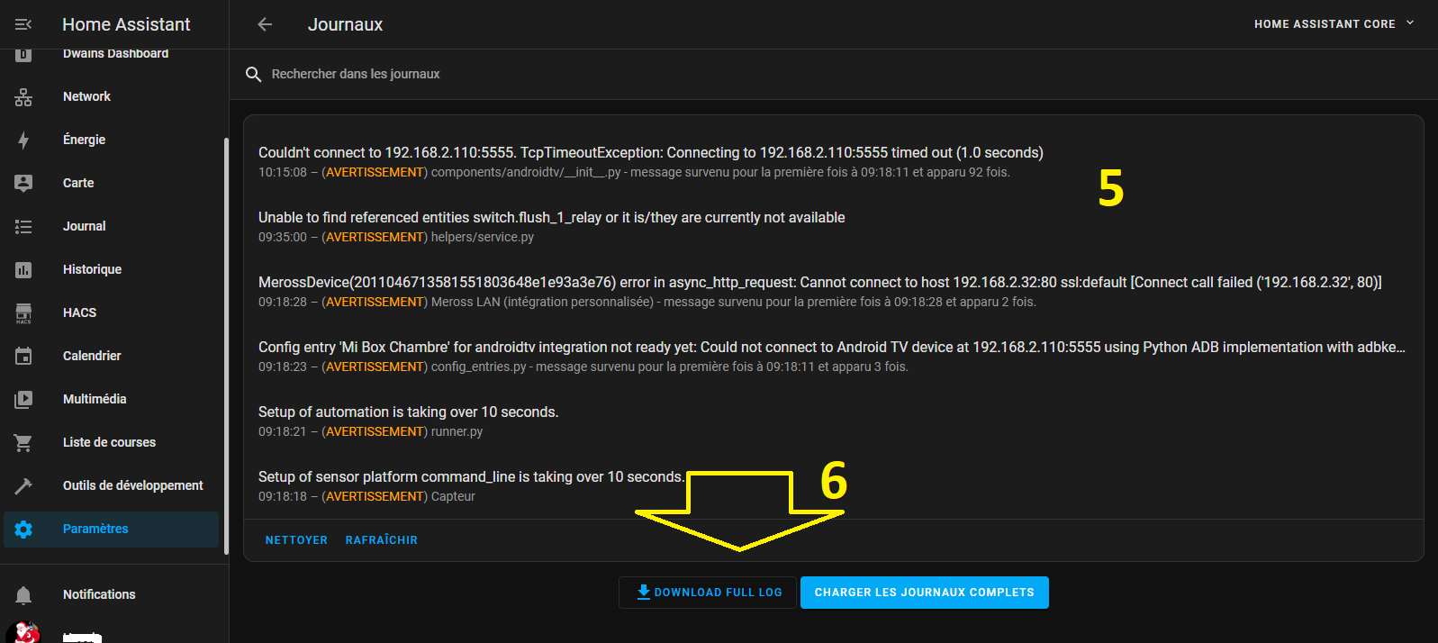

voici le fichier complet
022-12-26 09:54:44.638 WARNING (SyncWorker_0) [homeassistant.loader] We found a custom integration meross_cloud which has not been tested by Home Assistant. This component might cause stability problems, be sure to disable it if you experience issues with Home Assistant
2022-12-26 09:54:44.642 WARNING (SyncWorker_0) [homeassistant.loader] We found a custom integration meross_lan which has not been tested by Home Assistant. This component might cause stability problems, be sure to disable it if you experience issues with Home Assistant
2022-12-26 09:54:44.646 WARNING (SyncWorker_0) [homeassistant.loader] We found a custom integration candy which has not been tested by Home Assistant. This component might cause stability problems, be sure to disable it if you experience issues with Home Assistant
2022-12-26 09:54:44.650 WARNING (SyncWorker_0) [homeassistant.loader] We found a custom integration hacs which has not been tested by Home Assistant. This component might cause stability problems, be sure to disable it if you experience issues with Home Assistant
2022-12-26 09:54:51.113 WARNING (MainThread) [homeassistant.components.ssdp] Could not set up UPnP/SSDP server, as a presentation URL could not be determined; Please configure your internal URL in the Home Assistant general configuration
2022-12-26 09:54:51.503 ERROR (MainThread) [homeassistant.setup] Setup failed for cloud: Unable to import component:
IMPORTANT: PLEASE READ THIS FOR ADVICE ON HOW TO SOLVE THIS ISSUE!
Importing the numpy C-extensions failed. This error can happen for
many reasons, often due to issues with your setup or how NumPy was
installed.
We have compiled some common reasons and troubleshooting tips at:
https://numpy.org/devdocs/user/troubleshooting-importerror.html
Please note and check the following:
- The Python version is: Python3.10 from « /usr/local/bin/python3 »
- The NumPy version is: « 1.23.2 »
and make sure that they are the versions you expect.
Please carefully study the documentation linked above for further help.
Original error was: Error loading shared library _LR: No such file or directory (needed by /usr/local/lib/python3.10/site-packages/numpy/core/…/…/numpy.libs/libopenblas_armv8p-r0-8b2c479e.3.20.so)
2022-12-26 09:54:59.585 WARNING (MainThread) [custom_components.meross_cloud] Skip MQTT cert validation option set to: False
2022-12-26 09:55:00.400 ERROR (MainThread) [homeassistant.setup] Setup failed for mobile_app: Unable to import component:
installed.
2022-12-26 09:55:00.662 ERROR (MainThread) [homeassistant.setup] Setup failed for netatmo: Unable to import component:
installed.
2022-12-26 09:55:00.721 ERROR (MainThread) [homeassistant.setup] Unable to set up dependencies of default_config. Setup failed for dependencies: cloud, mobile_app
2022-12-26 09:55:00.722 ERROR (MainThread) [homeassistant.setup] Setup failed for default_config: (DependencyError(…), ‹ Could not setup dependencies: cloud, mobile_app ›)
2022-12-26 09:55:01.096 WARNING (MainThread) [custom_components.meross_cloud]
Meross Cloud Custom component
Developed by Alberto Geniola
Low level library version: 0.4.5.0
This custom component is under development and not yet ready for production use.
In case of errors/misbehave, please report it here:
If you like this extension and you want to support it, please consider donating.
List of devices reported by HTTP API:
- Smart Ambient Light (msl430) - OnlineStatus.ONLINE
2022-12-26 09:55:02.689 WARNING (MainThread) [meross_iot.manager] Found a new device Smart Ambient Light (msl430, HW 4.0.0, FW 4.2.6, class: msl430:4.0.0:4.2.6) that has become online while we were offline.
2022-12-26 09:55:06.255 ERROR (MainThread) [homeassistant.config_entries] Error occurred loading configuration flow for integration mqtt:
installed.
2022-12-26 09:55:06.282 ERROR (MainThread) [homeassistant] Error doing job: Task exception was never retrieved
File « /usr/local/lib/python3.10/site-packages/numpy/core/init.py », line 23, in
from . import multiarray
File « /usr/local/lib/python3.10/site-packages/numpy/core/multiarray.py », line 10, in
from . import overrides
File « /usr/local/lib/python3.10/site-packages/numpy/core/overrides.py », line 6, in
from numpy.core._multiarray_umath import (
ImportError: Error loading shared library _LR: No such file or directory (needed by /usr/local/lib/python3.10/site-packages/numpy/core/…/…/numpy.libs/libopenblas_armv8p-r0-8b2c479e.3.20.so)
File « /usr/src/homeassistant/homeassistant/config_entries.py », line 832, in async_create_flow
integration.get_platform(« config_flow »)
File « /usr/src/homeassistant/homeassistant/loader.py », line 728, in get_platform
cache[full_name] = self._import_platform(platform_name)
File « /usr/src/homeassistant/homeassistant/loader.py », line 745, in _import_platform
return importlib.import_module(f"{self.pkg_path}.{platform_name}")
File « /usr/local/lib/python3.10/importlib/init.py », line 126, in import_module
return _bootstrap._gcd_import(name[level:], package, level)
File « », line 1050, in _gcd_import
File « », line 1027, in _find_and_load
File « », line 992, in _find_and_load_unlocked
File « », line 241, in _call_with_frames_removed
File « », line 1006, in _find_and_load_unlocked
File « », line 688, in _load_unlocked
File « », line 883, in exec_module
File « /usr/src/homeassistant/homeassistant/components/mqtt/init.py », line 54, in
from .config_integration import (
File « /usr/src/homeassistant/homeassistant/components/mqtt/config_integration.py », line 17, in
from . import (
File « /usr/src/homeassistant/homeassistant/components/mqtt/camera.py », line 10, in
from homeassistant.components import camera
File « /usr/src/homeassistant/homeassistant/components/camera/init.py », line 30, in
from homeassistant.components.stream import (
File « /usr/src/homeassistant/homeassistant/components/stream/init.py », line 61, in
from .core import (
File « /usr/src/homeassistant/homeassistant/components/stream/core.py », line 15, in
import numpy as np
File « /usr/local/lib/python3.10/site-packages/numpy/init.py », line 140, in
from . import core
File « /usr/local/lib/python3.10/site-packages/numpy/core/init.py », line 49, in
raise ImportError(msg)
ImportError:
installed.
File « /usr/src/homeassistant/homeassistant/data_entry_flow.py », line 226, in async_init
flow, result = await task
File « /usr/src/homeassistant/homeassistant/data_entry_flow.py », line 244, in _async_init
flow = await self.async_create_flow(handler, context=context, data=data)
File « /usr/src/homeassistant/homeassistant/config_entries.py », line 839, in async_create_flow
raise data_entry_flow.UnknownHandler
homeassistant.data_entry_flow.UnknownHandler
2022-12-26 10:08:24.507 ERROR (MainThread) [aiohttp.server] Error handling request
File « /usr/local/lib/python3.10/site-packages/aiohttp/web_protocol.py », line 435, in _handle_request
resp = await request_handler(request)
File « /usr/local/lib/python3.10/site-packages/aiohttp/web_app.py », line 504, in _handle
resp = await handler(request)
File « /usr/local/lib/python3.10/site-packages/aiohttp/web_middlewares.py », line 117, in impl
return await handler(request)
File « /usr/src/homeassistant/homeassistant/components/http/security_filter.py », line 60, in security_filter_middleware
File « /usr/src/homeassistant/homeassistant/components/http/forwarded.py », line 100, in forwarded_middleware
File « /usr/src/homeassistant/homeassistant/components/http/request_context.py », line 28, in request_context_middleware
File « /usr/src/homeassistant/homeassistant/components/http/ban.py », line 81, in ban_middleware
File « /usr/src/homeassistant/homeassistant/components/http/auth.py », line 236, in auth_middleware
File « /usr/src/homeassistant/homeassistant/components/http/view.py », line 136, in handle
result = await result
File « /usr/src/homeassistant/homeassistant/components/config/config_entries.py », line 86, in delete
result = await hass.config_entries.async_remove(entry_id)
File « /usr/src/homeassistant/homeassistant/config_entries.py », line 950, in async_remove
await entry.async_remove(self.hass)
File « /usr/src/homeassistant/homeassistant/config_entries.py », line 551, in async_remove
component = integration.get_component()
File « /usr/src/homeassistant/homeassistant/loader.py », line 709, in get_component
cache[self.domain] = importlib.import_module(self.pkg_path)
