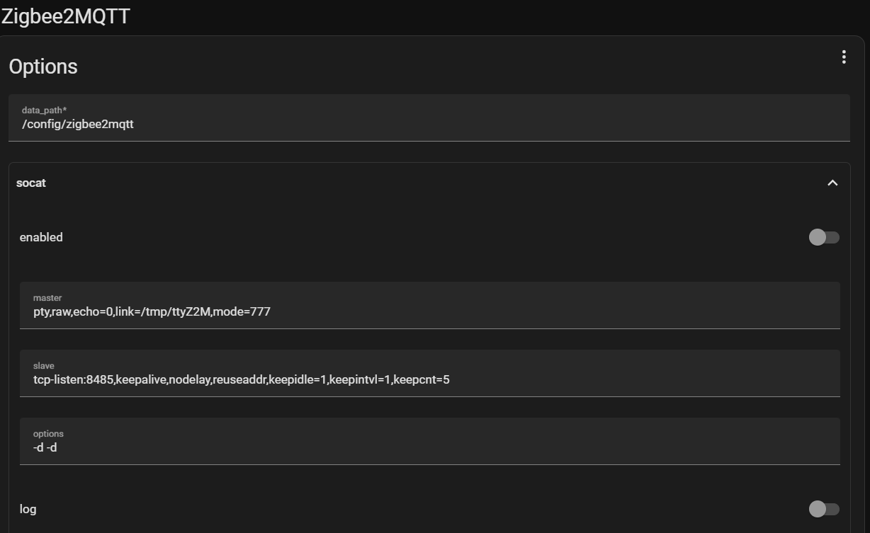

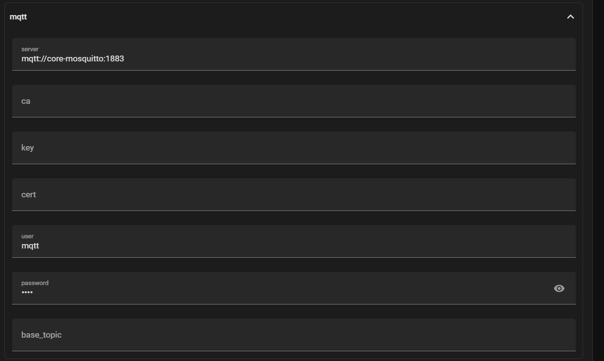

Ma configuration Z2M
data_path: /config/zigbee2mqtt
socat:
  enabled: false
  master: pty,raw,echo=0,link=/tmp/ttyZ2M,mode=777
  slave: tcp-listen:8485,keepalive,nodelay,reuseaddr,keepidle=1,keepintvl=1,keepcnt=5
  options: "-d -d"
  log: false
mqtt:
  base_topic: zigbee2mqtt

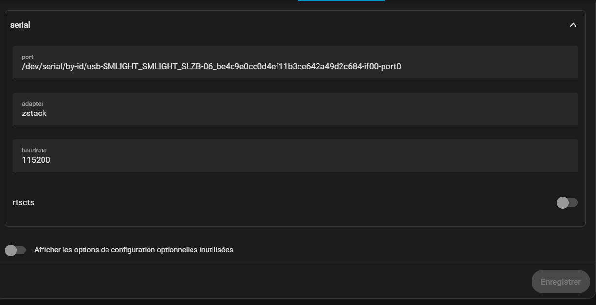

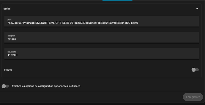

serial:
  port: >-
    /dev/serial/by-id/usb-SMLIGHT_SMLIGHT_SLZB-06_be4c9e0cc0d4ef11b3ce642a49d2c684-if00-port0
  adapter: zstack
  baudrate: 115200
  rtscts: false
force_onboarding: false
J’utilise une clé SLZB-06 firmware à jour et connectée

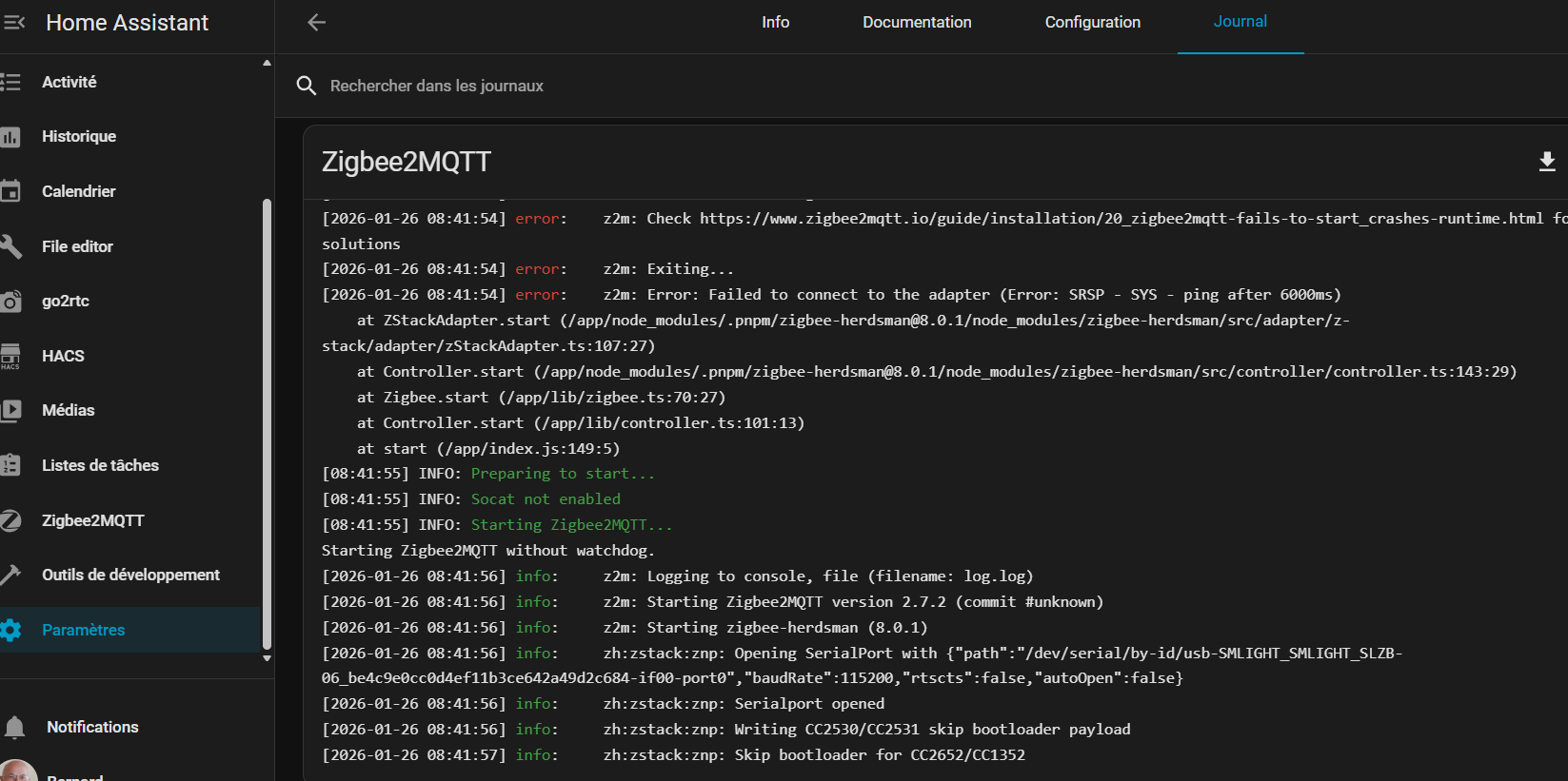

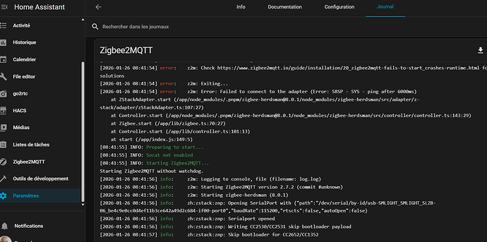

Voici les logs de Z2M
[18:18:23] INFO: Preparing to start...
[18:18:23] INFO: Socat not enabled
[18:18:23] INFO: Starting Zigbee2MQTT...
[2026-01-23 18:18:24] info: 	z2m: Logging to console, file (filename: log.log)
[2026-01-23 18:18:24] info: 	z2m: Starting Zigbee2MQTT version 2.7.2 (commit #unknown)
[2026-01-23 18:18:24] info: 	z2m: Starting zigbee-herdsman (8.0.1)
[2026-01-23 18:18:24] info: 	zh:zstack:znp: Opening SerialPort with {"path":"/dev/serial/by-id/usb-SMLIGHT_SMLIGHT_SLZB-06_be4c9e0cc0d4ef11b3ce642a49d2c684-if00-port0","baudRate":115200,"rtscts":false,"autoOpen":false}
[2026-01-23 18:18:24] info: 	zh:zstack:znp: Serialport opened
[2026-01-23 18:18:24] info: 	zh:zstack:znp: Writing CC2530/CC2531 skip bootloader payload
[2026-01-23 18:18:26] info: 	zh:zstack:znp: Skip bootloader for CC2652/CC1352
[2026-01-23 18:18:44] error: 	z2m: Error while starting zigbee-herdsman
[2026-01-23 18:18:44] error: 	z2m: Failed to start zigbee-herdsman
[2026-01-23 18:18:44] error: 	z2m: Check https://www.zigbee2mqtt.io/guide/installation/20_zigbee2mqtt-fails-to-start_crashes-runtime.html for possible solutions
[2026-01-23 18:18:44] error: 	z2m: Exiting...
[2026-01-23 18:18:44] error: 	z2m: Error: Failed to connect to the adapter (Error: SRSP - SYS - ping after 6000ms)
    at ZStackAdapter.start (/app/node_modules/.pnpm/zigbee-herdsman@8.0.1/node_modules/zigbee-herdsman/src/adapter/z-stack/adapter/zStackAdapter.ts:107:27)
    at Controller.start (/app/node_modules/.pnpm/zigbee-herdsman@8.0.1/node_modules/zigbee-herdsman/src/controller/controller.ts:143:29)
    at Zigbee.start (/app/lib/zigbee.ts:70:27)
    at Controller.start (/app/lib/controller.ts:101:13)
    at start (/app/index.js:149:5)
[18:18:45] INFO: Preparing to start...
[18:18:45] INFO: Socat not enabled
[18:18:45] INFO: Starting Zigbee2MQTT...
[2026-01-23 18:18:46] info: 	z2m: Logging to console, file (filename: log.log)
[2026-01-23 18:18:46] info: 	z2m: Starting Zigbee2MQTT version 2.7.2 (commit #unknown)
[2026-01-23 18:18:46] info: 	z2m: Starting zigbee-herdsman (8.0.1)
[2026-01-23 18:18:46] info: 	zh:zstack:znp: Opening SerialPort with {"path":"/dev/serial/by-id/usb-SMLIGHT_SMLIGHT_SLZB-06_be4c9e0cc0d4ef11b3ce642a49d2c684-if00-port0","baudRate":115200,"rtscts":false,"autoOpen":false}
[2026-01-23 18:18:46] info: 	zh:zstack:znp: Serialport opened
[2026-01-23 18:18:46] info: 	zh:zstack:znp: Writing CC2530/CC2531 skip bootloader payload
[2026-01-23 18:18:47] info: 	zh:zstack:znp: Skip bootloader for CC2652/CC1352
[2026-01-23 18:19:06] error: 	z2m: Error while starting zigbee-herdsman
[2026-01-23 18:19:06] error: 	z2m: Failed to start zigbee-herdsman
[2026-01-23 18:19:06] error: 	z2m: Check https://www.zigbee2mqtt.io/guide/installation/20_zigbee2mqtt-fails-to-start_crashes-runtime.html for possible solutions
[2026-01-23 18:19:06] error: 	z2m: Exiting...
[2026-01-23 18:19:06] error: 	z2m: Error: Failed to connect to the adapter (Error: SRSP - SYS - ping after 6000ms)
[18:19:06] INFO: Preparing to start...
[18:19:06] INFO: Socat not enabled
[18:19:07] INFO: Starting Zigbee2MQTT...
[2026-01-23 18:19:07] info: 	z2m: Logging to console, file (filename: log.log)
[2026-01-23 18:19:07] info: 	z2m: Starting Zigbee2MQTT version 2.7.2 (commit #unknown)
[2026-01-23 18:19:07] info: 	z2m: Starting zigbee-herdsman (8.0.1)
[2026-01-23 18:19:07] info: 	zh:zstack:znp: Opening SerialPort with {"path":"/dev/serial/by-id/usb-SMLIGHT_SMLIGHT_SLZB-06_be4c9e0cc0d4ef11b3ce642a49d2c684-if00-port0","baudRate":115200,"rtscts":false,"autoOpen":false}
[2026-01-23 18:19:07] info: 	zh:zstack:znp: Serialport opened
[2026-01-23 18:19:08] info: 	zh:zstack:znp: Writing CC2530/CC2531 skip bootloader payload
[2026-01-23 18:19:09] info: 	zh:zstack:znp: Skip bootloader for CC2652/CC1352
[2026-01-23 18:19:27] error: 	z2m: Error while starting zigbee-herdsman
[2026-01-23 18:19:27] error: 	z2m: Failed to start zigbee-herdsman
[2026-01-23 18:19:27] error: 	z2m: Check https://www.zigbee2mqtt.io/guide/installation/20_zigbee2mqtt-fails-to-start_crashes-runtime.html for possible solutions
[2026-01-23 18:19:27] error: 	z2m: Exiting...
[2026-01-23 18:19:27] error: 	z2m: Error: Failed to connect to the adapter (Error: SRSP - SYS - ping after 6000ms)
[18:19:28] INFO: Preparing to start...
[18:19:28] INFO: Socat not enabled
[18:19:28] INFO: Starting Zigbee2MQTT...
[2026-01-23 18:19:29] info: 	z2m: Logging to console, file (filename: log.log)
[2026-01-23 18:19:29] info: 	z2m: Starting Zigbee2MQTT version 2.7.2 (commit #unknown)
[2026-01-23 18:19:29] info: 	z2m: Starting zigbee-herdsman (8.0.1)
[2026-01-23 18:19:29] info: 	zh:zstack:znp: Opening SerialPort with {"path":"/dev/serial/by-id/usb-SMLIGHT_SMLIGHT_SLZB-06_be4c9e0cc0d4ef11b3ce642a49d2c684-if00-port0","baudRate":115200,"rtscts":false,"autoOpen":false}
[2026-01-23 18:19:29] info: 	zh:zstack:znp: Serialport opened
[2026-01-23 18:19:29] info: 	zh:zstack:znp: Writing CC2530/CC2531 skip bootloader payload
[2026-01-23 18:19:30] info: 	zh:zstack:znp: Skip bootloader for CC2652/CC1352
[2026-01-23 18:19:49] error: 	z2m: Error while starting zigbee-herdsman
[2026-01-23 18:19:49] error: 	z2m: Failed to start zigbee-herdsman
[2026-01-23 18:19:49] error: 	z2m: Check https://www.zigbee2mqtt.io/guide/installation/20_zigbee2mqtt-fails-to-start_crashes-runtime.html for possible solutions
[2026-01-23 18:19:49] error: 	z2m: Exiting...
[2026-01-23 18:19:49] error: 	z2m: Error: Failed to connect to the adapter (Error: SRSP - SYS - ping after 6000ms)
[18:32:51] INFO: Preparing to start...
[18:32:51] INFO: Socat not enabled
[18:32:51] INFO: Starting Zigbee2MQTT...
[2026-01-23 18:32:52] info: 	z2m: Logging to console, file (filename: log.log)
[2026-01-23 18:32:52] info: 	z2m: Starting Zigbee2MQTT version 2.7.2 (commit #unknown)
[2026-01-23 18:32:52] info: 	z2m: Starting zigbee-herdsman (8.0.1)
[2026-01-23 18:32:52] info: 	zh:zstack:znp: Opening SerialPort with {"path":"/dev/serial/by-id/usb-SMLIGHT_SMLIGHT_SLZB-06_be4c9e0cc0d4ef11b3ce642a49d2c684-if00-port0","baudRate":115200,"rtscts":false,"autoOpen":false}
[2026-01-23 18:32:52] info: 	zh:zstack:znp: Serialport opened
[2026-01-23 18:32:52] info: 	zh:zstack:znp: Writing CC2530/CC2531 skip bootloader payload
[2026-01-23 18:32:53] info: 	zh:zstack:znp: Skip bootloader for CC2652/CC1352
[2026-01-23 18:33:12] error: 	z2m: Error while starting zigbee-herdsman
[2026-01-23 18:33:12] error: 	z2m: Failed to start zigbee-herdsman
[2026-01-23 18:33:12] error: 	z2m: Check https://www.zigbee2mqtt.io/guide/installation/20_zigbee2mqtt-fails-to-start_crashes-runtime.html for possible solutions
[2026-01-23 18:33:12] error: 	z2m: Exiting...
[2026-01-23 18:33:12] error: 	z2m: Error: Failed to connect to the adapter (Error: SRSP - SYS - ping after 6000ms)

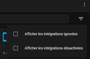

tu as bien ignoré l’installation de Zigbee Home automation (ZHA) ?
C’est la configuration de z2m que je voudrais
Mais comme le souligne @WarC0zes tu sembles ne pas avoir ignoré ZHA dans les intégrations
Peux-tu m’indiquer où je peux trouver la config que tu souhaites, je ne la trouve pas !
Je suis désolé, je débute avec HA et je patauge un peu
J’ai pris grde de NE PAS avoirinstallé ZHA sur cette instance, car je sais que ça peut causer des problèmes avce Z2M.
Z2M fonctionnait correctement jusqu’au changement de box internet, et je n’ai fait aucune modification entre deux. Bonne journée.

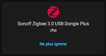

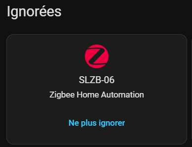

ne pas l’installler est une chose, mais HA détecte automatiquement ta clé zigbee et après un redémarrage, te propose l’installation de ZHA automatiquement. La il faut faire ignoré l’installation, si tu ne le fais pas , il bloquera l’accès a la clé pour Z2M.
Donc est ce que ZHA est bien en ignoré ?
pour le vérifier va dans paramètres/appareils et services/ puis les 3 traits, afficher les intégrations ignorées.
ZHA et bien dans la section « ignorées »
Dans l’onglet configuration de l’addon a côté de l’onglet journal
socat:
  enabled: false
  options: "-d -d"
  log: false
mqtt: {}
serial: {}
saisissez ou collez du code ici
voila qui est plus clair ZERO configuration
on comprends mieux pourquoi ça ne fonctionne pas :wink:
ou est toute la partie port et adapter
tu devrais a mininma avoir
serial:
  port: /dev/serial/by-id/XXXXXXXXXXX
  adapter: zstack
il te faudra juste adapter la partie port a ta configration ?
La partie serial a été « effacée ! »
Du coup j’ai de nouveau tout renseigné
Apès enregistrement et redémarrage voici le journal
[2026-01-28 13:23:27] info: 	z2m: Logging to console, file (filename: log.log)
[2026-01-28 13:23:27] info: 	z2m: Starting Zigbee2MQTT version 2.7.2 (commit #unknown)
[2026-01-28 13:23:27] info: 	z2m: Starting zigbee-herdsman (8.0.1)
[2026-01-28 13:23:27] info: 	zh:zstack:znp: Opening SerialPort with {"path":"/dev/serial/by-id/usb-SMLIGHT_SMLIGHT_SLZB-06_be4c9e0cc0d4ef11b3ce642a49d2c684-if00-port0","baudRate":115200,"rtscts":false,"autoOpen":false}
[2026-01-28 13:23:27] info: 	zh:zstack:znp: Serialport opened
[2026-01-28 13:23:27] info: 	zh:zstack:znp: Writing CC2530/CC2531 skip bootloader payload
[2026-01-28 13:23:29] info: 	zh:zstack:znp: Skip bootloader for CC2652/CC1352
[2026-01-28 13:23:47] error: 	z2m: Error while starting zigbee-herdsman
[2026-01-28 13:23:47] error: 	z2m: Failed to start zigbee-herdsman
[2026-01-28 13:23:47] error: 	z2m: Check https://www.zigbee2mqtt.io/guide/installation/20_zigbee2mqtt-fails-to-start_crashes-runtime.html for possible solutions
[2026-01-28 13:23:47] error: 	z2m: Exiting...
[2026-01-28 13:23:47] error: 	z2m: Error: Failed to connect to the adapter (Error: SRSP - SYS - ping after 6000ms)
Toujours en echec !

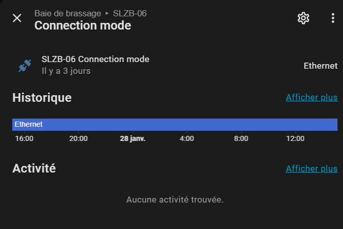

Ma ZLZB-06 est bien reliée en ethernet, mais je viens de rentrer le port USB par erreur (oups!)
C’est peut être une piste
Mais elle semble être tout de même connectée en ethernet!
Alors utilises l’éthernet et pas l’USB c’est quand même le but de ces dongles configures donc z2m en tcp et pas en USB
