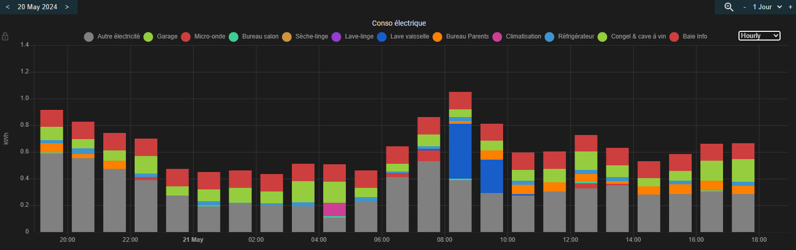

J’ai par exemple ce graphe chez moi:

Tu verras sur le Github qu’il y a de nombreux paramètres pour cette carte. Je te mets ci-dessous mon code si ça peut servir:
type: custom:history-explorer-card
barGraphHeight: 400
defaultTimeRange: 1d
defaultTimeOffset: 1h
showCurrentValues: false
header: hide
uiLayout:
  toolbar: top
  selector: hide
graphs:
  - type: bar
    title: Conso électrique
    options:
      interval: 10m
      stacked: true
      - entity: sensor.autre_electricite
        netBars: true
        color: grey
      - entity: sensor.tz3000_2putqrmw_ts011f_summation_delivered_2
      - entity: sensor.tz3000_2putqrmw_ts011f_summation_delivered_3
      - entity: sensor.tz3000_2putqrmw_ts011f_summation_delivered_4
      - entity: sensor.tz3000_2putqrmw_ts011f_summation_delivered_5
      - entity: sensor.tz3000_2putqrmw_ts011f_summation_delivered_6
      - entity: sensor.tz3000_2putqrmw_ts011f_summation_delivered_7
        name: Lave vaisselle
      - entity: sensor.tz3000_2putqrmw_ts011f_summation_delivered_8
      - entity: sensor.chambre_parents_energie
      - entity: sensor.prise_refrigerateur_summation_delivered_9
      - entity: sensor.prise_congel_et_cave_a_vin_summation_delivered_9
        name: Congel & cave à vin
      - entity: sensor.prise_baie_informatique_summation_delivered
