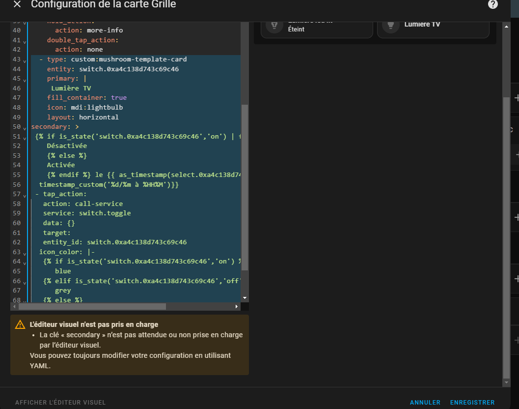

j’ai une erreur que je ne trouve pas voici le code complet
square: false
  - type: custom:mushroom-cover-card
    entity: cover.0x000d6ffffe0870df
    icon: mdi:window-shutter
    show_position_control: true
    show_tilt_position_control: true
    show_buttons_control: true
    primary_info: state
    secondary_info: none
  - type: custom:mushroom-climate-card
    entity: climate.chambre
    icon: mdi:heating-coil
    show_temperature_control: true
    collapsible_controls: true
    hvac_modes:
      - auto
      - heat
      - "off"
    primary_info: state
  - type: custom:mushroom-light-card
    entity: light.0xa4c138e6c7afea82
    icon: mdi:lightbulb-variant
    use_light_color: true
    show_brightness_control: true
    show_color_temp_control: true
    show_color_control: true
    entity: switch.0xa4c138d743c69c46
    primary: |
     Lumière TV
    fill_container: true
    icon: mdi:lightbulb
    layout: horizontal
secondary: >
 {% if is_state('switch.0xa4c138d743c69c46','on') | float == 0 %}
    Désactivée
    Activée
    {% endif %} le {{ as_timestamp(select.0xa4c138d743c69c46_indicator_mode) |
  timestamp_custom('%d/%m à %HH%M')}}
 - tap_action:
   service: switch.toggle
   data: {}
   entity_id: switch.0xa4c138d743c69c46
  icon_color: |-
   {% if is_state('switch.0xa4c138d743c69c46','on') %}
      blue
   {% elif is_state('switch.0xa4c138d743c69c46','off') %}
      grey
      red
columns: 2
je bug sur le code
    primary: |
     Lumière TV
    icon: mdi:lightbulb
    layout: horizontal
secondary: >
    Désactivée
    Activée
 - tap_action:
   data: {}
  icon_color: |-
      blue
      grey
      red
columns: 2
code copier ici
quand je l’utilise seul tout fonctionne, la les couleurs d’etat fonction pas.
une idée ?
merci
une mauvaise indentation, de secondary, tap_action et icon_color:
    primary: |
      Lumière TV
    icon: mdi:lightbulb
    layout: horizontal
    secondary: >
      Désactivée
      Activée le {{ as_timestamp(select.0xa4c138d743c69c46_indicator_mode) |timestamp_custom('%d/%m à %HH%M')}}
    icon_color: |-
      blue
      grey
      red
      data: {}
Super merci :smiling_face_with_three_hearts:
