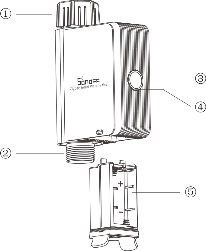

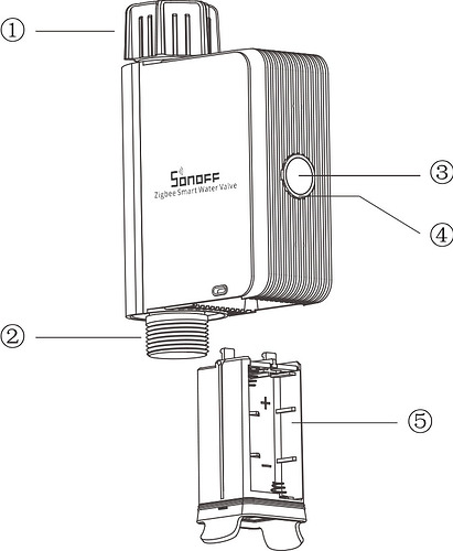

voici la procédure :
① Inlet
② Outlet
③ Button
• Single press: Turn on/off the smart device.
• Press and hold for 5 seconds: The device enters the pairing mode.
④ LED indicator (Green)
• Steady on: Normal connection with the gateway.
• Slow flash: The device is in pairing mode.
• Fast flash: Abnormal connection with the gateway.
⑤ Battery slot
Bouton 3, Maintenez la pression pendant 5 secondes : l’appareil passe en mode de couplage.
