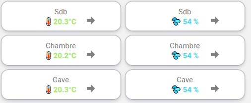

et le résultat donne cela

J’ai eu un petit soucis avec le nom de mon sensor qui été trop long au lieu d’être binary_sensor.exemple_augmentation/diminution été binary_sensor.exemple_exemple_augmentation/diminution.
J’ai modifié le code pour qu’il soit compatible dans la partie notification:
Code modifié:
        custom_fields:
          notification: |
                const entityid = entity.entity_id
                const augmentation = entityid.replace(/^(.+)\.(.+)_augmentation$/, 'binary_sensor.$2_augmentation');
                const diminution = entityid.replace(/^(.+)\.(.+)_diminution$/, 'binary_sensor.$2_diminution');
                if (states[augmentation].state == 'on')
                  return  `<ha-icon
                            icon="mdi:arrow-top-right-thick"
                            style="width: 25px; height: 25px; color: var(--text-color); ">
                            </ha-icon>`
                else if (states[diminution].state == 'on')
                  return `<ha-icon
                            icon="mdi:arrow-bottom-right-thick"
                            </ha-icon>`
                else return `<ha-icon
                            icon="mdi:arrow-right-bold"
                            </ha-icon>`
Code complet du template:
####    TREND BUTTON TEMP
  trendtemp:
        show_state: true
        show_name: true
        show_icon: false
        state_display: >
            if (entity.attributes.unit_of_measurement === '°C')
              return (Math.round(entity.state*10)/10) + (entity.attributes.unit_of_measurement);
            else
              return (Math.round(entity.state)) + " " + (entity.attributes.unit_of_measurement);
        styles:
          custom_fields:
            notification:
              - border-radius: 50%
              - position: absolute
              - left: 70%
              - top: 40%
          name:
            - font-size: 0.9em
          state:
            - font-size: 0.9em
            - font-weight: bold
            - color: >
                  const MIN_TEMP = 5;
                  const MAX_TEMP = 30;
                  const MIN_HR = 0;
                  const MAX_HR = 100;
                  const STATE = entity.state;
                  const DEVICE_CLASS = entity.attributes.device_class;
                  let hue = 0; // initialisation de la variable hue
                  let color;
                  if (DEVICE_CLASS  === 'temperature') {
                    if (STATE <= MIN_TEMP) {
                      hue = 240;
                    else if (STATE >= MAX_TEMP) {
                      hue = 0;
                    else {
                      hue = 240 - ((STATE - MIN_TEMP) / (MAX_TEMP - MIN_TEMP)) * 240;
                    color = `hsl(${hue}, ${Math.sqrt((STATE - MIN_TEMP) / (MAX_TEMP - MIN_TEMP)) * 100}%, ${(STATE - MIN_TEMP) / (MAX_TEMP - MIN_TEMP) * 85 + 15}%)`;
                  else if (DEVICE_CLASS === 'humidity') {
                    if (STATE < MIN_HR) {
                      color = 'pink';
                    } else if (STATE > MAX_HR) {
                      color = 'purple';
                    } else {
                      color = `hsl(${(STATE - MIN_HR) * 3.42}, ${Math.sqrt((STATE - MIN_HR) / (MAX_HR - MIN_HR)) * 100}%, ${(STATE - MIN_HR) / (MAX_HR - MIN_HR) * 85 + 15}%)`;
                  else if (DEVICE_CLASS  === 'carbon_dioxide') {
                    if (STATE < 1000) {
                      color = 'green';
                    } else if (STATE < 1530) {
                      color = 'orange';
                    } else {
                      color= 'red';
                  else {
                    color = 'var(--text-color)'; // on peut également mettre un autre couleur ici si besoin
                  return color;
          grid:
            - position: relative
        custom_fields:
          notification: |
                  return  `<ha-icon
                            </ha-icon>`
                  return `<ha-icon
                            </ha-icon>`
                            </ha-icon>`
J’ai ajouter ma touche perso avec des emoji mais j’aimerai afficher dans une carte température et juste en dessous humidité mais je n’y arrive pas.
Penses-tu que c’est faisable @papoo
    state_display: >
          return "🌡️ " + (Math.round(entity.state*10)/10) + (entity.attributes.unit_of_measurement);
        else if (entity.attributes.unit_of_measurement === '%')
          return "💦 " + (Math.round(entity.state)) + " " + (entity.attributes.unit_of_measurement);
        else
Ce doit être faisable, mais la difficulté va être de réussir à aligner le tout
