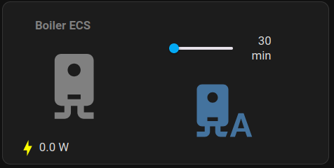

Je peux aussi le déclencher manuellement (ON/OFF)
Ou encore, via un input_number (pour le temps de relance) ,un script et une carte effectuer une relance (entre 30 et 120 min) au cas ou nous aurions consommé l’eau chaude.
type: custom:button-card
entity: switch.boiler
icon: mdi:water-boiler
aspect_ratio: 2/1
styles:
  name:
    - font-weight: bold
    - position: absolute
    - left: 10%
    - top: 10%
    - animation: |
          if (states['switch.boiler'].state == 'on') return "blink 1s infinite";
    - color: |
          if (states['switch.boiler'].state == 'on') return "red";
          return "gray";
  img_cell:
    - justify-content: start
    - align-items: start
    - margin: none
    - align-self: stretch
    - text-align: stretch
    - left: 10%
    - top: 22%
    - width: 60%
    - height: 60%
  icon:
    - animation: |
          if (states['switch.boiler'].state == 'on') return "blink 1s linear infinite";
    - color: |
          return "gray";
  custom_fields:
    puissance:
      - left: 5%
      - top: 85%
    tempsrelance:
      - left: 50%
      - top: 20%
    relance:
      - left: 40%
      - top: 40%
custom_fields:
  tempsrelance:
    card:
      type: custom:slider-entity-row
      entity: input_number.temps_relance_boiler
      full_row: true
      hide_state: false
    overflow: unset
  relance:
    card:
      entity: script.relance_boiler
      icon: mdi:water-boiler-auto
      card_mod:
        style: |
          ha-card {
            border: none;
            background: none;
      show_name: false
      hold_action:
        action: call-service
        service: script.toggle
        service_data:
          entity_id: script.manu_extract_sdb
  puissance: |
      return `<ha-icon
        icon="mdi:lightning-bolt"
        style="width: 25px; height: 25px; color: yellow;">
        </ha-icon><span> ${states['sensor.boiler_power'].state} W </span>`
