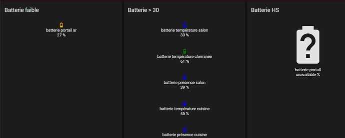

bonjour,
un petit mots sur un addons HACS > custom:auto-entities.
ce vous partage ce code, il faut bien sure que vos entités soit nommés batterie ou battery (dans mon cas)
type: grid
  - type: 'custom:auto-entities'
    card:
      title: Batterie faible
      type: entities
    filter:
      include:
        - domain: sensor
          entity_id: '*battery*'
          state: <= 30
          options:
            type: 'custom:button-card'
            color_type: icon
            show_name: true
            show_state: true
            state:
              - value: '20'
                operator: '>'
                color: orange
              - value: '20'
                operator: <
                color: red
    card:
      title: Batterie > 30
      type: entities
    filter:
      include:
        - domain: sensor
          state: '> 30'
          options:
            color_type: icon
            show_name: true
            show_state: true
            state:
              - value: '50'
                operator: '>='
                color: green
              - value: '50'
                operator: <
                color: blue
    card:
      title: Batterie HS
      type: entities
    filter:
      include:
        - domain: sensor
          state: unavailable
          options:
            color_type: icon
            show_name: true
            show_state: true
