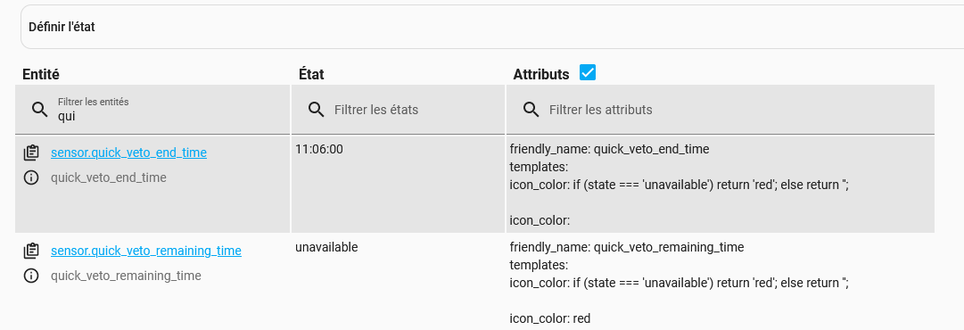

Ba, en fait je voulais le temps restant donc ce sensor moins le temps actuel
- platform: template
sensors:
quick_veto_end_time:
friendly_name: "Quick veto end time"
value_template: >
{{ state_attr('climate.zone_0', 'quick_veto_end_date_time') | regex_replace('T', ' ') | regex_replace('\.\d+$', '') | regex_replace('^.* ', '') }}
quick_veto_remaining_time:
friendly_name: "Quick veto remaining time"
value_template: >
{% set end_time = strptime(state_attr('climate.zone_0', 'quick_veto_end_date_time'), '%Y-%m-%dT%H:%M:%S') %}
{% set remaining_time = (end_time - now()).total_seconds() %}
{% set hours = ((remaining_time // 3600) % 24) %}
{% set minutes = ((remaining_time // 60) % 60) %}
{% set seconds = (remaining_time % 60) %}
{{ '%02d:%02d:%02d' | format(hours, minutes, seconds) }}

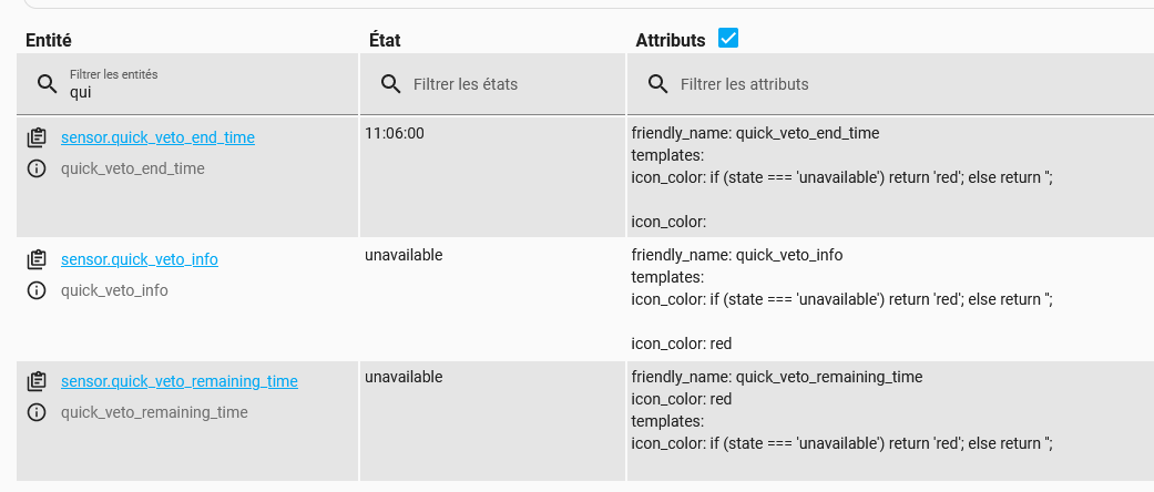

Au cas où
sensor:
sensors:
quick_veto_info:
friendly_name: "Quick veto info"
value_template: >
{% set end_time = state_attr('climate.zone_0', 'quick_veto_end_date_time') | regex_replace('T', ' ') | regex_replace('\.\d+$', '') | regex_replace('^.* ', '') %}
{% set remaining_minutes = ((as_timestamp(end_time) - now().timestamp()) / 60) | int %}
Quick Veto ends at {{ end_time }} (in {{ remaining_minutes }} minutes)
le deuxième
ne fonctionne pas non plus.
On va tenter de convertir en date Time
{% set end_time_str = state_attr('climate.zone_0', 'quick_veto_end_date_time') | regex_replace('T', ' ') | regex_replace('\.\d+$', '') %}
{% set end_time = strptime(end_time_str, '%Y-%m-%d %H:%M:%S') %}
{% set remaining_time = end_time - now() %}
Temps restant : {{ remaining_time.seconds // 3600 }}h {{ (remaining_time.seconds % 3600) // 60 }}m {{ remaining_time.seconds % 60 }}s

Aucune ne fonctionne, mais sur la dernière tu ecrit {% set end_time = strptime(end_time_str, '%Y-%m-%dT%H:%M:%S') %}
alors qu’il n’y apas de « T » dans le résultat. Et cette ligne bloque dans modele:
ValueError: Template error: strptime got invalid input '2023-04-25 17:13:00' when rendering template '{% set end_time_str = state_attr('climate.zone_0', 'quick_veto_end_date_time') %}
