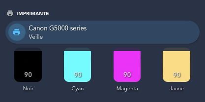

J’ai fait ca
Pour les jauges, un decluttering :
printer:
type: custom:bar-card
- entity: '[[entity]]'
color: '[[color]]'
entity_row: true
direction: up
unit_of_measurement: []
max: 100
positions:
value: inside
indicator: inside
height: 70px
width: 60%
icon: 'off'
bar-card-card {
margin-bottom: -50px;
bar-card-name {
margin-right: 15px;
font-size: 11px;
font-weight: ;
color: var(--text-on);
filter: drop-shadow(0px 2px 2px rgba(0,0,0,0.9));
bar-card-value {
margin-left: 5px;
font-size: 13px;
font-weight: bold;
color: var(--text-off);
filter: drop-shadow(1px 1px 1px rgba(0,0,0,1));
Et pour les afficher :

Top @herveaurel ta méthode, j’étais déja sur l’autre option, merci pour ton partage.
bar-card-card:nth-child(2) > bar-card-background > bar-card-contentbar > bar-card-value {
color: black
bar-card-card:nth-child(3) > bar-card-background > bar-card-contentbar > bar-card-value {
color: black
bar-card-card:nth-child(4) > bar-card-background > bar-card-contentbar > bar-card-value {
color: black
title: null
direction: up
columns: 5
min: 0
max: 100
target: 25
height: 120px
width: 100%
unit_of_measurement: '%'
decimal: '0'
icon: mdi:water
positions:
icon: 'off'
indicator: 'off'
minmax: 'off'
value: inside
- entity: input_number.novaprint_last_black_ink
color: rgb(30,30,30)
- entity: input_number.novaprint_last_cyan_ink
color: MediumTurquoise
- entity: input_number.novaprint_last_magenta_ink
color: MediumOrchid
- entity: input_number.novaprint_last_yellow_ink
color: Gold
- entity: input_number.novaprint_last_photo_ink
Comment tu fais pour avoir les bords arrondis? J’ai essayé plusieurs choses mais ça ne fonctionne pas ! Merci ![]()

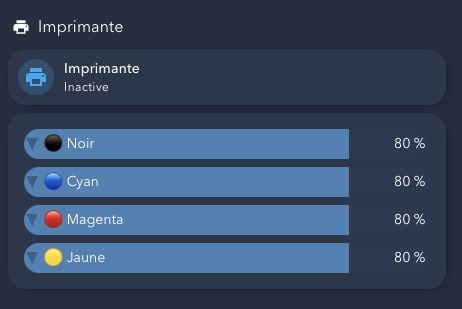

- entity: sensor.canon_g5000_series_black_pgbk
- entity: sensor.canon_g5000_series_cyan
- entity: sensor.canon_g5000_series_magenta
- entity: sensor.canon_g5000_series_yellow
entity_row: false
positions:
icon: "off"
indicator: inside
direction: right
height: 30px
stack: vertical
min: 0
max: 100
severity:
- color: red
from: 0
to: 30
- color: orange
from: 31
to: 50
- color: steelblue
from: 51
to: 100
Top merci ! Je vais l’insérer dans mon Dashboard ![]()
Je n’arrive pas au même résultat et n’ai pas l’entité générale de l’imprimante au-dessus. Je continue de chercher ![]()
