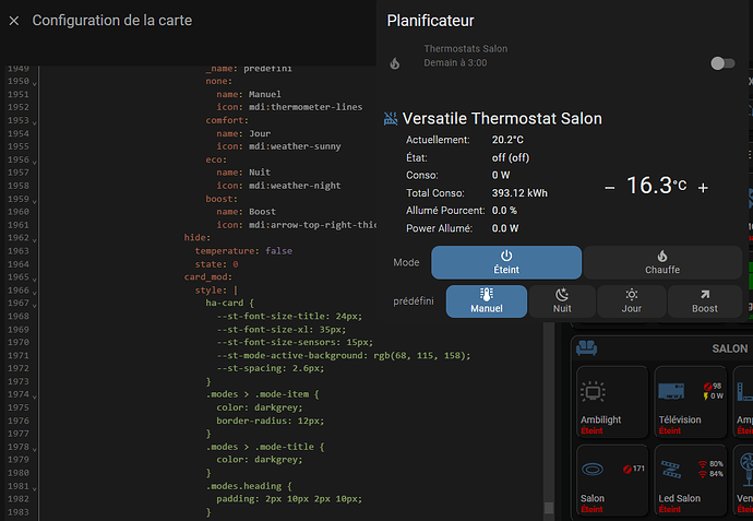

exemple de ma configue:
type: custom:simple-thermostat
entity: climate.versatile_thermostat_salon
step_size: "0.1"
sensors:
  - entity: sensor.0x54ef44100050f9c3_power
  - entity: sensor.0x54ef44100050f9c3_energy
  - entity: sensor.versatile_thermostat_salon_power_percent
  - entity: >-
      sensor.versatile_thermostat_salon_mean_power_cycle
layout:
  step: row
  mode:
    headings: true
    icons: true
    names: true
header: {}
control:
  hvac:
    _name: Mode
    "off":
    heat:
  preset:
    _name: prédéfini
    none:
      icon: mdi:thermometer-lines
    comfort:
      icon: mdi:weather-sunny
    eco:
      icon: mdi:weather-night
    boost:
      icon: mdi:arrow-top-right-thick
hide:
  temperature: false
  state: 0
card_mod:
  style: |
    ha-card {
      --st-font-size-title: 24px;
      --st-font-size-xl: 35px;
      --st-font-size-sensors: 15px;
      --st-mode-active-background: rgb(68, 115, 158);
      --st-spacing: 2.6px;
    .modes > .mode-item {
      color: darkgrey;
      border-radius: 12px;
    .modes > .mode-title {
      color: darkgrey;
    .modes.heading {
      padding: 2px 10px 2px 10px;

Si tu regardes bien ma capture, au niveau de l’état j’ai une icône que je colore si les radiateurs chauffent.
Côté card_mod ça donne ça :
      card_mod:
        style: |
          div.sensors.with-labels.as-table > div:nth-child(4) > ha-icon {
          {% if state_attr(config.entity, 'hvac_action') == 'idle' %}
            color: white;
          {% elif state_attr(config.entity, 'hvac_action') == 'heating' %}
            color: coral;
            color: slategrey;
Tu peux t’en inspirer :wink:
