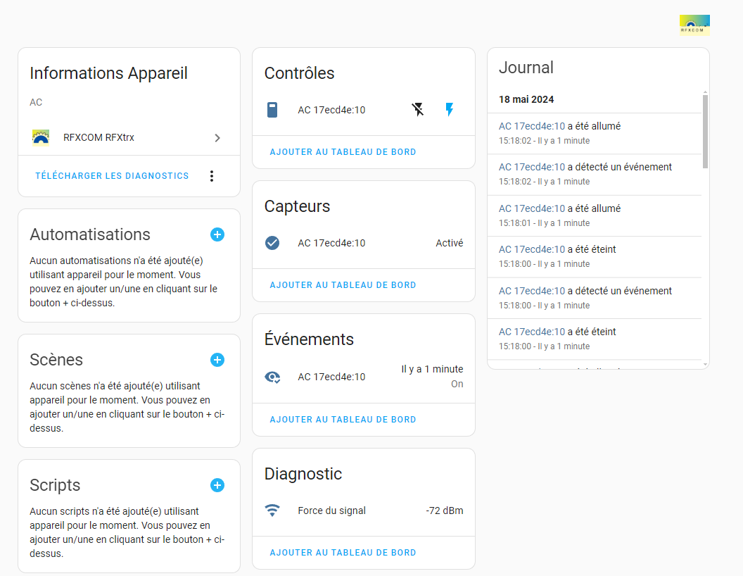

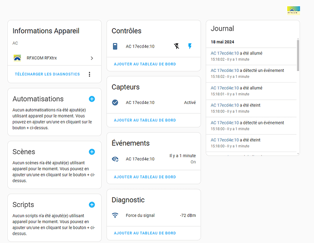

Bon, en activant la découverte automatique, le détecteur a été trouvé à priori :
Le protocole est « ac »
Oui c’est ce que je pensai effectivement, du 0x11 0x00
2024-05-18 13:50:50.115 DEBUG (Thread-2 (_connect)) [RFXtrx] Recv: 0x0b 0x11 0x00 0x9c 0x00 0xa2 0xd1 0xba 0x0a 0x01 0x0f 0x60
2024-05-18 13:50:50.117 DEBUG (MainThread) [homeassistant.components.rfxtrx] Receive RFXCOM event: {'packet_type': 17, 'sub_type': 0, 'type_string': 'AC', 'id_string': '0a2d1ba:10', 'data': '0b11009c00a2d1ba0a010f60', 'values': {'Command': 'On', 'Rssi numeric': 6}}
2024-05-18 13:50:50.130 DEBUG (MainThread) [homeassistant.components.rfxtrx.binary_sensor] Binary sensor update (Device ID: 0a2d1ba:10 Class: LightingDevice Sub: 0)
2024-05-18 13:50:50.142 DEBUG (MainThread) [homeassistant.components.rfxtrx.sensor] Sensor update (Device ID: 0a2d1ba:10 Class: LightingDevice Sub: 0)
2024-05-18 13:51:52.337 DEBUG (Thread-2 (_connect)) [RFXtrx] Recv: 0x0b 0x11 0x00 0x9d 0x00 0xa2 0xd1 0xba 0x0a 0x00 0x00 0x60
2024-05-18 13:51:52.339 DEBUG (MainThread) [homeassistant.components.rfxtrx] Receive RFXCOM event: {'packet_type': 17, 'sub_type': 0, 'type_string': 'AC', 'id_string': '0a2d1ba:10', 'data': '0b11009d00a2d1ba0a000060', 'values': {'Command': 'Off', 'Rssi numeric': 6}}
2024-05-18 13:51:52.353 DEBUG (MainThread) [homeassistant.components.rfxtrx.binary_sensor] Binary sensor update (Device ID: 0a2d1ba:10 Class: LightingDevice Sub: 0)
2024-05-18 13:51:52.366 DEBUG (MainThread) [homeassistant.components.rfxtrx.sensor] Sensor update (Device ID: 0a2d1ba:10 Class: LightingDevice Sub: 0)
2024-05-18 13:51:53.585 DEBUG (Thread-2 (_connect)) [RFXtrx] Recv: 0x0b 0x11 0x00 0x9e 0x00 0xa2 0xd1 0xba 0x0a 0x00 0x00 0x60
2024-05-18 13:51:53.587 DEBUG (MainThread) [homeassistant.components.rfxtrx] Receive RFXCOM event: {'packet_type': 17, 'sub_type': 0, 'type_string': 'AC', 'id_string': '0a2d1ba:10', 'data': '0b11009e00a2d1ba0a000060', 'values': {'Command': 'Off', 'Rssi numeric': 6}}
2024-05-18 13:51:53.598 DEBUG (MainThread) [homeassistant.components.rfxtrx.binary_sensor] Binary sensor update (Device ID: 0a2d1ba:10 Class: LightingDevice Sub: 0)
2024-05-18 13:51:53.611 DEBUG (MainThread) [homeassistant.components.rfxtrx.sensor] Sensor update (Device ID: 0a2d1ba:10 Class: LightingDevice Sub: 0)

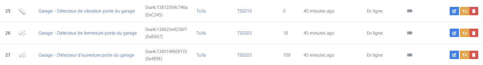

J’ai du zigbee un peu partout avec des routeurs de tous les côtés mais en dépit de celà, j’ai des LQI merdiques pour des appareils placés dans un même périmètre (avec des piles neuves) :
Là par exemple, j’ai le détecteur de vibration qui a un LQI de 0 (et il fonctionne quand même) alors que le détecteur d’ouverture qui est situé à 2 mètres du détecteur de vibration a un LQI de 109…
les 3 détecteurs sont à moins de 5 mètres d’un Aeotec Range Extender

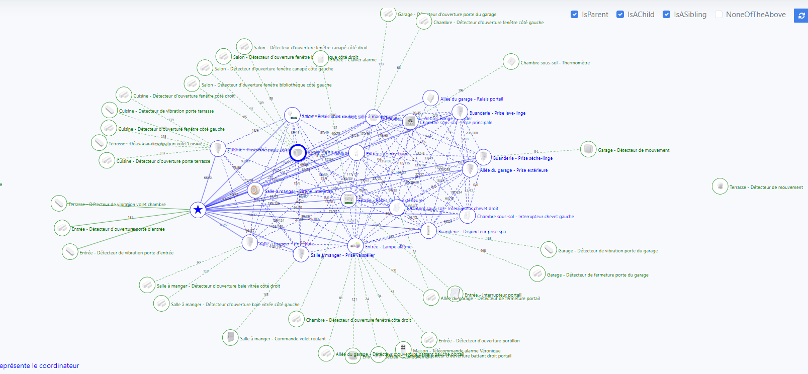

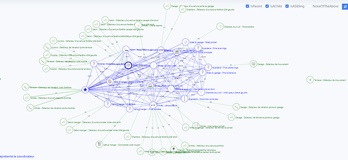

Sur le shéma, les LQI sont complètement différents :
