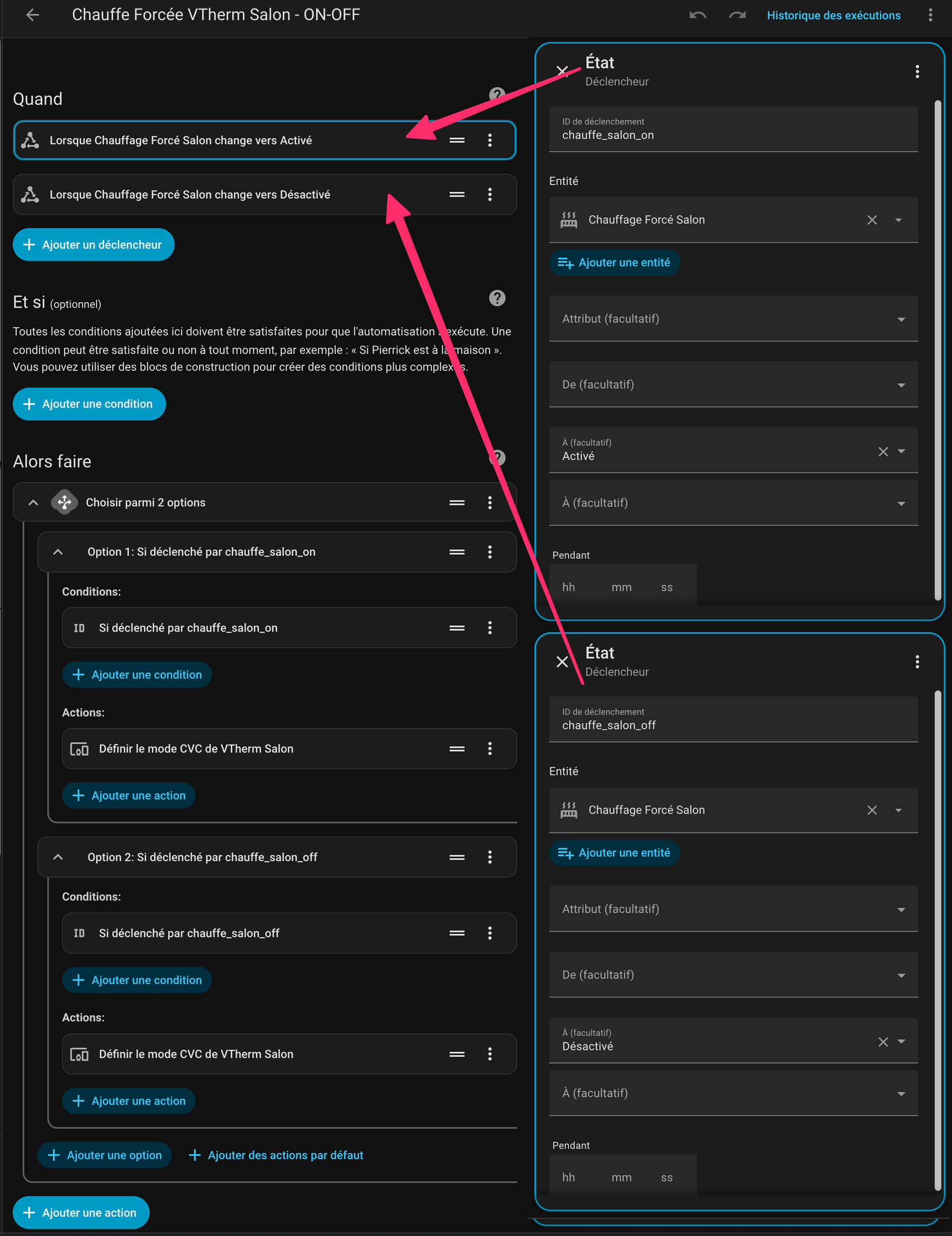

J’ai bien réussi à faire ^^
voilà le code yaml :
alias: Chauffe Forcée VTherm Salon - ON-OFF
description: ""
triggers:
  - trigger: state
    entity_id:
      - input_boolean.chauffage_force_salon
    to:
      - "on"
  - trigger: state
    entity_id:
    to:
      - "off"
conditions: []
actions:
  - choose:
      - conditions:
          - condition: trigger
            id:
              - chauffe_salon_on
        sequence:
          - device_id: 901b7dcb2eaa6313d1b3910c5e358972
            domain: climate
            entity_id: e584c68692ed499b1d9d111ac5d86d37
            type: set_hvac_mode
            hvac_mode: heat
      - conditions:
            id:
              - chauffe_salon_off
        sequence:
            domain: climate
            type: set_hvac_mode
            hvac_mode: "off"

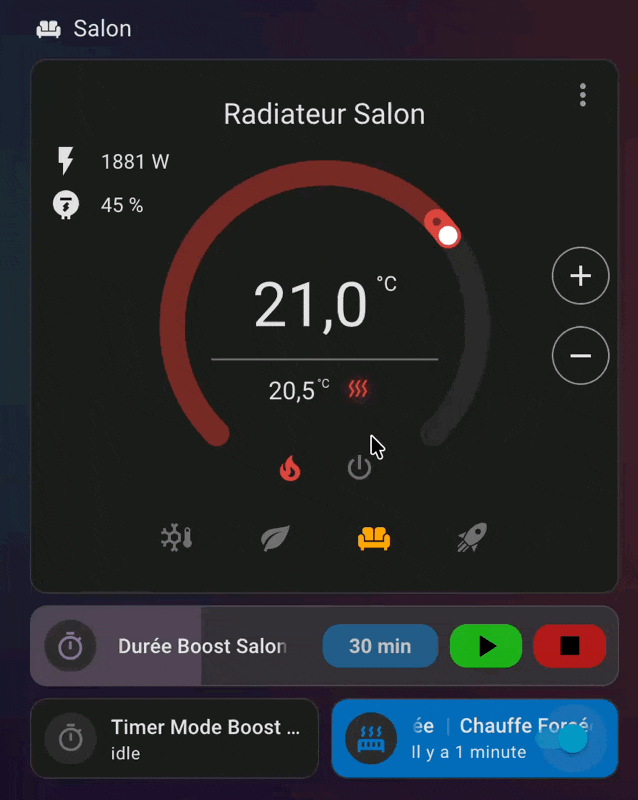

Et ça fonctionne bien :wink:
CleanShot 2025-11-25 at 11.03.20

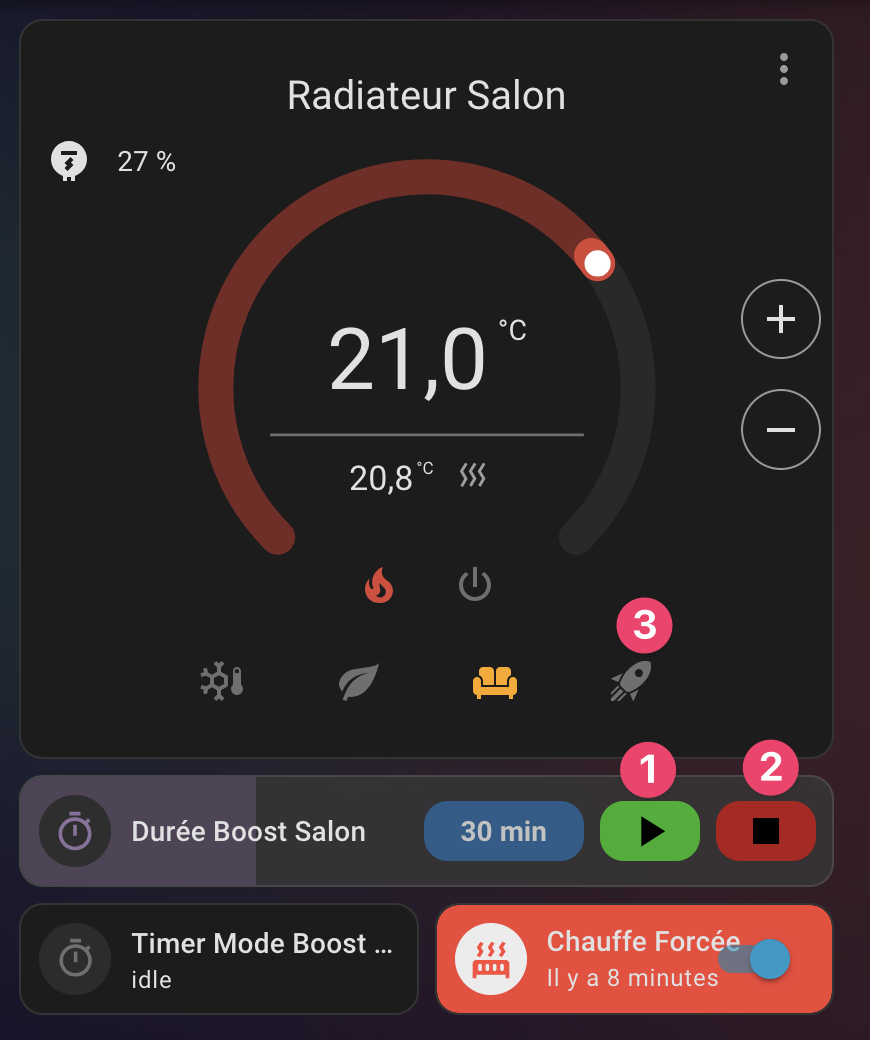

type: custom:bubble-card
card_type: button
entity: input_number.boost_duration_vtherm_salon
button_type: slider
name: Durée Boost Salon
sub_button:
  - entity: input_number.boost_duration_vtherm_salon
    show_icon: false
    show_state: true
    show_attribute: false
    attribute: mode
    tap_action:
      action: none
    state_background: true
    show_background: true
  - name: Start
    icon: mdi:play
    tap_action:
      action: call-service
      service: script.timer_boost_salon_start_script_ui
      target: {}
  - name: Stop
    icon: mdi:stop
    tap_action:
      target: {}
      service: script.timer_boost_salon_stop_script_ui
grid_options:
  columns: 12
  rows: 1
tap_action:
  action: none
styles: |-
  .bubble-icon {
    color:  rgba(126, 104, 143, 1) !important;
  .bubble-button-card-container {
    background: rgba(55,55,55,0.8) !important;
  .bubble-range-fill {
    background: rgba(79, 69, 87, 1) !important;
    opacity: 1 !important;
  .bubble-sub-button-1 {
    background-color: rgba(0, 148, 255, 0.5) !important;
    height: 30px !important;
    min-width: 80px !important;
    font-size: 14px !important;
    font-weight: bold !important;
  .bubble-sub-button-2 {
    background-color: rgba(0, 255, 0, 0.75) !important;
    width: 50px !important;
  .bubble-sub-button-2 > ha-icon {
    color: rgba(0, 0, 0, 1) !important;
  .bubble-sub-button-3 > ha-icon {
  .bubble-sub-button-icon {
    --mdc-icon-size: 26px !important;
  .bubble-sub-button-3 {
    background-color: rgba(255, 0, 0, 0.75) !important;
modules:
  - default
double_tap_action:
  action: none
hold_action:
  action: none
button_action:
  tap_action:
    action: none
Il te faudra les bubble card :slight_smile:

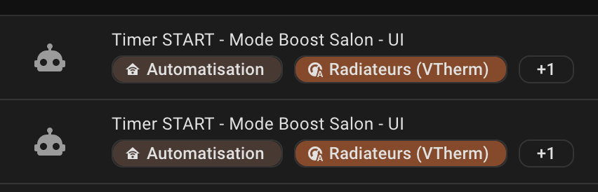

Mais j’ai fusionné les deux automatisation START et STOP qui se déclenchaient quand on appuyait sur le bouton boost du VTherm.
alias: Timer START-STOP - Mode Boost Salon - UI
description: ""
triggers:
  - trigger: state
    entity_id:
      - climate.vtherm_salon
    attribute: preset_mode
    to: boost
  - trigger: state
    entity_id:
    from:
      - boost
  - trigger: state
    entity_id:
      - timer.boost_timer_vtherm_salon
    enabled: true
    to:
      - idle
  - trigger: state
    entity_id:
    enabled: true
    to:
      - unavailable
conditions: []
actions:
  - choose:
      - conditions:
            id:
              - Boost_START
        sequence:
          - action: script.turn_on
            metadata: {}
            data: {}
              entity_id: script.timer_boost_salon_start_script_ui
      - conditions:
            id:
              - Boost_STOP
              - Boost_STOP_TIMER
        sequence:
            metadata: {}
            data: {}
              entity_id: script.timer_boost_salon_stop_script_ui

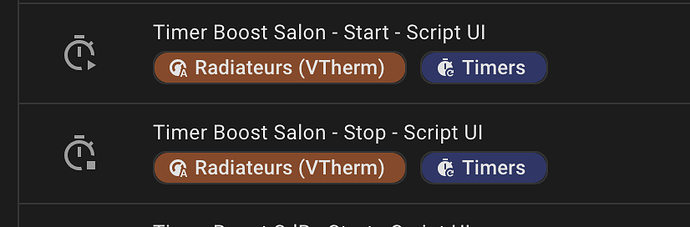

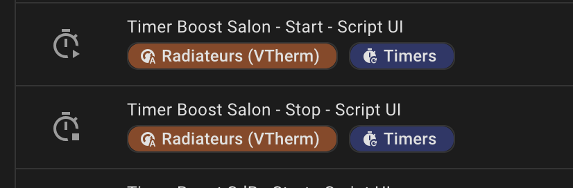

J’en ai profité pour ajouter dans le script de stop une partie qui vérifie si le bouton chauffe forcé est à ON ou OFF. Si c’est ON, on laisse sur « heat », sinon on passe sur « éteint ».
Les scripts peuvent être fusionnés mais comme il n’ont pas de trigger il faut leur envoyer une variable qui change selon ce qui appelle le script.
Cette variable devient en quelque sorte un trigger_id
