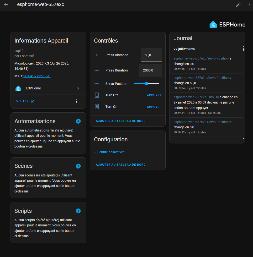

mon code yaml :
esphome:
  friendly_name: esphome-web-657e2c
  min_version: 2025.5.0
  name_add_mac_suffix: false
esp8266:
  board: esp12e
# Enable logging
logger:
# Enable Home Assistant API
api:
# Allow Over-The-Air updates
ota:
  - platform: esphome
wifi:
  ssid: "********"
  password: "********"
output:
  - platform: esp8266_pwm
    pin: GPIO14
    frequency: 50 Hz
servo:
  - id: my_servo
    output: pwm_output
number:
  - platform: template
    name: "Servo Position"
    min_value: -100
    initial_value: 0
    max_value: 100
    step: 1
    optimistic: true
    set_action:
      then:
        - servo.write:
            level: !lambda "return x / 100.0;"
    name: "Press Duration"
    min_value: 200
    initial_value: 500
    max_value: 5000
    step: 100
    mode: box
    optimistic: true
    name: "Press Distance"
    min_value: 0
    initial_value: 60
    max_value: 100
    step: 1
    mode: box
    optimistic: true
button:
    icon: "mdi:light-switch"
    on_press:
      - number.set:
          value: !lambda "return id(press_distance).state;"
      - delay: !lambda "return id(press_duration).state;"
      - number.set:
          value: 0
    icon: "mdi:light-switch-off"
    on_press:
      - number.set:
          value: !lambda "return id(press_distance).state * -1;"
      - number.set:
          value: 0
Bon je pense avoir compris, j’ai commandé des versions 360° au lieu de 180°…
