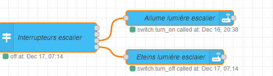

Même si Golfvert m’a donné la solution. Je relance le sujet car j’ai quelques petits bugs.
Je voulais vérifier avec vous si j’ai bien compris l’explication de Golfvert.
Je vous joint le flux créé.
Capture d'écran 2023-12-17 093306
[{"id":"b92e7095f69ccffd","type":"api-call-service","z":"e81d425f7e8899f8","name":"Allume lumière escalier","server":"66fa8575.19001c","version":5,"debugenabled":false,"domain":"switch","service":"turn_on","areaId":[],"deviceId":[],"entityId":["switch.lumieres_escalier"],"data":"","dataType":"jsonata","mergeContext":"","mustacheAltTags":false,"outputProperties":[],"queue":"none","x":370,"y":220,"wires":[[]]},{"id":"60bec97f9cc9b7e1","type":"api-call-service","z":"e81d425f7e8899f8","name":"Eteins lumière esclaier","server":"66fa8575.19001c","version":5,"debugenabled":false,"domain":"switch","service":"turn_off","areaId":[],"deviceId":[],"entityId":["switch.lumieres_escalier"],"data":"","dataType":"jsonata","mergeContext":"","mustacheAltTags":false,"outputProperties":[],"queue":"none","x":360,"y":300,"wires":[[]]},{"id":"41778f16cbfc064a","type":"trigger-state","z":"e81d425f7e8899f8","name":"Interrupteurs escalier","server":"66fa8575.19001c","version":4,"inputs":0,"outputs":4,"exposeAsEntityConfig":"","entityId":["switch.sonoff_10016fe8b0_1","switch.sonoff_10016fe8a6_2"],"entityIdType":"list","debugEnabled":false,"constraints":[],"customOutputs":[{"messageType":"default","messageValue":"","messageValueType":"json","comparatorPropertyType":"current_state","comparatorPropertyValue":"new_state.state","comparatorType":"is","comparatorValue":"on","comparatorValueDataType":"str"},{"messageType":"default","messageValue":"","messageValueType":"json","comparatorPropertyType":"current_state","comparatorPropertyValue":"new_state.state","comparatorType":"is","comparatorValue":"off","comparatorValueDataType":"str"}],"outputInitially":true,"stateType":"str","enableInput":false,"x":100,"y":260,"wires":[[],[],["b92e7095f69ccffd"],["60bec97f9cc9b7e1"]]},{"id":"66fa8575.19001c","type":"server","name":"Home Assistant","addon":true,"rejectUnauthorizedCerts":true,"ha_boolean":"","connectionDelay":false,"cacheJson":true,"heartbeat":false,"heartbeatInterval":"","statusSeparator":"","enableGlobalContextStore":false}]
Le problème que je rencontre:
C’est que de temps en temps, j’ai les interrupteurs qui font un va et vient en permanence sans s’arrêter (genre guirlande de noël).
Merci pour vos retours.
