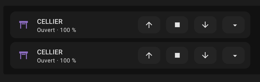

Custom carte cover de mushroom / template
Carte « pile verticale », de base dans HA.

ou custom Vertical Stack In Card (via HACS), avec un rendu différent

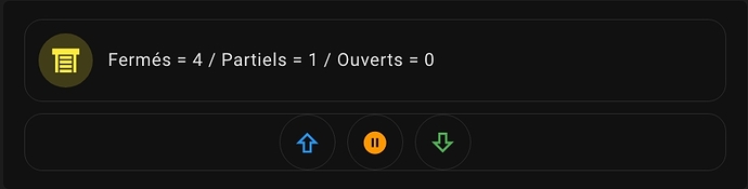

Je n’arrive pas a modifier les couleurs en fonction de la position des volets
Je m’y prends surement mal
Une idée ?
type: vertical-stack
    primary: Volets de la maison
    multiline_secondary: true
    secondary: >-
      {% set all = expand('cover.tous_les_volets'|lower) -%} {% set positions =
      all | map(attribute='attributes.current_position')|list-%} {% set moving =
      all | selectattr('state', 'in', ['opening','closing'])|list|count -%} {%
      set open = positions | reject("!=",100) |list |count -%} {% set closed =
      positions | reject("!=",0) |list |count -%} {% set other =
      positions|list|count - open - closed - moving -%} Fermés = {{ closed }} /
      Partiels = {{ other }} / Ouverts = {{ open }} {% if moving > 0 -%} /
      Actifs = {{ moving }}{% endif %}
    icon: mdi:window-shutter
    icon_color: >-
      {% if closed == all|count %} green {% elif open == all|count %} blue {%
      elif moving > 0 %} orange {% else %} yellow {% endif %}
    layout: horizontal
    fill_container: true
  - type: entities
      - entity: cover.tous_les_volets
        secondary_info: last-changed
    grid_options:
      columns: 11
      rows: 1

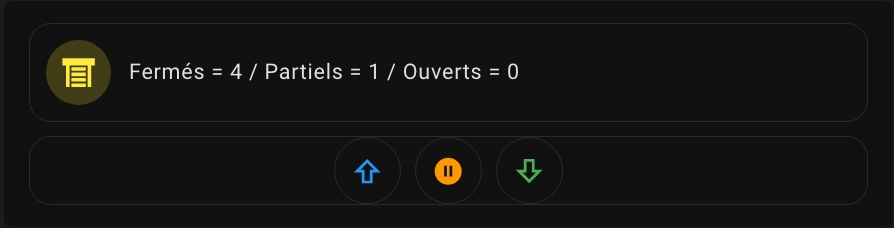

Finalement j’ai trouvé une piste qui fonctionne. Ci dessous le code
    secondary: >-
      {% set all = expand('cover.tous_les_volets') %} {% set positions = all |
      map(attribute='attributes.current_position') | list %} {% set moving = all
      | selectattr('state', 'in', ['opening','closing']) | list | count %} {%
      set open = positions | select('eq', 100) | list | count %} {% set closed =
      positions | select('eq', 0) | list | count %} {% set other = positions |
      list | count - open - closed - moving %} Fermés = {{ closed }} / Partiels
      = {{ other }} / Ouverts = {{ open }} {% if moving > 0 %} / Actifs = {{
    icon_color: >-
      positions | select('eq', 0) | list | count %} {% if closed == all | count
        green
      {% elif open == all | count %}
        blue
      {% elif moving > 0 %}
        orange
        yellow
    layout: horizontal
  - type: custom:mushroom-chips-card
    chips:
      - type: action
        icon: mdi:arrow-up-bold-outline
        icon_color: blue
        tap_action:
          action: call-service
          service: cover.open_cover
            entity_id: cover.tous_les_volets
      - type: action
        icon: mdi:pause-circle
        icon_color: orange
        tap_action:
          service: cover.stop_cover
      - type: action
        icon: mdi:arrow-down-bold-outline
        icon_color: green
        tap_action:
          service: cover.close_cover
    alignment: center
Par contre le rendu est pas top. Je n’arrive pas à mettre le rectangle autour de la carte chips
Une idée ?

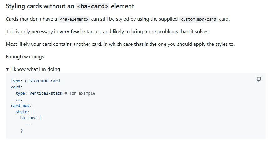

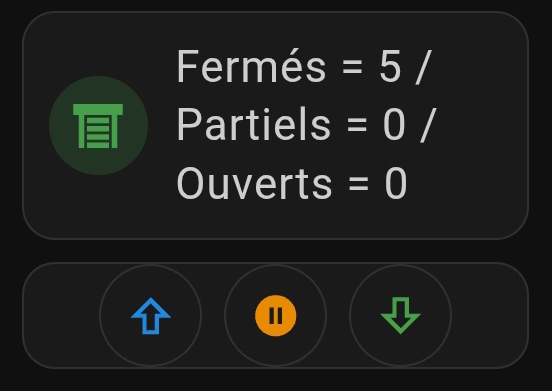

utilise custom:mod-card pour ajouter un style à la carte mushroom-chips-card :
voila le code et le rendu , je ne sais pas si c’est vraiment ce que tu cherche a faire.

bonsoir
merci pour ta reponse
Ce que je voudrais c’est exactement ce que tu me propose mais chez moi ca ne fonctionne pas
Ni chrome , ni firefox ni chrome android. Pas ce “rectangle” autour du chips
J’ai bien card-mod installé
bizarre
Essaie de vider le cache de ton navigateur pour voir , et si tu utilises un thème personnalisé, essaie de changer de thème pour voir si cela résout le problème.
Pas de theme..
Mode sombre clair ou auto idem
J’ai le rectangle du dessus mais pas celui du bas
Tu n’a peut être pas copier le bon code :zany_face:
je pense que si mais ca me donne toujours ca
Après c’est pas non plus catastrophique, mais agacant
Tu est sur que card-mod est bien installer ?
il manque le card_mod: sur la carte mod-card.
    card_mod:
      style: |
        ha-card {
          border: 1px solid var(--primary-color);
          border-radius: 10px;
          padding: 10px;
          box-shadow: 0px 0px 10px rgba(0,0,0,0.1);
  - type: custom:mod-card

Salut, WarC0zes.
mon code fonctionne très bien chez moi la preuve en image :up_arrow: et même sans la partie card_mod: . :man_shrugging:
      style: |
        ha-card {
          padding: 10px;
possible, mais pas ce code
celui la ok :wink: ( avec | { ; } qui manquait )
Je t’assure que le code fonction même avec le diagramme manquant :joy: et HA n’a même pas bronché :rofl: j’ai supprimé tout la partie style et la carte a un meilleur aspect sous certains thèmes.
Merci a vous
j’avance car le rectangle s’affiche bien avec le code de warcozes, mais il est de couleur bleu
Je dois avoir un truc bizarre
Oui, @hackdiy a un dashboard spécial qui fonctionne avec de mauvais code :sweat_smile:
C’est normal, il utilise la couleur primaire du thème.
Tu peux changer par ( à adapter ,à ton besoin ):
border: 1px solid rgba(224,224,224,0.4);
Super c’est presque bon
Manque le fond. J’ai essaye un background mais ca m’a changé la couleur des icones
Rajoute background: rgb(28,28,28);.
Si ça ne veut pas, mettre background: rgb(28,28,28) !important;
Ca a l’air tellement facile pour toi… lol
Merci ca fonctionne comme je le souhaitais

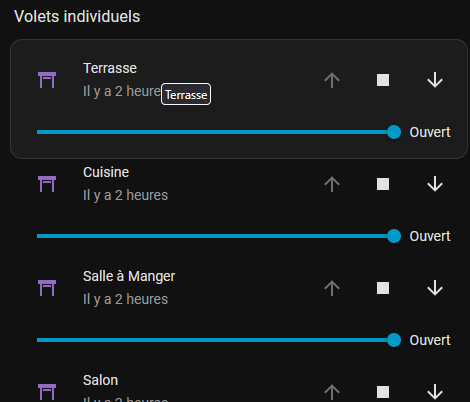

Re..je vais abuser mais je pense rester dans l’idee sinon je crée un nouveau post…J’ai cette carte simple pour tous les volets
state_color: true
type: entities
  - entity: cover.terrasse
    type: custom:slider-entity-row
    step: 5
    min: 0
    max: 100
    grow: true
    full_row: true
  - entity: cover.cuisine
    step: 5
    min: 0
    max: 100
    grow: true
    full_row: true
  - entity: cover.salle_a_manger
    step: 5
    min: 0
    max: 100
    grow: true
    full_row: true
  - entity: cover.salon
    step: 5
    min: 0
    max: 100
    grow: true
    full_row: true
  - entity: cover.dressing
    step: 5
    min: 0
    max: 100
    grow: true
    full_row: true
  - entity: cover.marie_chouffe
    step: 5
    min: 0
    max: 100
    grow: true
    full_row: true
  - entity: cover.salle_de_bain
    step: 5
    min: 0
    max: 100
    grow: true
    full_row: true
  - entity: cover.cellier
    step: 5
    min: 0
    max: 100
    grow: true
    full_row: true
  - entity: cover.palier
    step: 5
    min: 0
    max: 100
    grow: true
    full_row: true
  - entity: cover.salle_de_jeux
    step: 5
    min: 0
    max: 100
    grow: true
    full_row: true
grid_options:
  columns: 11
  rows: 2
Par contre le visuel est pas top car il n’y a ce rectangle qu’autour de la premiere entité
Y a moyen de prendre toute la carte dans le rectangle? Ou 1 rectangle par entité?
Merci d’avance
