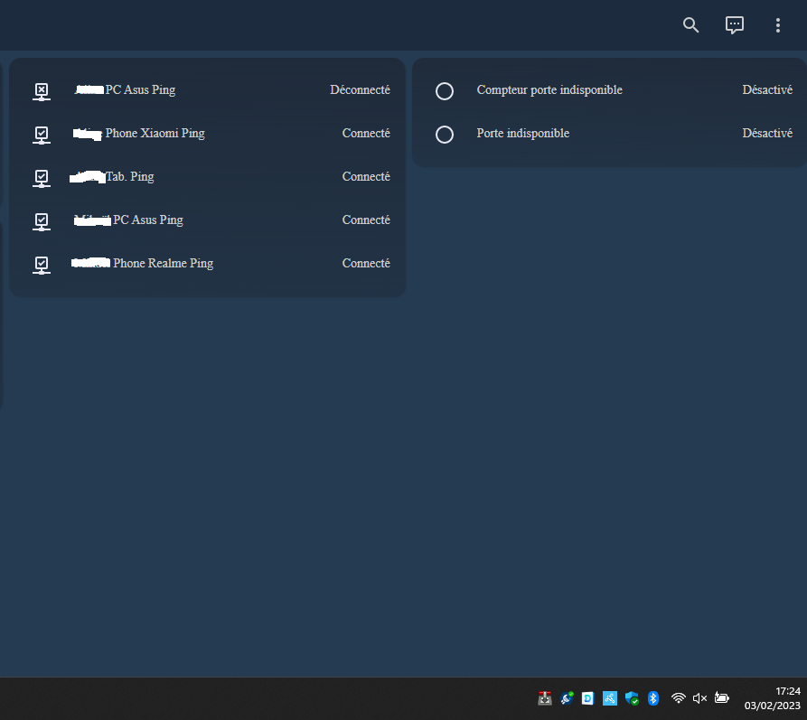

mon tel est en veille la et pourtant connecté via un ping !!
dans binary sensor
  - platform: ping
    host: 192.168.2.1
    scan_interval: 30
  - platform: ping
    host: 192.168.2.2
    name: XXXX PC Asus Ping
    scan_interval: 30
  - platform: ping
    host: 192.168.2.3
    name: XXXXX PC Asus Ping
    scan_interval: 30
  - platform: ping
    host: 192.168.2.55
    name: XXX Phone Realme Ping
    scan_interval: 30
  - platform: ping
    host: 192.168.2.95
    name: XXX Tab. Ping
    scan_interval: 30
  - platform: ping
    host: 192.168.2.98
    name: XXXXX Phone Xiaomi Ping
    scan_interval: 30
