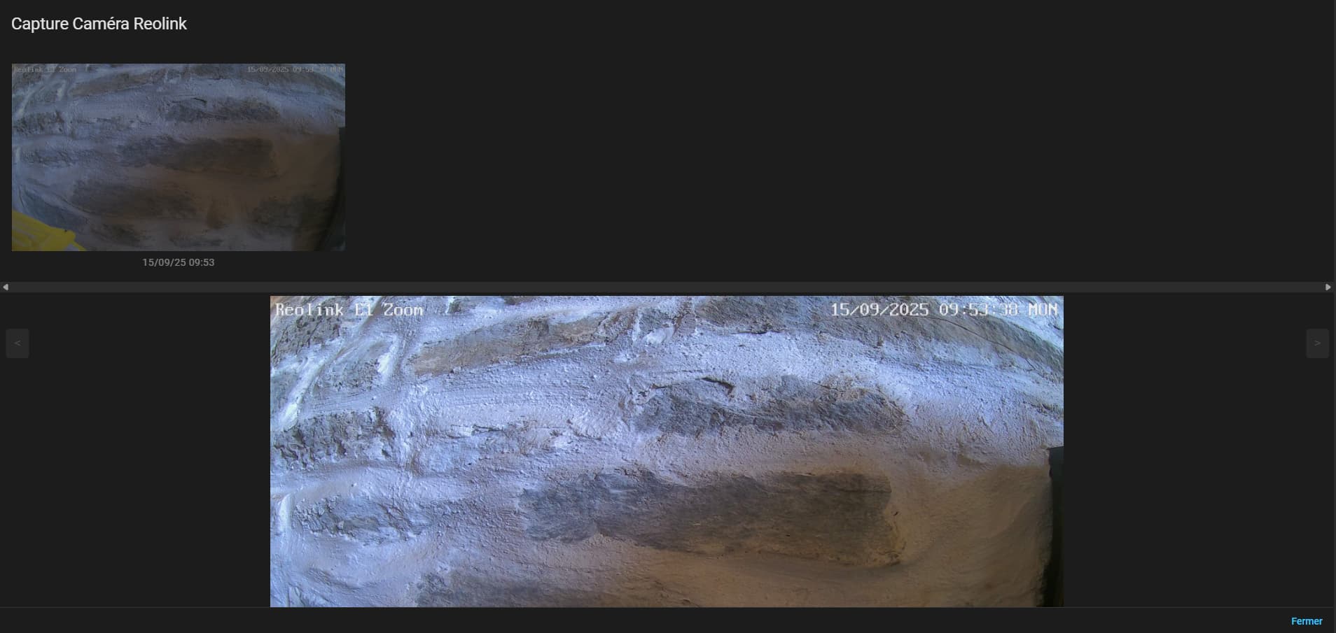

Sinon, tu as la carte gallery-card qui permet d’afficher des photos.
J’utilise la carte advanced-camera-card, avec un bouton pour prendre des captures et un bouton pour m’ouvrir un popup de gallery-card pour voir les captures.

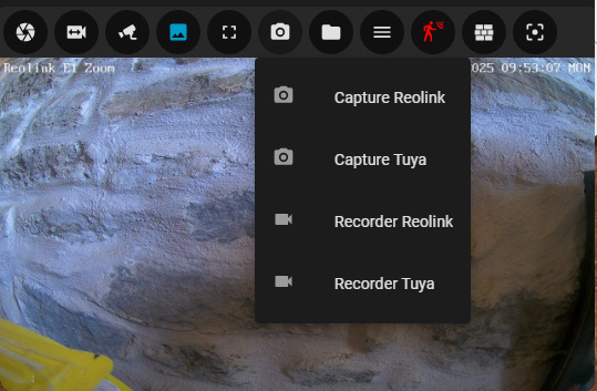

Je te partage mon code avec advanced-camera-card, le bouton de capture et le bouton avec popup de la carte gallery-card.
    type: custom:advanced-camera-card
    cameras:
      - camera_entity: camera.reolink_e1_zoom_profile000_mainstream
        live_provider: auto
        ptz:
          actions_left:
            action: perform-action
              entity_id: camera.reolink_e1_zoom_profile000_mainstream
              pan: LEFT
              distance: 0.1
              speed: 0.16
              continuous_duration: 0.5
              move_mode: ContinuousMove
            perform_action: onvif.ptz
          actions_right:
              pan: RIGHT
              distance: 0.1
              speed: 0.16
          actions_up:
              tilt: UP
              distance: 0.1
              speed: 0.16
          actions_down:
              tilt: DOWN
              distance: 0.1
              speed: 0.16
          actions_zoom_in:
              zoom: ZOOM_IN
              distance: 0.1
              speed: 0.16
          actions_zoom_out:
              zoom: ZOOM_OUT
              distance: 0.1
              speed: 0.16
          presets:
            home:
                preset: "002"
                move_mode: GotoPreset
            mur:
                preset: "000"
            entrée:
                preset: "001"
            salon:
                preset: "003"
      - camera_entity: camera.192_168_1_29
        live_provider: auto
    elements:
      - type: custom:advanced-camera-card-menu-submenu
        icon: mdi:camera
        items:
          - title: Capture Reolink
            icon: mdi:camera
            tap_action:
                filename: >-
                  /media/Capture/Capture_Reolink_{{
              perform_action: camera.snapshot
          - title: Capture Tuya
            icon: mdi:camera
            tap_action:
                entity_id: camera.192_168_1_29
                filename: >-
                  /media/Capture/Capture_Tuya_{{ now().strftime("%d%m%y_%H%M")
          - title: Recorder Reolink
            icon: mdi:video
            tap_action:
                duration: 10
                filename: >-
                  /media/Capture/Recorder_Reolink_{{
                  now().strftime("%d%m%y_%H%M") }}.mp4
              perform_action: camera.record
          - title: Recorder Tuya
            icon: mdi:video
            tap_action:
                duration: 10
                filename: >-
                  /media/Capture/Recorder_Tuya_{{ now().strftime("%d%m%y_%H%M")
                  }}.mp4
      - type: custom:advanced-camera-card-menu-icon
        icon: mdi:folder
        title: Dossier Capture
        tap_action:
          action: fire-dom-event
          browser_mod:
            service: browser_mod.popup
              right_button: Fermer
              right_button_action:
                service: browser_mod.close_popup
                  browser_id: THIS
              browser_id: THIS
              style: "--popup-border-radius: 10px;"
              content:
                type: custom:gallery-card
                title: Capture Caméra Reolink
                  - path: media-source://media_source/local/Capture/
                menu_alignment: top
                maximum_files: 30
                file_name_format: DDMMYY_HHmm
                caption_format: D/MM/YY HH:mm
                parsed_date_sort: true
        icon: mdi:menu
        items:
          - title: Autofocus
            entity: switch.reolink_e1_zoom_autofocus
            tap_action:
              action: toggle
          - title: Led
            entity: switch.reolink_e1_zoom_ir_lamp
            tap_action:
              action: toggle
      - type: custom:advanced-camera-card-menu-state-icon
        entity: binary_sensor.reolink_e1_zoom_cell_motion_detection_2
        title: Caméra détection
        state_color: true
        tap_action:
          action: more-info
        icon: mdi:wall
        title: Mur
        tap_action:
            preset: "000"
        icon: mdi:image-filter-center-focus
        title: Centre
        tap_action:
            preset: "002"
    menu:
      style: outside
      buttons:
        cameras:
          enabled: true
        image:
          enabled: true
        media_player:
          enabled: false
        ptz_controls:
          enabled: false
        download:
          enabled: false
        timeline:
          enabled: false
        display_mode:
          enabled: false
      position: top
    live:
      preload: false
      show_image_during_load: false
      draggable: false
      controls:
        builtin: true
        ptz:
          orientation: horizontal
          position: top-right
        next_previous:
          style: icons
      transition_effect: none
    view:
      default: image
      theme:
        themes:
          - traditional
    image:
      mode: camera
      refresh_seconds: 10
    media_viewer:
      draggable: true
    performance:
      style:
        border_radius: true
