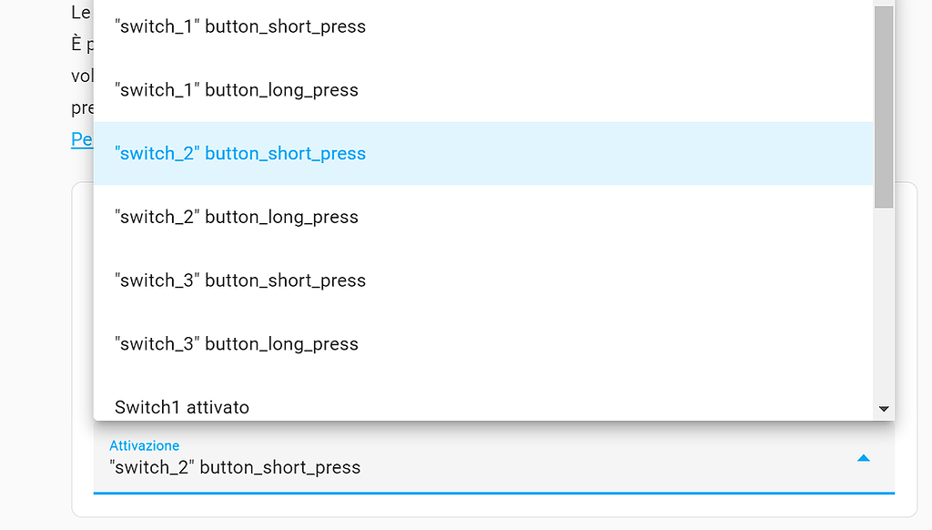

tu trouveras des exemples sur ce sujet :
substitutions:
  short_min:   10ms
  short_max:  500ms
  long_min:   500ms
  long_max:  2000ms
event:
  - platform: template
    device_class: button
    event_types:
      - pressed_short
      - pressed_long
binary_sensor:
  - platform: gpio
#    internal: true
    pin:
      number: D1
      inverted: true
      mode:
        input: true
        pullup: true
    on_click:
      - min_length: ${short_min}
        max_length: ${short_max}
        then:
          - event.trigger:
              event_type: pressed_short
      - min_length: ${long_min}
        max_length: ${long_max}
        then:
          - event.trigger:
              event_type: pressed_long
