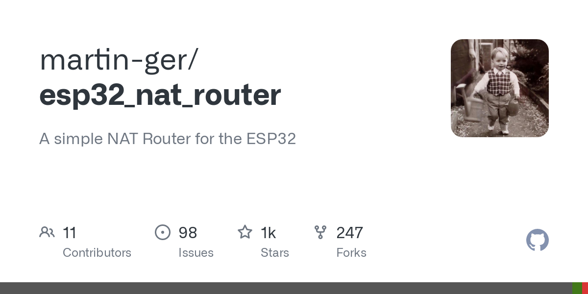

Ok, ta ce projet GitHub - martin-ger/esp32_nat_router: An AI-enabled NAT Router/Firewall for the ESP32 · GitHub
Mais c'est pas esphome.
This is a firmware to use the ESP32 as WiFi NAT router. It can be used as
  • Simple range extender for an existing WiFi network
Pour l'installation:
Pour flasher tu as besoin de l'application Flash Download
https://www.espressif.com/sites/default/files/tools/flash_download_tool_3.9.6.zip
Les fichiers bin a flasher
https://github.com/martin-ger/esp32_nat_router/tree/master/build/esp32
Tu configure comme l'image et start ( pour lancer le flash )
