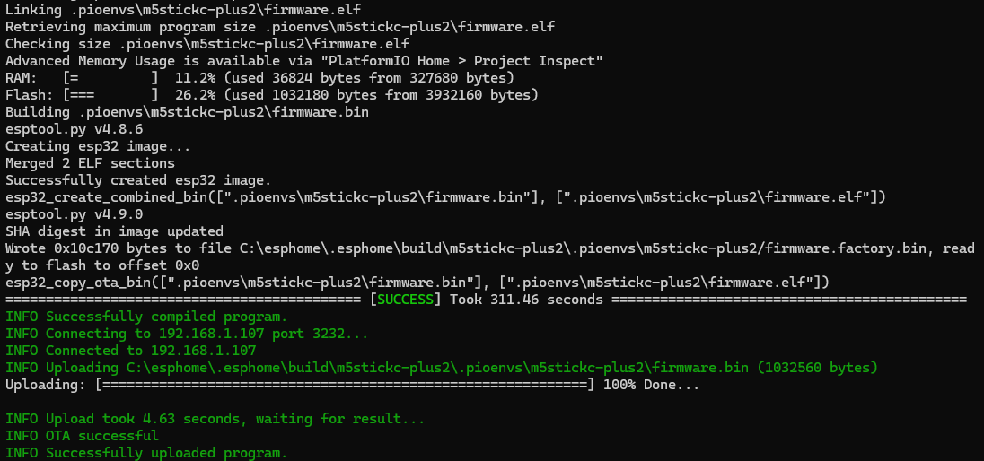

Voici l’erreur que j’obtiens en testant la config :
OSError: no library called "cairo-2" was found
no library called "cairo" was found
no library called "libcairo-2" was found
cannot load library 'libcairo.so.2': error 0x7e.  Additionally, ctypes.util.find_library() did not manage to locate a library called 'libcairo.so.2'
cannot load library 'libcairo.2.dylib': error 0x7e.  Additionally, ctypes.util.find_library() did not manage to locate a library called 'libcairo.2.dylib'
cannot load library 'libcairo-2.dll': error 0x7e.  Additionally, ctypes.util.find_library() did not manage to locate a library called 'libcairo-2.dll'
j’ai essayer pip3 install cairosvg, mais toujours pareil.

J’ai trouvé, il fallait installer GTK. Mais dans le lien de @Pulpy-Luke , il parlait de la version gtk2-runtime-2.24.10-2012-10-10-ash.exe qui est une version 32bits et ça ne fonctionnait pas.
Puis en lisant les commentaires, un utilisatuer a donné une autre solution et d’installer GTK3 64bits:
https://stackoverflow.com/questions/28211418/python-oserror-cannot-load-library-libcairo-so-2/77634528#77634528
le lien de download de GTK3 64bits :
Et là, magie !!! :grin:
