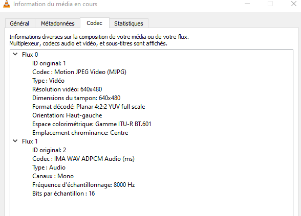

J’ai une petite avancée: (en regardant rtmp deprecated
en changeant la conf go2rtc par :
go2rtc:
  streams:
    portail:
      - http://hassio:Fonsorbes31@192.168.1.180:1180/videostream.asf #?user=hassio&pwd=Fonsorbes31&resolution=64&rate=0
      - "ffmepg:portail#audio=opus"
j’ai maintenant pour le log go2rtc :
2024-02-16 14:41:03.585540415  [INFO] Preparing new go2rtc config...
2024-02-16 14:41:03.906704023  [INFO] Starting go2rtc...
2024-02-16 14:41:03.996829887  14:41:03.996 INF go2rtc version 1.8.4 linux/amd64
2024-02-16 14:41:03.997389756  14:41:03.997 INF [rtsp] listen addr=:8554
2024-02-16 14:41:03.997599145  14:41:03.997 INF [webrtc] listen addr=:8555
2024-02-16 14:41:03.998535064  14:41:03.998 INF [api] listen addr=:1984
2024-02-16 14:41:13.582892927  [INFO] Starting go2rtc healthcheck service...
2024-02-16 14:41:14.135452472  14:41:14.135 WRN [rtsp] error="streams: codecs not matched: JPEG => H264, H265, AAC" stream=portail
2024-02-16 14:41:15.178091960  14:41:15.178 WRN [rtsp] error="streams: codecs not matched: JPEG => H264, H265, AAC" stream=portail
mais dans frigate, l’ecran est toujours noir et le log :
2024-02-16 14:41:34.447443828  [2024-02-16 14:41:34] watchdog.cctv_portail          ERROR   : Ffmpeg process crashed unexpectedly for cctv_portail.
2024-02-16 14:41:34.451861675  [2024-02-16 14:41:34] watchdog.cctv_portail          ERROR   : The following ffmpeg logs include the last 100 lines prior to exit.
2024-02-16 14:41:34.451865624  [2024-02-16 14:41:34] ffmpeg.cctv_portail.detect     ERROR   : [rtsp @ 0x55e9d34ac100] method DESCRIBE failed: 404 Not Found
2024-02-16 14:41:34.451867487  [2024-02-16 14:41:34] ffmpeg.cctv_portail.detect     ERROR   : rtsp://127.0.0.1:8554/portail: Server returned 404 Not Found
2024-02-16 14:41:35.002949619  [2024-02-16 14:41:35] frigate.video                  ERROR   : cctv_portail: Unable to read frames from ffmpeg process.
2024-02-16 14:41:35.003168108  [2024-02-16 14:41:35] frigate.video                  ERROR   : cctv_portail: ffmpeg process is not running. exiting capture thread..
il y a une histoire de codec et de conversion peut-être à faire

Je reprends donc ce dernier sujet, d’arriver à faire marcher cette « vieille » caméra Foscam.
Je repars du post #32, idem pout le go2trc, mais en retirant tous les input args et outputs args de la partie caméra.
Cette caméra « portail » reste noire, et les erreurs frigate :

Pour mémoire, dans VLC, en faisant « ouvrir le stream » avec
http://192.168.1.180:1180/videostream.asf?user=user&pwd=pwd&resolution=64&rate=0
ça fonctionne bien, j’ai aussi le son.
le ctrl+i me done les codec suivant :
codec
C’est bizarre tout de même. Je suppose que cette caméra est trop vieille… même pas de rstp à l’époque.
Surveillance Station arrive bien à la configurer (en sélectionnant cette caméra dans la liste), mais pour frigate…

VICTOIRE !!!
Grace à tes recherches sur le lien de bensoftwareet aussi sur un autre FOSCAM sur home assistant
j’ai vu qu’il y avait une autre URL pour bien faire marcher le stream sur VLC :
http://192.168.1.180:1180/videostream.cgi?user=admin&pwd=pwd
du coup, en repartant des premiers essais qu’on avait fait au départ, voici ce qui marche
Conf Go2rtc
go2rtc:
  streams:
    portail: "ffmpeg:http://192.168.1.180:1180/videostream.cgi?user=admin&pwd=pwd#video=h264#hardware"
