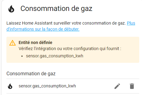

j ai dans Energie :
et 0 mesure dans mon tableau
pouvez vous m aider a trouver la solution? merci

J’ai un problème similaire.
Incapable de dire depuis quand le service ne fonctionne plus (ou mal).
Voila les logs (mode debug) que j’obtiens au déclenchement de l’événement call_grdf :
2024-02-14 16:15:02,114 : OK : Using /usr/bin/python3 Version 3.11.6Loading configuration file : /m2h_config.json
2024-02-14 16:15:02,118 : -- :  Start loading configuration
2024-02-14 16:15:02,119 : OK : "veolia" = "False"
2024-02-14 16:15:02,121 : OK : "veolia_login" = "None"
2024-02-14 16:15:02,122 : OK : "veolia_password" = "None"
2024-02-14 16:15:02,123 : OK : "veolia_contract" = "None"
2024-02-14 16:15:02,124 : OK : "grdf" = "True"
2024-02-14 16:15:02,126 : OK : "grdf_login" = "###########@gmail.com"
2024-02-14 16:15:02,127 : OK : "grdf_password" = "************"
2024-02-14 16:15:02,128 : OK : "grdf_pce" = "###############"
2024-02-14 16:15:02,128 : OK : "screenshot" = "True"
2024-02-14 16:15:02,129 : OK : "skip_download" = "False"
2024-02-14 16:15:02,130 : OK : "keep_output" = "True"
2024-02-14 16:15:02,131 : WW :  "geckodriver" not found in config file, using default value
2024-02-14 16:15:02,131 : OK : "geckodriver" = "/MetersToHA/apps/meters_to_ha/geckodriver"
2024-02-14 16:15:02,132 : WW :  "firefox" not found in config file, using default value
2024-02-14 16:15:02,133 : OK : "firefox" = "/MetersToHA/apps/meters_to_ha/firefox"
2024-02-14 16:15:02,133 : WW :  "chromium" not found in config file, using default value
2024-02-14 16:15:02,134 : OK : "chromium" = "/usr/bin/chromium"
2024-02-14 16:15:02,135 : WW :  "chromedriver" not found in config file, using default value
2024-02-14 16:15:02,135 : OK : "chromedriver" = "/usr/bin/chromedriver"
2024-02-14 16:15:02,136 : OK : "chrome_version" = "None"
2024-02-14 16:15:02,136 : OK : "timeout" = "30"
2024-02-14 16:15:02,137 : OK : "download_folder" = "/config/"
2024-02-14 16:15:02,137 : OK : "logs_folder" = "/config/"
2024-02-14 16:15:02,138 : OK : "2captcha_token" = "********************************"
2024-02-14 16:15:02,138 : OK : "capmonster_token" = "None"
2024-02-14 16:15:02,139 : OK : "captchaai_token" = "None"
2024-02-14 16:15:02,139 : OK : "log_level" = "debug"
2024-02-14 16:15:02,140 : OK : End loading configuration
2024-02-14 16:15:02,140 : -- :  Start Loading Home Assistant configuration
2024-02-14 16:15:02,141 : OK : "ha_server" = "http://supervisor/core"
2024-02-14 16:15:02,141 : OK : "ha_token" = "****************************************************************************************************************"
2024-02-14 16:15:02,145 : OK : "veolia_contract" = "None"
2024-02-14 16:15:02,146 : OK : "timeout" = "30"
2024-02-14 16:15:02,147 : OK : "insecure" = "False"
2024-02-14 16:15:02,148 : OK : "state_file" = "/config/meters2ha_state.json"
2024-02-14 16:15:02,149 : OK : End loading Home Assistant configuration
2024-02-14 16:15:02,150 : ~~ :  Check availability of "geckodriver"+"firefox" or "chromedriver"+"chromium"
2024-02-14 16:15:02,151 : OK :  Found chromium binary
2024-02-14 16:15:02,197 : OK : Check Home Assistant connectivity
2024-02-14 16:15:02,198 : -- : Try starting Chromium. Add nix root user options.
2024-02-14 16:15:02,199 : -- :  Use /config/.config/google-chrome for Google Chrome user data.
2024-02-14 16:15:03,364 : OK : Start virtual display (Chromium).
2024-02-14 16:15:03,366 : ~~ :  LOG LEVEL debug:10:20 ['--verbose']
2024-02-14 16:15:09,193 : OK : Start the browser
2024-02-14 16:15:09,194 : OK :
2024-02-14 16:15:13,000 : OK : Connexion au site GRDF
2024-02-14 16:15:43,070 : WW : Waiting for Password Traceback (most recent call last): -   File "//MetersToHA/apps/meters_to_ha/meters_to_ha.py", line 3375, in doWork -     gazpar_file = crawler.get_gazpar_file() -                   ^^^^^^^^^^^^^^^^^^^^^^^^^ -   File "//MetersToHA/apps/meters_to_ha/meters_to_ha.py", line 1757, in get_gazpar_file -     el_password = self.__wait.until( -                   ^^^^^^^^^^^^^^^^^^ -   File "/usr/lib/python3.11/site-packages/selenium/webdriver/support/wait.py", line 105, in until -     raise TimeoutException(message, screen, stacktrace) - selenium.common.exceptions.TimeoutException: Message: failed, page timeout (timeout=30) -
2024-02-14 16:15:43,071 : WW :  Encountered error -> Retrying once
2024-02-14 16:15:46,497 : OK : Connexion au site GRDF
2024-02-14 16:16:16,634 : EE : Waiting for Password Message: failed, page timeout (timeout=30)
2024-02-14 16:16:16,939 : OK : Close Browser
2024-02-14 16:16:16,948 : OK : Close Display
2024-02-14 16:16:16,949 : EE :  Ended with error : // re-run with '--display' option if you can
Ma version de Home Assistant sur pc Generic x86-64
  • Core : 2024.2.1
  • Supervisor : 2024.01.1
  • Operating System : 11.5
  • Interface utilisateur : 20240207.1
  • MetersToHA : Current version: dev
Un éclairage de quelqu’un ?
Merci d’avance.
