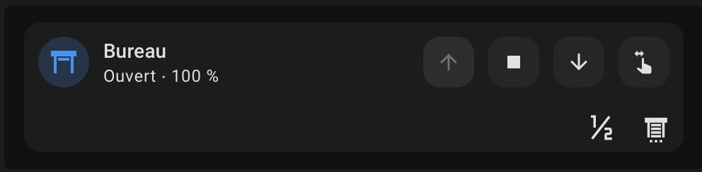

Sur base de mushroom, je fais ça chez moi avec une position ouvert à 50% et une position ouvert à 10% (soit quasi fermé).
type: custom:vertical-stack-in-card
  - type: custom:mushroom-cover-card
    entity: cover.bureau
    show_tilt_position_control: false
    show_position_control: true
    show_buttons_control: true
    fill_container: true
    layout: horizontal
    primary_info: name
  - type: custom:mushroom-chips-card
    chips:
      - type: action
        tap_action:
          action: perform-action
          perform_action: cover.set_cover_position
            entity_id: cover.bureau
            position: 50
        hold_action:
          action: none
        double_tap_action:
          action: none
        icon: mdi:fraction-one-half
      - type: action
        tap_action:
            position: 10
        hold_action:
          action: none
        double_tap_action:
          action: none
        icon: mdi:window-shutter-settings
    alignment: end
