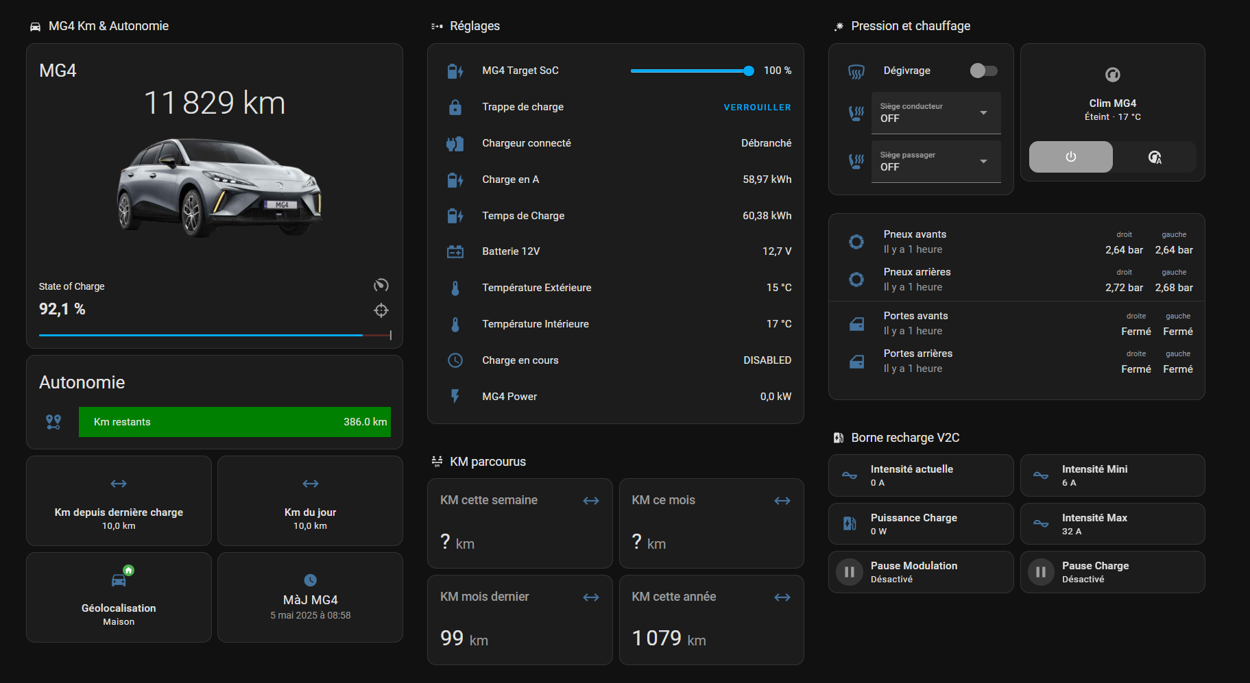

Est-ce que tu pourrais partage le code de ton Dash pour la MG4 stp ?
Le voici
type: sections
max_columns: 4
title: MG4
path: mg4
icon: mdi:car
sections:
  - type: grid
      - type: heading
        heading: MG4 Km & Autoonomie
        heading_style: title
        icon: mdi:car
      - type: custom:car-card
        title: MG4
        image:
          src: /local/images/mg4-fd.png
          max_height: 150
        fields:
          main:
            heading:
              entity: sensor.lsjwh4091pn070756_mileage
          battery:
            state_of_charge:
              entity: sensor.lsjwh4091pn070756_soc
            target_state_of_charge:
              entity: number.lsjwh4091pn070756_target_soc
            recommended_target: 80
      - title: Autonomie
        type: custom:bar-card
        positions:
          indicator: inside
        width: 50%
        severity:
          - color: Red
            from: 0
            to: 74
          - color: Orange
            from: 75
            to: 174
          - color: Green
            from: 175
            to: 500
          - entity: sensor.lsjwh4091pn070756_range
            icon: mdi:map-marker-distance
      - type: statistic
        period:
          calendar:
            period: day
        stat_type: change
        entity: sensor.lsjwh4091pn070756_mileage_of_the_day
        unit: km
        name: Km  (aujourd'hui)
      - type: statistic
        period:
          calendar:
            period: week
        stat_type: change
        unit: km
        name: Km (semaine)
      - type: statistic
        period:
          calendar:
            period: month
        stat_type: change
        unit: km
        name: Km (mois en cours)
      - type: statistic
        period:
          calendar:
            period: month
            offset: -1
        stat_type: change
        unit: km
        name: Km (mois dernier)
  - type: grid
      - type: heading
        heading: Réglages
        icon: mdi:set-merge
      - type: entities
          - entity: number.lsjwh4091pn070756_target_soc
          - entity: select.lsjwh4091pn070756_charge_current_limit
          - entity: lock.lsjwh4091pn070756_doors_lock
          - entity: lock.lsjwh4091pn070756_boot_lock
          - entity: sensor.lsjwh4091pn070756_auxiliary_battery_voltage
          - entity: sensor.lsjwh4091pn070756_exterior_temperature
            name: Température Extérieure
          - entity: sensor.lsjwh4091pn070756_interior_temperature
            name: Température Intérieure
          - entity: sensor.lsjwh4091pn070756_current
            name: Charge en A
          - entity: binary_sensor.lsjwh4091pn070756_battery_charging
          - entity: sensor.lsjwh4091pn070756_power
      - type: entities
          - entity: switch.lsjwh4091pn070756_charging
            name: Etat de la charge
          - entity: binary_sensor.lsjwh4091pn070756_charger_connected
          - entity: sensor.lsjwh4091pn070756_soc
            icon: mdi:car-battery
            secondary_info: last-updated
          - entity: sensor.lsjwh4091pn070756_soc_kwh
            name: Batterie restante (kW)
        title: Chargement
        state_color: false
  - type: grid
      - type: heading
        heading: Pression et chauffage
        icon: mdi:regex
      - type: entities
          - entity: switch.lsjwh4091pn070756_vehicle_climate_fan_only
          - entity: select.lsjwh4091pn070756_heated_seat_front_left_level
            name: Siège conducteur
          - entity: select.lsjwh4091pn070756_heated_seat_front_right_level
        grid_options:
          columns: 6
          rows: auto
      - features:
          - style: icons
            hvac_modes:
              - "off"
              - auto
            type: climate-hvac-modes
        type: tile
        entity: climate.lsjwh4091pn070756_vehicle_climate
        show_entity_picture: false
        vertical: true
        grid_options:
          columns: 6
          rows: 3
      - type: entities
          - entity: sensor.lsjwh4091pn070756_tyres_front_left_pressure
            type: custom:multiple-entity-row
            secondary_info: last-changed
            state_header: gauche
              - entity: sensor.lsjwh4091pn070756_tyres_front_right_pressure
                unit: bar
          - entity: sensor.lsjwh4091pn070756_tyres_rear_left_pressure
              - entity: sensor.lsjwh4091pn070756_tyres_rear_right_pressure
                unit: bar
          - type: section
          - entity: binary_sensor.lsjwh4091pn070756_door_driver
              - entity: binary_sensor.lsjwh4091pn070756_door_passenger
          - entity: binary_sensor.lsjwh4091pn070756_door_rear_left
              - entity: binary_sensor.lsjwh4091pn070756_door_rear_right
visible:
  - user: b10a31ae37e74662947c135ca67395ef
cards: []
Ainsi que l'image

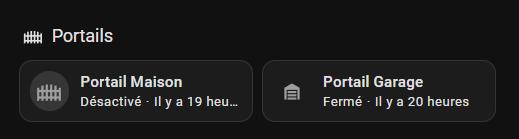

1/ Mise en place d'un Shelly 1 Gen 3 pour piloter mon portail maison (BFT), j'ai un peu galéré pour l'alimentation mais ensuite assez simple avec le mode d'emploi du moteur

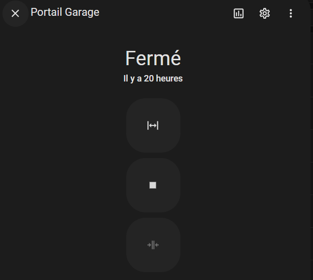

2/ Mise en place d'un Shelly Plus 1 pour piloter mon portail de garage (Hofmann), idem assez simple avec la doc et totalement invisible au final. Je l'ai couplé avec le capteur d'inclinaison pour avoir le retour d'état via un template
- platform: template
  covers:
    portail_garage:
      friendly_name: "Portail Garage"
      device_class: gate
      value_template: >
        {% if is_state('binary_sensor.capteur_portail_garage', 'on') %}
          open
          closed
      open_cover:
        - service: switch.turn_on
          entity_id: switch.portail_garage_switch_0
      close_cover:
      stop_cover:
      icon_template: >
          mdi:gate-open
          mdi:gate
Le capteur d'inclinaison est vraiment très bien et très fiable, j'en suis ravi. Il est parfaitement adapté pour des portes de garage sectionnelles.

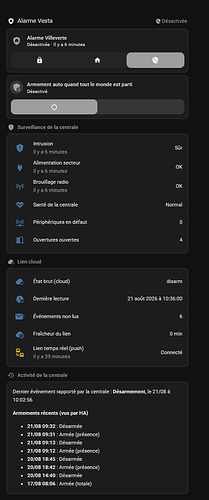

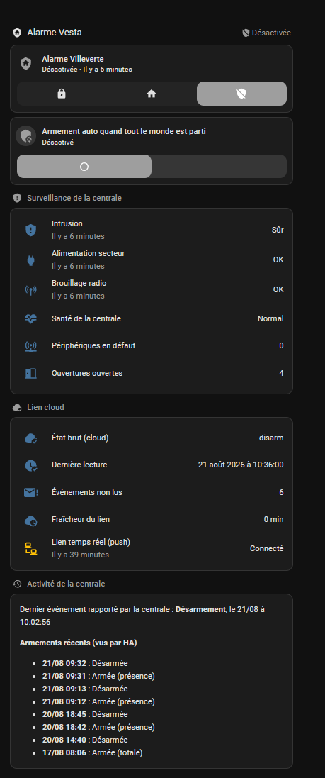

Bonjour à toutes et à tous, petit retour sur mon installation HA.
Un des points qui me posait problème était l'intégration de mon alarme Vesta (VESTA-113N Climax Technology). Je n'avais trouvé ni intégration ni solution satisfaisante. C'est désormais réglé.
À l'aide de Claude Code et d'un peu de rétro-ingénierie, mon alarme est maintenant pleinement pilotée par Home Assistant : armement total, armement présence, désarmement, et surtout des retours d'état fiables.
Le point de départ : ce qui ne marche pas
La centrale expose un petit serveur web local. C'est la voie évidente, et c'est un piège : chez moi il s'effondre très régulièrement (il répond au ping, accepte la connexion TCP, puis renvoie une réponse vide). Toute solution qui repose dessus finit par lâcher au pire moment.
J'ai aussi essayé l'intégration sia native de Home Assistant, sans succès. C'est le point le plus intéressant, j'y reviens plus bas.
L'architecture retenue : deux voies, aucune locale
Voie Rôle Pourquoi
API cloud du fabricant état complet et commande d'armement ne dépend pas du serveur local
Add-on maison, récepteur SIA DC-09 événements en temps réel la centrale pousse, on n'interroge pas
La centrale sait envoyer ses événements vers un centre de télésurveillance au protocole SIA DC-09 / Contact ID. Il suffit de lui déclarer Home Assistant comme destinataire supplémentaire : elle pousse alors ses événements, en une seconde environ, sans aucune interrogation périodique.
Le cloud, lui, est lu une fois par minute pour l'état, et sert de voie de commande. Cette dernière a été prouvée en conditions réelles avec le serveur local complètement mort : le désarmement est passé et s'est inscrit au journal de la centrale.
Le piège qui m'a coûté le plus de temps
Si vous avez une Climax / Vesta et que l'intégration sia de Home Assistant rejette vos trames, voici pourquoi.
Le dialecte de la centrale est du SIA DC-09 conforme, à un détail d'encodage près : le CRC est émis en deux octets binaires, là où la norme veut quatre caractères hexadécimaux ASCII. L'algorithme est CRC-16/ARC.
\n <crc_hi> <crc_lo> LLLL "ADM-CID" 0007 L0 #1234 [1234|1601 00 001]
        2 octets binaires, pas 4 caracteres hex
Les bibliothèques qui suivent la norme à la lettre calculent donc un CRC qui ne correspond jamais et rejettent tout. C'est aussi vrai dans l'autre sens : l'acquittement doit repartir avec la même convention binaire, sinon la centrale le refuse et réémet en boucle.
Une fois ce point compris, le reste est simple : un petit récepteur TCP qui décode les codes Contact ID et republie vers Home Assistant en MQTT.
Deuxième surprise du même genre, pour ceux que ça concerne : chez moi l'armement présence remonte le code 456 et non le 441 standard. Une table de correspondance écrite d'après la norme seule affiche donc « code inconnu » sur un événement parfaitement banal.
Ce que ça donne au quotidien
Au delà de l'armement, je récupère des informations que je n'avais nulle part ailleurs :
  • intrusion en cours, coupure secteur de la centrale, brouillage radio (le geste d'un cambrioleur qui sait ce qu'il fait)
  • l'état de santé des 16 périphériques, leur niveau de signal radio, ceux qui sont en défaut
  • les ouvertures restées ouvertes, à contrôler avant un armement total
  • le journal des armements et désarmements, avec leur origine
Le tout branché sur des notifications Discord et mobile, et une surveillance du lien lui-même : si la centrale cesse de parler, je le sais, au lieu de croire que tout va bien parce que rien n'arrive.
Détail que je trouve élégant : la centrale d'alarme est alimentée sur un autre circuit électrique que ma baie réseau, protégée par onduleur. En croisant les deux, je sais désormais si une coupure de courant est générale ou limitée à un circuit, ce qu'aucun des deux ne pouvait dire seul.
La suite
L'objectif suivant, et c'est ce qui m'intéresse le plus : utiliser tous mes capteurs Home Assistant qui ne sont pas dans l'alarme Vesta (contacteurs de porte, radars de présence, caméras) pour étendre la détection, et pouvoir déclencher la sirène de la centrale par ce biais. Je n'en suis pas encore là, mais la brique de commande existe maintenant.
Si le sujet intéresse du monde, je peux détailler la partie récepteur SIA, c'est réutilisable pour toute centrale Climax (elles sont vendues sous plusieurs marques).
