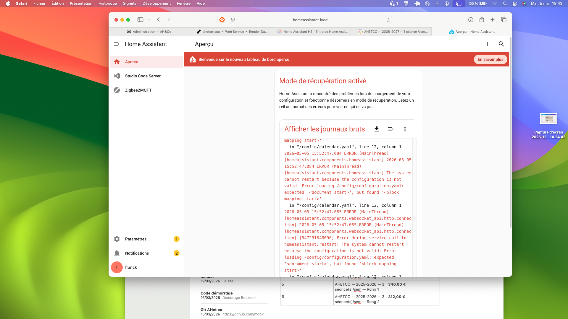

Voila des captures .
et les logs/
services-up: info: copying legacy longrun home-assistant (no readiness notification)
2026-05-05 15:22:41.920 ERROR (SyncWorker_0) [annotatedyaml.loader] expected ‹  ›, but found ‹  ›
in « /config/calendar.yaml », line 12, column 1
2026-05-05 15:22:41.921 ERROR (MainThread) [homeassistant.bootstrap] Failed to parse configuration.yaml: expected ‹  ›, but found ‹  ›
in « /config/calendar.yaml », line 12, column 1. Activating recovery mode
2026-05-05 15:33:06.549 WARNING (SyncWorker_5) [py.warnings] 2026-05-05 15:33:06.549 WARNING (SyncWorker_5) [py.warnings] /usr/local/lib/python3.14/site-packages/rich/segment.py:547: SyntaxWarning: ‹ return › in a ‹ finally › block
return
2026-05-05 15:52:47.083 ERROR (SyncWorker_5) [annotatedyaml.loader] 2026-05-05 15:52:47.083 ERROR (SyncWorker_5) [annotatedyaml.loader] expected ‹  ›, but found ‹  ›
2026-05-05 15:52:47.084 ERROR (MainThread) [homeassistant.components.homeassistant] 2026-05-05 15:52:47.084 ERROR (MainThread) [homeassistant.components.homeassistant] The system cannot restart because the configuration is not valid: Error loading /config/configuration.yaml: expected ‹  ›, but found ‹  ›
2026-05-05 15:52:47.085 ERROR (MainThread) [homeassistant.components.websocket_api.http.connection] 2026-05-05 15:52:47.085 ERROR (MainThread) [homeassistant.components.websocket_api.http.connection] [547291848096] Error during service call to homeassistant.restart: The system cannot restart because the configuration is not valid: Error loading /config/configuration.yaml: expected ‹  ›, but found ‹  ›
2026-05-05 18:30:01.542 ERROR (SyncWorker_2) [annotatedyaml.loader] 2026-05-05 18:30:01.542 ERROR (SyncWorker_2) [annotatedyaml.loader] expected ‹  ›, but found ‹  ›
2026-05-05 18:30:01.543 ERROR (MainThread) [homeassistant.components.homeassistant] 2026-05-05 18:30:01.543 ERROR (MainThread) [homeassistant.components.homeassistant] The system cannot reload because the configuration is not valid: Error loading /config/configuration.yaml: expected ‹  ›, but found ‹  ›
2026-05-05 18:30:01.544 ERROR (MainThread) [aiohttp.server] 2026-05-05 18:30:01.544 ERROR (MainThread) [aiohttp.server] Error handling request from 172.30.32.2
File « /usr/local/lib/python3.14/site-packages/aiohttp/web_protocol.py », line 517, in _handle_request
resp = await request_handler(request)
File « /usr/local/lib/python3.14/site-packages/aiohttp/web_app.py », line 569, in _handle
return await handler(request)
File « /usr/local/lib/python3.14/site-packages/aiohttp/web_middlewares.py », line 117, in impl
File « /usr/src/homeassistant/homeassistant/components/http/security_filter.py », line 92, in security_filter_middleware
File « /usr/src/homeassistant/homeassistant/components/http/forwarded.py », line 87, in forwarded_middleware
File « /usr/src/homeassistant/homeassistant/components/http/request_context.py », line 26, in request_context_middleware
File « /usr/src/homeassistant/homeassistant/components/http/ban.py », line 90, in ban_middleware
File « /usr/src/homeassistant/homeassistant/components/http/auth.py », line 263, in auth_middleware
File « /usr/src/homeassistant/homeassistant/components/http/headers.py », line 41, in headers_middleware
response = await handler(request)
File « /usr/src/homeassistant/homeassistant/helpers/http.py », line 89, in handle
result = await handler(request, **request.match_info)
File « /usr/src/homeassistant/homeassistant/components/api/init.py », line 437, in post
response = await shield(
…<8 lines>…
File « /usr/src/homeassistant/homeassistant/core.py », line 2817, in async_call
response_data = await coro
File « /usr/src/homeassistant/homeassistant/core.py », line 2860, in _execute_service
return await target(service_call)
File « /usr/src/homeassistant/homeassistant/helpers/service.py », line 943, in _async_admin_handler
return await task
File « /usr/src/homeassistant/homeassistant/components/homeassistant/init.py », line 380, in async_handle_reload_all
raise HomeAssistantError(
…<2 lines>…
homeassistant.exceptions.HomeAssistantError: Cannot quick reload all YAML configurations because the configuration is not valid: Error loading /config/configuration.yaml: expected ‹  ›, but found ‹  ›
C’est plus clair !
Dejà tu es mode récupération, donc ça fonctionne en mode dégradé.
La dernière capture est intéressante aussi. Tu as mis des erreurs dans le fichier calendar, en ligne 12.
Tu peux commencer par tout mettre en commentaire et vérifier qu’il n’y a pas autre chose
Peux tu partager le fichier ‹ /config/calendar.yaml › ? le soucis semble se situer à ce niveau

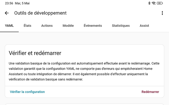

Il y’a tous les outils a disposition pour vérifier ses fichiers dans HA. Après si on ignore les avertissements…
un conseil quand tu debutes evites grandement de modifier les fichiers de configurations, le yaml c’est pas des plus accessibles ( et c’est très très tatillon) et il est possibles de faire bien des choses sans mettre les mains dedans
et comme le suggère @Tochy il faut absolument utiliser la validation du fichier yaml au risque de se retrouver avec ce genre de désagrément
