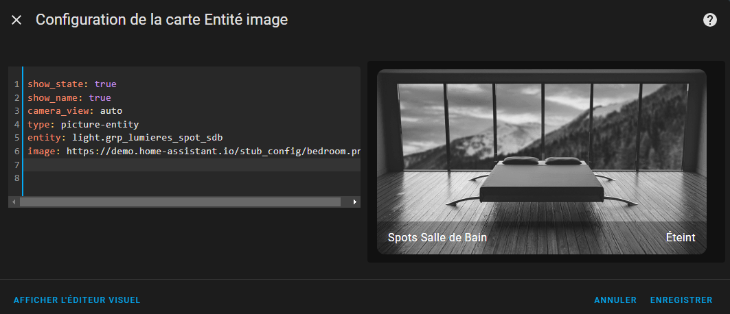

tente avec l’option aspect_ratio
aspect_ratio string (optional)
Forces the height of the image to be a ratio of the width. Valid formats: Height percentage value (23%) or ratio expressed with colon or “x” separator (16:9 or 16x9). For a ratio, the second element can be omitted and will default to “1” (1.78 equals 1.78:1).
fit_mode string (optional, default: cover)
Defines the manner in which the image is stretched/clipped to fit the card area. cover: The image keeps its aspect ratio and fills the given dimension. The image will be clipped to fit. contain: The image keeps its aspect ratio, but is resized to fit within the given dimension. fill: The image is resized to fill the given dimension. If necessary, the image will be stretched or squished to fit.

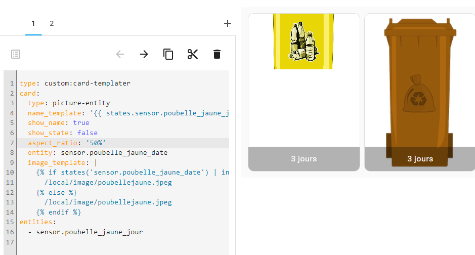

merci mais jai deja essayer
si je mets aspect_ratio: ‹ 50% ›
avec fit_mode string: contain ou fill et cover ==> rien

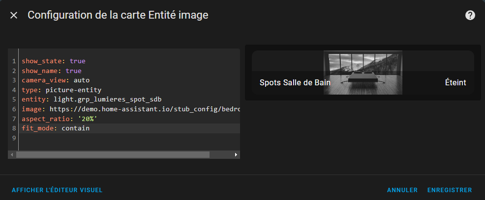

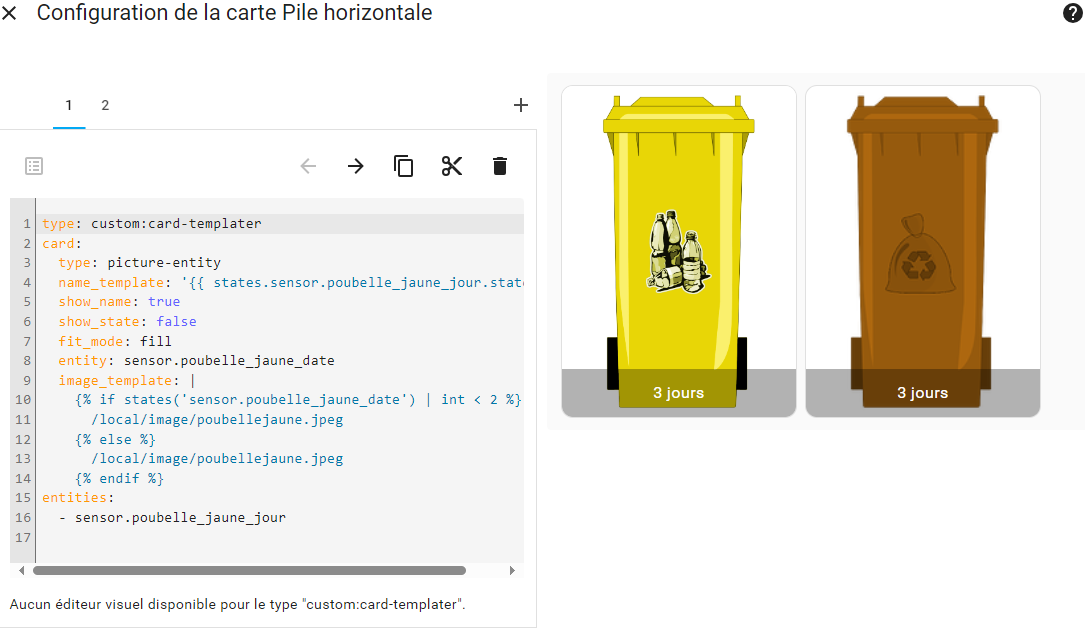

merci beaucoup , j’avais pas mis le FIT_MODE:CONTAIN
C’est bon ou pas ?
Si OK, met ton sujet en résolu.
oui c’est bon merci à toi et question bête , comment on mets en résolu
