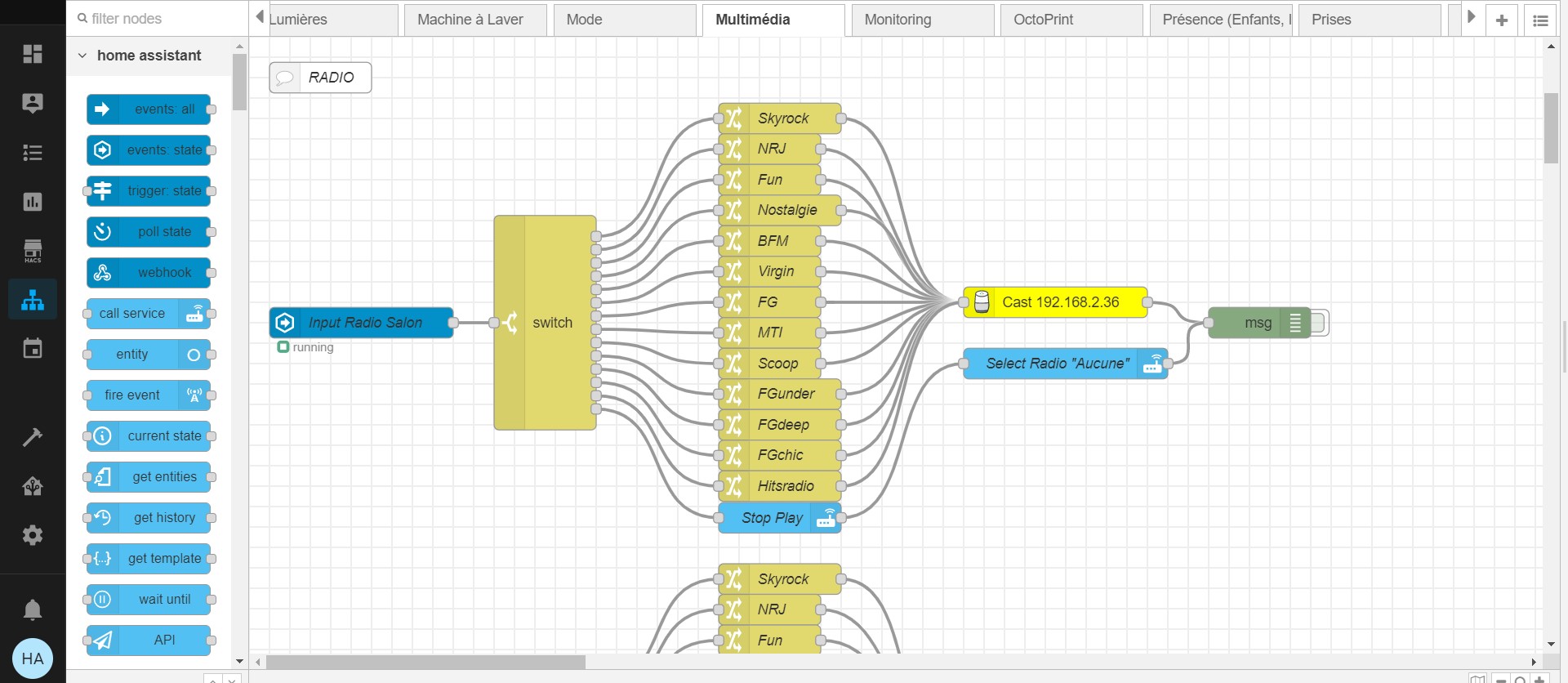

[TUTO] Gestion de la radio sur les Google Home.
Je me suis inspiré d'un tuto crée par un utilisateur sur le groupe Facebook Home Assistant FR. J'ai juste adapté sa version YAML en Node Red.
Il faut créer un input_select par google home. On y retrouvera toute les radios. Dans exemple deux input_select "input_select.radio_station_salon" et "input_select.radio_station_sdb"
Skyrock, NRJ, Fun, Nostalgie, BFM, Virgin, FG, MTI, Scoop, FGunder, FGdeep, FGchic, Hitsradio, Aucune
Fichier du dossier des images pour la carte et la carte. Attention vous aurez besoin de mini-media-player qui s’installe via Hacs.
Fichier WWW + card manuel
[{"id":"c98279b2.cca8b8","type":"comment","z":"9000173c.57c758","name":"RADIO","info":"","x":70,"y":380,"wires":[]},{"id":"6f583f15.0bae7","type":"server-state-changed","z":"9000173c.57c758","name":"Input Radio Salon","server":"a8c279c8.be8be8","version":1,"exposeToHomeAssistant":false,"haConfig":[{"property":"name","value":""},{"property":"icon","value":""}],"entityidfilter":"input_select.radio_station_salon","entityidfiltertype":"exact","outputinitially":false,"state_type":"str","haltifstate":"","halt_if_type":"str","halt_if_compare":"is","outputs":1,"output_only_on_state_change":true,"x":110,"y":620,"wires":[["bc611635.b6f048"]]},{"id":"bc611635.b6f048","type":"switch","z":"9000173c.57c758","name":"","property":"payload","propertyType":"msg","rules":[{"t":"eq","v":"Skyrock","vt":"str"},{"t":"eq","v":"NRJ","vt":"str"},{"t":"eq","v":"Fun","vt":"str"},{"t":"eq","v":"Nostalgie","vt":"str"},{"t":"eq","v":"BFM","vt":"str"},{"t":"eq","v":"Virgin","vt":"str"},{"t":"eq","v":"FG","vt":"str"},{"t":"eq","v":"MTI","vt":"str"},{"t":"eq","v":"Scoop","vt":"str"},{"t":"eq","v":"FGunder","vt":"str"},{"t":"eq","v":"FGdeep","vt":"str"},{"t":"eq","v":"FGchic","vt":"str"},{"t":"eq","v":"Hitsradio","vt":"str"},{"t":"eq","v":"Aucune","vt":"str"}],"checkall":"true","repair":false,"outputs":14,"x":290,"y":620,"wires":[["d7c171e1.2ca09"],["987291b6.a92b3"],["b8aff968.e41368"],["998d8f73.08624"],["a1aa44.06f825c"],["98d84e04.4f76f"],["b1e0dc53.81073"],["56f1b700.3b6e78"],["2909e79d.08f368"],["af6cf9a1.79c168"],["cf41a292.7abdc"],["43c0b248.97f1ec"],["20c10759.5fe2a8"],["db6711e1.ca9d5"]]},{"id":"d7c171e1.2ca09","type":"change","z":"9000173c.57c758","name":"Skyrock","rules":[{"t":"set","p":"url","pt":"msg","to":"http://icecast.skyrock.net/s/natio_mp3_128k","tot":"str"},{"t":"set","p":"msg.contentTitle","pt":"msg","to":"msg.payload","tot":"msg"}],"action":"","property":"","from":"","to":"","reg":false,"x":520,"y":420,"wires":[["b2445399.da0e6"]]},{"id":"987291b6.a92b3","type":"change","z":"9000173c.57c758","name":"NRJ","rules":[{"t":"set","p":"url","pt":"msg","to":"http://cdn.nrjaudio.fm/audio1/fr/30001/mp3_128.mp3?origine=fluxradios","tot":"str"},{"t":"set","p":"msg.contentTitle","pt":"msg","to":"msg.payload","tot":"msg"}],"action":"","property":"","from":"","to":"","reg":false,"x":510,"y":450,"wires":[["b2445399.da0e6"]]},{"id":"b8aff968.e41368","type":"change","z":"9000173c.57c758","name":"Fun","rules":[{"t":"set","p":"url","pt":"msg","to":"http://streaming.radio.funradio.fr/fun-1-44-128","tot":"str"},{"t":"set","p":"msg.contentTitle","pt":"msg","to":"msg.payload","tot":"msg"}],"action":"","property":"","from":"","to":"","reg":false,"x":510,"y":480,"wires":[["b2445399.da0e6"]]},{"id":"998d8f73.08624","type":"change","z":"9000173c.57c758","name":"Nostalgie","rules":[{"t":"set","p":"url","pt":"msg","to":"http://cdn.nrjaudio.fm/audio1/fr/30601/mp3_128.mp3?origine=fluxradios","tot":"str"},{"t":"set","p":"msg.contentTitle","pt":"msg","to":"msg.payload","tot":"msg"}],"action":"","property":"","from":"","to":"","reg":false,"x":520,"y":510,"wires":[["b2445399.da0e6"]]},{"id":"a1aa44.06f825c","type":"change","z":"9000173c.57c758","name":"BFM","rules":[{"t":"set","p":"url","pt":"msg","to":"http://chai5she.cdn.dvmr.fr/bfmbusiness","tot":"str"},{"t":"set","p":"msg.contentTitle","pt":"msg","to":"msg.payload","tot":"msg"}],"action":"","property":"","from":"","to":"","reg":false,"x":510,"y":540,"wires":[["b2445399.da0e6"]]},{"id":"98d84e04.4f76f","type":"change","z":"9000173c.57c758","name":"Virgin","rules":[{"t":"set","p":"url","pt":"msg","to":"http://ais-live.cloud-services.paris:8000/virgin.mp3","tot":"str"},{"t":"set","p":"msg.contentTitle","pt":"msg","to":"msg.payload","tot":"msg"}],"action":"","property":"","from":"","to":"","reg":false,"x":510,"y":570,"wires":[["b2445399.da0e6"]]},{"id":"b1e0dc53.81073","type":"change","z":"9000173c.57c758","name":"FG","rules":[{"t":"set","p":"url","pt":"msg","to":"http://radiofg.impek.com/fg","tot":"str"},{"t":"set","p":"msg.contentTitle","pt":"msg","to":"msg.payload","tot":"msg"}],"action":"","property":"","from":"","to":"","reg":false,"x":510,"y":600,"wires":[["b2445399.da0e6"]]},{"id":"56f1b700.3b6e78","type":"change","z":"9000173c.57c758","name":"MTI","rules":[{"t":"set","p":"url","pt":"msg","to":"http://radiomti.ice.infomaniak.ch/radiomti.mp3","tot":"str"},{"t":"set","p":"msg.contentTitle","pt":"msg","to":"msg.payload","tot":"msg"}],"action":"","property":"","from":"","to":"","reg":false,"x":510,"y":630,"wires":[["b2445399.da0e6"]]},{"id":"2909e79d.08f368","type":"change","z":"9000173c.57c758","name":"Scoop","rules":[{"t":"set","p":"url","pt":"msg","to":"http://radioscooplyon.ice.infomaniak.ch/radioscoop-lyon-128.mp3","tot":"str"},{"t":"set","p":"msg.contentTitle","pt":"msg","to":"msg.payload","tot":"msg"}],"action":"","property":"","from":"","to":"","reg":false,"x":510,"y":660,"wires":[["b2445399.da0e6"]]},{"id":"af6cf9a1.79c168","type":"change","z":"9000173c.57c758","name":"FGunder","rules":[{"t":"set","p":"url","pt":"msg","to":"http://radiofg.impek.com/ufg","tot":"str"},{"t":"set","p":"msg.contentTitle","pt":"msg","to":"msg.payload","tot":"msg"}],"action":"","property":"","from":"","to":"","reg":false,"x":520,"y":690,"wires":[["b2445399.da0e6"]]},{"id":"cf41a292.7abdc","type":"change","z":"9000173c.57c758","name":"FGdeep","rules":[{"t":"set","p":"url","pt":"msg","to":"http://radiofg.impek.com/fgd","tot":"str"},{"t":"set","p":"msg.contentTitle","pt":"msg","to":"msg.payload","tot":"msg"}],"action":"","property":"","from":"","to":"","reg":false,"x":520,"y":720,"wires":[["b2445399.da0e6"]]},{"id":"43c0b248.97f1ec","type":"change","z":"9000173c.57c758","name":"FGchic","rules":[{"t":"set","p":"url","pt":"msg","to":"http://radiofg.impek.com/fgc","tot":"str"},{"t":"set","p":"msg.contentTitle","pt":"msg","to":"msg.payload","tot":"msg"}],"action":"","property":"","from":"","to":"","reg":false,"x":520,"y":750,"wires":[["b2445399.da0e6"]]},{"id":"20c10759.5fe2a8","type":"change","z":"9000173c.57c758","name":"Hitsradio","rules":[{"t":"set","p":"url","pt":"msg","to":"https://playerservices.streamtheworld.com/api/livestream-redirect/977_JAMZ.mp3","tot":"str"},{"t":"set","p":"msg.contentTitle","pt":"msg","to":"msg.payload","tot":"msg"}],"action":"","property":"","from":"","to":"","reg":false,"x":520,"y":780,"wires":[["b2445399.da0e6"]]},{"id":"db6711e1.ca9d5","type":"api-call-service","z":"9000173c.57c758","name":"Stop Play","server":"a8c279c8.be8be8","version":1,"debugenabled":false,"service_domain":"media_player","service":"media_stop","entityId":"media_player.salon","data":"","dataType":"json","mergecontext":"","output_location":"","output_location_type":"none","mustacheAltTags":false,"x":520,"y":811,"wires":[["be46682.da3a498"]]},{"id":"b2445399.da0e6","type":"cast-to-client","z":"9000173c.57c758","name":"","url":"","contentType":"audio/mp4","message":"","language":"fr","ip":"192.168.2.36","port":"","volume":"50","x":790,"y":600,"wires":[["e254ac57.5aa52"]],"icon":"node-red-contrib-cast/google-home1.svg"},{"id":"be46682.da3a498","type":"api-call-service","z":"9000173c.57c758","name":"Select Radio \"Aucune\"","server":"a8c279c8.be8be8","version":1,"debugenabled":false,"service_domain":"input_select","service":"select_option","entityId":"input_select.radio_station_salon","data":"{\"option\":\"Aucune\"}","dataType":"json","mergecontext":"","output_location":"","output_location_type":"none","mustacheAltTags":false,"x":800,"y":660,"wires":[["e254ac57.5aa52"]]},{"id":"e254ac57.5aa52","type":"debug","z":"9000173c.57c758","name":"","active":false,"tosidebar":true,"console":false,"tostatus":false,"complete":"true","targetType":"full","statusVal":"","statusType":"auto","x":990,"y":620,"wires":[]},{"id":"67c358d5.e1ad18","type":"server-state-changed","z":"9000173c.57c758","name":"Input Radio SdB","server":"a8c279c8.be8be8","version":1,"exposeToHomeAssistant":false,"haConfig":[{"property":"name","value":""},{"property":"icon","value":""}],"entityidfilter":"input_select.radio_station_sdb","entityidfiltertype":"exact","outputinitially":false,"state_type":"str","haltifstate":"","halt_if_type":"str","halt_if_compare":"is","outputs":1,"output_only_on_state_change":true,"x":100,"y":1060,"wires":[["89c1be3f.fd9fd"]]},{"id":"89c1be3f.fd9fd","type":"switch","z":"9000173c.57c758","name":"","property":"payload","propertyType":"msg","rules":[{"t":"eq","v":"Skyrock","vt":"str"},{"t":"eq","v":"NRJ","vt":"str"},{"t":"eq","v":"Fun","vt":"str"},{"t":"eq","v":"Nostalgie","vt":"str"},{"t":"eq","v":"BFM","vt":"str"},{"t":"eq","v":"Virgin","vt":"str"},{"t":"eq","v":"FG","vt":"str"},{"t":"eq","v":"MTI","vt":"str"},{"t":"eq","v":"Scoop","vt":"str"},{"t":"eq","v":"FGunder","vt":"str"},{"t":"eq","v":"FGdeep","vt":"str"},{"t":"eq","v":"FGchic","vt":"str"},{"t":"eq","v":"Hitsradio","vt":"str"},{"t":"eq","v":"Aucune","vt":"str"}],"checkall":"true","repair":false,"outputs":14,"x":290,"y":1060,"wires":[["552a77da.33c6f8"],["8a2300ae.072b5"],["37e1d3d2.99b42c"],["4309bffe.535b1"],["de30af3.08d665"],["80df039c.ea44c"],["fecb56e7.ef6708"],["9e1b5bc0.8047b8"],["392c24b4.bf078c"],["72b639ab.8f7458"],["d7a50138.a6cee"],["1b032d7d.058b73"],["75c49573.4ffa2c"],["938899fb.0aa478"]]},{"id":"552a77da.33c6f8","type":"change","z":"9000173c.57c758","name":"Skyrock","rules":[{"t":"set","p":"url","pt":"msg","to":"http://icecast.skyrock.net/s/natio_mp3_128k","tot":"str"},{"t":"set","p":"msg.contentTitle","pt":"msg","to":"msg.payload","tot":"msg"}],"action":"","property":"","from":"","to":"","reg":false,"x":520,"y":871,"wires":[["94930f40.09823"]]},{"id":"8a2300ae.072b5","type":"change","z":"9000173c.57c758","name":"NRJ","rules":[{"t":"set","p":"url","pt":"msg","to":"http://cdn.nrjaudio.fm/audio1/fr/30001/mp3_128.mp3?origine=fluxradios","tot":"str"},{"t":"set","p":"msg.contentTitle","pt":"msg","to":"msg.payload","tot":"msg"}],"action":"","property":"","from":"","to":"","reg":false,"x":510,"y":901,"wires":[["94930f40.09823"]]},{"id":"37e1d3d2.99b42c","type":"change","z":"9000173c.57c758","name":"Fun","rules":[{"t":"set","p":"url","pt":"msg","to":"http://streaming.radio.funradio.fr/fun-1-44-128","tot":"str"},{"t":"set","p":"msg.contentTitle","pt":"msg","to":"msg.payload","tot":"msg"}],"action":"","property":"","from":"","to":"","reg":false,"x":510,"y":931,"wires":[["94930f40.09823"]]},{"id":"4309bffe.535b1","type":"change","z":"9000173c.57c758","name":"Nostalgie","rules":[{"t":"set","p":"url","pt":"msg","to":"http://cdn.nrjaudio.fm/audio1/fr/30601/mp3_128.mp3?origine=fluxradios","tot":"str"},{"t":"set","p":"msg.contentTitle","pt":"msg","to":"msg.payload","tot":"msg"}],"action":"","property":"","from":"","to":"","reg":false,"x":520,"y":961,"wires":[["94930f40.09823"]]},{"id":"de30af3.08d665","type":"change","z":"9000173c.57c758","name":"BFM","rules":[{"t":"set","p":"url","pt":"msg","to":"http://chai5she.cdn.dvmr.fr/bfmbusiness","tot":"str"},{"t":"set","p":"msg.contentTitle","pt":"msg","to":"msg.payload","tot":"msg"}],"action":"","property":"","from":"","to":"","reg":false,"x":510,"y":991,"wires":[["94930f40.09823"]]},{"id":"80df039c.ea44c","type":"change","z":"9000173c.57c758","name":"Virgin","rules":[{"t":"set","p":"url","pt":"msg","to":"http://ais-live.cloud-services.paris:8000/virgin.mp3","tot":"str"},{"t":"set","p":"msg.contentTitle","pt":"msg","to":"msg.payload","tot":"msg"}],"action":"","property":"","from":"","to":"","reg":false,"x":510,"y":1021,"wires":[["94930f40.09823"]]},{"id":"fecb56e7.ef6708","type":"change","z":"9000173c.57c758","name":"FG","rules":[{"t":"set","p":"url","pt":"msg","to":"http://radiofg.impek.com/fg","tot":"str"},{"t":"set","p":"msg.contentTitle","pt":"msg","to":"msg.payload","tot":"msg"}],"action":"","property":"","from":"","to":"","reg":false,"x":510,"y":1051,"wires":[["94930f40.09823"]]},{"id":"9e1b5bc0.8047b8","type":"change","z":"9000173c.57c758","name":"MTI","rules":[{"t":"set","p":"url","pt":"msg","to":"http://radiomti.ice.infomaniak.ch/radiomti.mp3","tot":"str"},{"t":"set","p":"msg.contentTitle","pt":"msg","to":"msg.payload","tot":"msg"}],"action":"","property":"","from":"","to":"","reg":false,"x":510,"y":1081,"wires":[["94930f40.09823"]]},{"id":"392c24b4.bf078c","type":"change","z":"9000173c.57c758","name":"Scoop","rules":[{"t":"set","p":"url","pt":"msg","to":"http://radioscooplyon.ice.infomaniak.ch/radioscoop-lyon-128.mp3","tot":"str"},{"t":"set","p":"msg.contentTitle","pt":"msg","to":"msg.payload","tot":"msg"}],"action":"","property":"","from":"","to":"","reg":false,"x":510,"y":1111,"wires":[["94930f40.09823"]]},{"id":"72b639ab.8f7458","type":"change","z":"9000173c.57c758","name":"FGunder","rules":[{"t":"set","p":"url","pt":"msg","to":"http://radiofg.impek.com/ufg","tot":"str"},{"t":"set","p":"msg.contentTitle","pt":"msg","to":"msg.payload","tot":"msg"}],"action":"","property":"","from":"","to":"","reg":false,"x":520,"y":1141,"wires":[["94930f40.09823"]]},{"id":"d7a50138.a6cee","type":"change","z":"9000173c.57c758","name":"FGdeep","rules":[{"t":"set","p":"url","pt":"msg","to":"http://radiofg.impek.com/fgd","tot":"str"},{"t":"set","p":"msg.contentTitle","pt":"msg","to":"msg.payload","tot":"msg"}],"action":"","property":"","from":"","to":"","reg":false,"x":520,"y":1171,"wires":[["94930f40.09823"]]},{"id":"1b032d7d.058b73","type":"change","z":"9000173c.57c758","name":"FGchic","rules":[{"t":"set","p":"url","pt":"msg","to":"http://radiofg.impek.com/fgc","tot":"str"},{"t":"set","p":"msg.contentTitle","pt":"msg","to":"msg.payload","tot":"msg"}],"action":"","property":"","from":"","to":"","reg":false,"x":520,"y":1201,"wires":[["94930f40.09823"]]},{"id":"75c49573.4ffa2c","type":"change","z":"9000173c.57c758","name":"Hitsradio","rules":[{"t":"set","p":"url","pt":"msg","to":"https://playerservices.streamtheworld.com/api/livestream-redirect/977_JAMZ.mp3","tot":"str"},{"t":"set","p":"msg.contentTitle","pt":"msg","to":"msg.payload","tot":"msg"}],"action":"","property":"","from":"","to":"","reg":false,"x":520,"y":1231,"wires":[["94930f40.09823"]]},{"id":"938899fb.0aa478","type":"api-call-service","z":"9000173c.57c758","name":"Stop Play","server":"a8c279c8.be8be8","version":1,"debugenabled":false,"service_domain":"media_player","service":"media_stop","entityId":"media_player.salle_de_bain","data":"","dataType":"json","mergecontext":"","output_location":"","output_location_type":"none","mustacheAltTags":false,"x":520,"y":1262,"wires":[["18b107fe.e23fd8"]]},{"id":"94930f40.09823","type":"cast-to-client","z":"9000173c.57c758","name":"","url":"","contentType":"audio/mp4","message":"","language":"fr","ip":"192.168.2.29","port":"","volume":"50","x":790,"y":1040,"wires":[["45eea9b3.0093c8"]],"icon":"node-red-contrib-cast/google-home-mini2.svg"},{"id":"18b107fe.e23fd8","type":"api-call-service","z":"9000173c.57c758","name":"Select Radio \"Aucune\"","server":"a8c279c8.be8be8","version":1,"debugenabled":false,"service_domain":"input_select","service":"select_option","entityId":"input_select.radio_station_sdb","data":"{\"option\":\"Aucune\"}","dataType":"json","mergecontext":"","output_location":"","output_location_type":"none","mustacheAltTags":false,"x":800,"y":1091,"wires":[["45eea9b3.0093c8"]]},{"id":"45eea9b3.0093c8","type":"debug","z":"9000173c.57c758","name":"","active":false,"tosidebar":true,"console":false,"tostatus":false,"complete":"true","targetType":"full","statusVal":"","statusType":"auto","x":990,"y":1060,"wires":[]},{"id":"a8c279c8.be8be8","type":"server","z":"","name":"Home Assistant","legacy":false,"addon":true,"rejectUnauthorizedCerts":true,"ha_boolean":"y|yes|true|on|home|open","connectionDelay":true,"cacheJson":true}]
