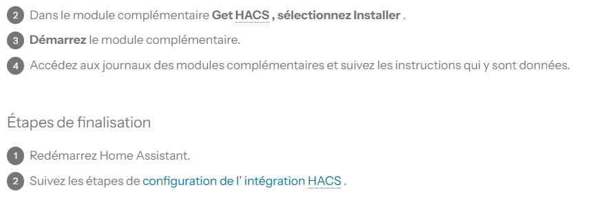

j’aimerais installer ceci
merci
pas de souci.
il s’installe, demarre et s’arrete.
INFO: Remember to restart Home Assistant before you configure it
[14:44:27] INFO: ------------------------------------
[14:44:27] INFO: Starting HACS download...
[14:44:27] INFO: Channel: current
Connecting to raw.githubusercontent.com (185.199.110.133:443)
saving to './get-hacs'
get-hacs             100% |********************************|  4990  0:00:00 ETA
'./get-hacs' saved
INFO: Trying to find the correct directory...
INFO: Found Home Assistant configuration directory at '/homeassistant'
INFO: Changing to the custom_components directory...
INFO: Downloading HACS
Connecting to github.com (140.82.121.4:443)
Connecting to release-assets.githubusercontent.com (185.199.108.133:443)
saving to 'hacs.zip'
hacs.zip             100% |********************************| 18.1M  0:00:00 ETA
'hacs.zip' saved
WARN: HACS directory already exist, cleaning up...
INFO: Creating HACS directory...
INFO: Unpacking HACS...
INFO: Verifying versions
INFO: Current version is 2025.7.2, minimum version is 2024.4.1
INFO: Removing HACS zip file...
INFO: Installation complete.
[15:04:11] INFO: ------------------------------------
[15:04:11] INFO: Starting HACS download...
[15:04:11] INFO: Channel: current
Connecting to raw.githubusercontent.com (185.199.108.133:443)
'./get-hacs' saved
'hacs.zip' saved

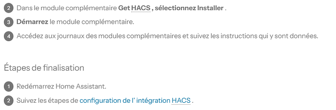

tu a redémarrer home assistant après l’installation ?
C'est normal, l'addon sert juste à installer HACS, donc elle se lance, installe HACS et s'arrête.
Après, il faut redémarrer HA.
Après redémarrage de HA :
ok c’est bon tout roule
