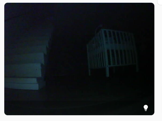

Petit soucis pour intégrer mon Esp32cam alors qu'il apparait sur le tableau de bord.
Ayant cherché de mon coté sans avoir trouvé, je me tourne vers vous..
Merci à vous

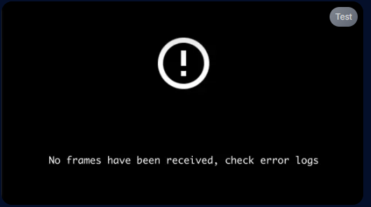

Les logs de Frigate
2025-03-01 17:37:13.851159449  [2025-03-01 18:37:13] watchdog.test                  ERROR   : Ffmpeg process crashed unexpectedly for test.
2025-03-01 17:37:13.851252551  [2025-03-01 18:37:13] watchdog.test                  ERROR   : The following ffmpeg logs include the last 100 lines prior to exit.
2025-03-01 17:37:13.851266052  [2025-03-01 18:37:13] ffmpeg.test.detect             ERROR   : [tcp @ 0x559ef45cc0] Connection to tcp://192.168.0.113:8080 failed: Connection timed out
2025-03-01 17:37:13.851332411  [2025-03-01 18:37:13] ffmpeg.test.detect             ERROR   : http://192.168.0.113:8080: Connection timed out
2025-03-01 17:37:18.972212244  [2025-03-01 18:37:18] frigate.video                  ERROR   : test: Unable to read frames from ffmpeg process.
2025-03-01 17:37:18.973129268  [2025-03-01 18:37:18] frigate.video                  ERROR   : test: ffmpeg process is not running. exiting capture thread...
2025-03-01 17:37:23.873208392  [2025-03-01 18:37:23] watchdog.test                  ERROR   : Ffmpeg process crashed unexpectedly for test.
2025-03-01 17:37:23.873313824  [2025-03-01 18:37:23] watchdog.test                  ERROR   : The following ffmpeg logs include the last 100 lines prior to exit.
2025-03-01 17:37:23.873329799  [2025-03-01 18:37:23] ffmpeg.test.detect             ERROR   : [tcp @ 0x55a3201cc0] Connection to tcp://192.168.0.113:8080 failed: Connection timed out
2025-03-01 17:37:23.874101436  [2025-03-01 18:37:23] ffmpeg.test.detect             ERROR   : http://192.168.0.113:8080: Connection timed out
2025-03-01 17:37:28.991549255  [2025-03-01 18:37:28] frigate.video                  ERROR   : test: Unable to read frames from ffmpeg process.
2025-03-01 17:37:28.991970224  [2025-03-01 18:37:28] frigate.video                  ERROR   : test: ffmpeg process is not running. exiting capture thread...

voici la solution que j’utilise à l’époque
Pareil que le message précédent, je te joins mon code frigate.
Partie go2RTC avec mon ESPCAM
go2rtc:
  streams:
    mjpeg_cam: ffmpeg:http://192.168.1.81:8080#video=h264#hardware
Dans la partie « camera: » avec l’IP de ton container
piscine:
    enabled: true
    ffmpeg:
      inputs:
        - path: rtsp://127.0.0.1:8554/mjpeg_cam
          roles:
            - detect
            - record
@Gael1980 @Manu663 Sauvé! Merci à vous!
