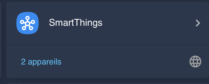

Suite à la mise à jour de 2026.4.1 (pas sûre de la cause ), la configuration de l’intégration est en échec. Quelqu’un a des conseils ? merci en avance.

Le log me donne ceci :
Enregistreur: homeassistant.config_entries
Source: config_entries.py:769
S'est produit pour la première fois: 06:37:02 (1 occurrence)
Dernier enregistrement: 06:37:02
Error setting up entry Mon domicile for smartthings
  File "/usr/src/homeassistant/homeassistant/config_entries.py", line 769, in __async_setup_with_context
    result = await component.async_setup_entry(hass, self)
  File "/usr/src/homeassistant/homeassistant/components/smartthings/__init__.py", line 142, in async_setup_entry
    await session.async_ensure_token_valid()
  File "/usr/src/homeassistant/homeassistant/helpers/config_entry_oauth2_flow.py", line 753, in async_ensure_token_valid
    new_token = await self.implementation.async_refresh_token(self.token)
  File "/usr/src/homeassistant/homeassistant/helpers/config_entry_oauth2_flow.py", line 135, in async_refresh_token
    new_token = await self._async_refresh_token(token)
  File "/usr/src/homeassistant/homeassistant/components/cloud/account_link.py", line 149, in _async_refresh_token
    new_token = await account_link.async_fetch_access_token(
        self.hass.data[DATA_CLOUD], self.service, token["refresh_token"]
  File "/usr/local/lib/python3.14/site-packages/hass_nabucasa/account_link.py", line 122, in async_fetch_access_token
    resp.raise_for_status()
  File "/usr/local/lib/python3.14/site-packages/aiohttp/client_reqrep.py", line 636, in raise_for_status
    raise ClientResponseError(
    ...<5 lines>...
aiohttp.client_exceptions.ClientResponseError: 400, message='Bad Request', url='https://account-link.nabucasa.com/refresh_token/smartthings'

La suppression et la réactivation de SmartThings ont permis de rétablir le fonctionnement.
Ça fonctionne.
