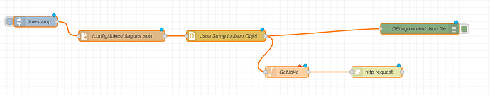

Je réussis à le lire : es blagues sont sur 2 lignes (question =setup & réponse =delivery)
NodeRed noeuds
"id": "15c33a53cd75773b",
"type": "file in",
"z": "20d5c36c60b1a5e6",
"name": "",
"filename": "/config/Jokes/blagues.json",
"filenameType": "str",
"format": "utf8",
"chunk": false,
"sendError": false,
"encoding": "utf8",
"allProps": false,
"x": 320,
"y": 640,
"wires": [
"5cc6e99793bc4d7d"
"id": "d39b1e46968ef8db",
"type": "debug",
"name": "DEbug content Json file",
"active": true,
"tosidebar": true,
"console": false,
"tostatus": false,
"complete": "true",
"targetType": "full",
"statusVal": "",
"statusType": "auto",
"x": 1150,
"y": 620,
"wires": []
"id": "81890602d5baede6",
"type": "inject",
"name": "",
"props": [
"p": "payload"
"p": "topic",
"vt": "str"
"repeat": "",
"crontab": "",
"once": false,
"onceDelay": 0.1,
"topic": "",
"payload": "",
"payloadType": "date",
"x": 80,
"y": 600,
"wires": [
"15c33a53cd75773b"
"id": "5cc6e99793bc4d7d",
"type": "json",
"name": "Json String to Json Objet",
"property": "payload",
"action": "",
"pretty": false,
"x": 610,
"y": 640,
"wires": [
"d39b1e46968ef8db",
"5d3a22fa8158d720"
"id": "5d3a22fa8158d720",

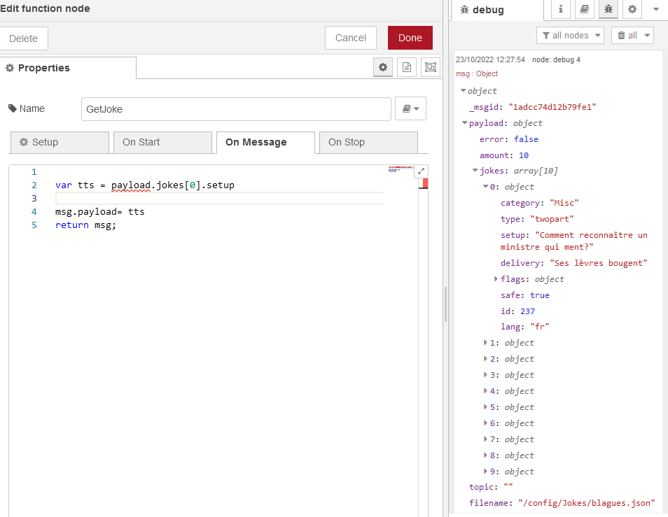

"type": "function",
"name": "GetJoke",
"func": "\nvar tts = payload.jokes[0].setup\n\nmsg.payload= tts\nreturn msg;",
"outputs": 1,
"noerr": 1,
"initialize": "",
"finalize": "",
"libs": [],
"x": 780,
"y": 740,
"wires": [
"35606b2bf84f5634"
"id": "35606b2bf84f5634",
"type": "http request",
"name": "",
"method": "POST",
"ret": "txt",
"paytoqs": "ignore",
"url": "http://homeassistant.local:12101/api/text-to-speech",
"tls": "",
"persist": false,
"proxy": "",
"insecureHTTPParser": false,
"authType": "",
"senderr": false,
"headers": [],
"credentials": {
"user": "",
"password": ""
"x": 1030,
"y": 740,
"wires": [

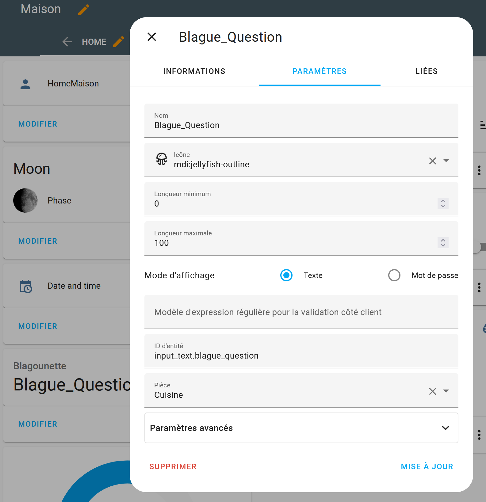

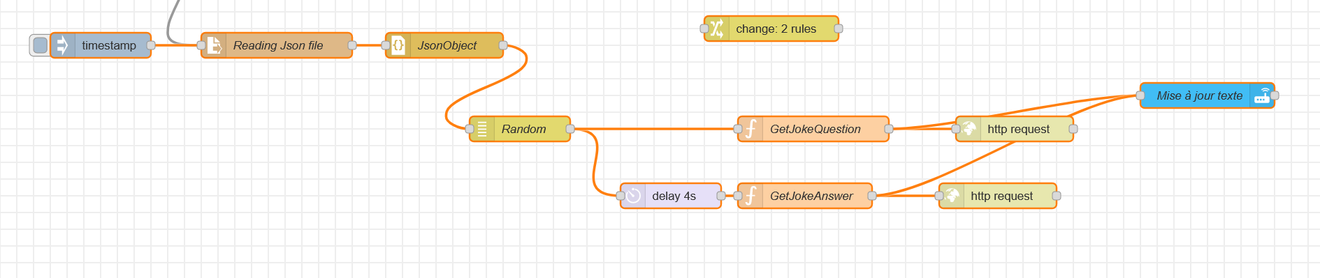

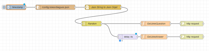

Monprobleme :
Pour le moment, je n’arrive pas à récupérer ces questions
La 2ème étape sera de piocher au hasard dans cette liste
Si vous savez comment me faire avancer, je serais très heureux !
merci bcp
