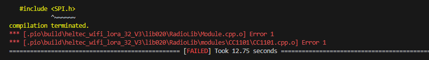

Même problème chez moi, j’ai l’impression que c’est une histoire de dépendances dans les librairies, pas encore trouvé de solution
Processing heltec_wifi_lora_32_V3 (platform: espressif32; board: heltec_wifi_lora_32_V3; framework: arduino)
Verbose mode can be enabled via `-v, --verbose` option
CONFIGURATION: https://docs.platformio.org/page/boards/espressif32/heltec_wifi_lora_32_V3.html
PLATFORM: Espressif 32 (6.5.0) > Heltec WiFi LoRa 32 (V3)
HARDWARE: ESP32S3 240MHz, 320KB RAM, 8MB Flash
DEBUG: Current (cmsis-dap) External (cmsis-dap, esp-bridge, esp-builtin, esp-prog, iot-bus-jtag, jlink, minimodule, olimex-arm-usb-ocd, olimex-arm-usb-ocd-h, olimex-arm-usb-tiny-h, olimex-jtag-tiny, tumpa)
PACKAGES:
 - framework-arduinoespressif32 @ 3.20014.231204 (2.0.14)
 - tool-esptoolpy @ 1.40501.0 (4.5.1)
 - toolchain-riscv32-esp @ 8.4.0+2021r2-patch5
 - toolchain-xtensa-esp32s3 @ 8.4.0+2021r2-patch5
LDF: Library Dependency Finder -> https://bit.ly/configure-pio-ldf
LDF Modes: Finder ~ chain, Compatibility ~ soft
Found 39 compatible libraries
Scanning dependencies...
Dependency Graph
|-- ArduinoOTA @ 2.0.0
|-- Wire @ 2.0.0
|-- RadioLib @ 6.3.0
|-- PubSubClient @ 2.8.0
|-- Heltec ESP32 Dev-Boards @ 1.1.2
|-- heltec-eink-modules @ 3.1.1
|-- ESP32_LoRaWAN @ 2.1.1
Building in debug mode
Building .pio\build\heltec_wifi_lora_32_V3\bootloader.bin
Generating partitions .pio\build\heltec_wifi_lora_32_V3\partitions.bin
esptool.py v4.5.1
Creating esp32s3 image...
Merged 1 ELF section
Successfully created esp32s3 image.
Compiling .pio\build\heltec_wifi_lora_32_V3\lib53b\ArduinoOTA\ArduinoOTA.cpp.o
Compiling .pio\build\heltec_wifi_lora_32_V3\libaf1\Wire\Wire.cpp.o
.pio/libdeps/heltec_wifi_lora_32_V3/ArduinoOTA/src/ArduinoOTA.cpp:5:10: fatal error: WiFiUdp.h: No such file or directory
* Looking for WiFiUdp.h dependency? Check our library registry!
* CLI  > platformio lib search "header:WiFiUdp.h"
* Web  > https://registry.platformio.org/search?q=header:WiFiUdp.h
 #include <WiFiUdp.h>
compilation terminated.
Compiling .pio\build\heltec_wifi_lora_32_V3\libbf5\RadioLib\ArduinoHal.cpp.o
Compiling .pio\build\heltec_wifi_lora_32_V3\libbf5\RadioLib\Hal.cpp.o
Compiling .pio\build\heltec_wifi_lora_32_V3\libbf5\RadioLib\Module.cpp.o
Compiling .pio\build\heltec_wifi_lora_32_V3\libbf5\RadioLib\modules\CC1101\CC1101.cpp.o
Compiling .pio\build\heltec_wifi_lora_32_V3\libbf5\RadioLib\modules\LLCC68\LLCC68.cpp.o
Compiling .pio\build\heltec_wifi_lora_32_V3\libbf5\RadioLib\modules\RF69\RF69.cpp.o
Compiling .pio\build\heltec_wifi_lora_32_V3\libbf5\RadioLib\modules\SX1231\SX1231.cpp.o
Compiling .pio\build\heltec_wifi_lora_32_V3\libbf5\RadioLib\modules\SX126x\STM32WLx.cpp.o
*** [.pio\build\heltec_wifi_lora_32_V3\lib53b\ArduinoOTA\ArduinoOTA.cpp.o] Error 1
In file included from .pio/libdeps/heltec_wifi_lora_32_V3/RadioLib/src/ArduinoHal.cpp:1:
.pio/libdeps/heltec_wifi_lora_32_V3/RadioLib/src/ArduinoHal.h:16:10: fatal error: SPI.h: No such file or directory
* Looking for SPI.h dependency? Check our library registry!
* CLI  > platformio lib search "header:SPI.h"
* Web  > https://registry.platformio.org/search?q=header:SPI.h
 #include <SPI.h>
*** [.pio\build\heltec_wifi_lora_32_V3\libbf5\RadioLib\ArduinoHal.cpp.o] Error 1
In file included from .pio/libdeps/heltec_wifi_lora_32_V3/RadioLib/src/modules/CC1101/CC1101.h:5,
                 from .pio/libdeps/heltec_wifi_lora_32_V3/RadioLib/src/modules/CC1101/CC1101.cpp:1:
.pio/libdeps/heltec_wifi_lora_32_V3/RadioLib/src/modules/CC1101/../../Module.h:8:12: fatal error: SPI.h: No such file or directory
   #include <SPI.h>
*** [.pio\build\heltec_wifi_lora_32_V3\libbf5\RadioLib\modules\CC1101\CC1101.cpp.o] Error 1
In file included from .pio/libdeps/heltec_wifi_lora_32_V3/RadioLib/src/modules/LLCC68/LLCC68.h:8,
                 from .pio/libdeps/heltec_wifi_lora_32_V3/RadioLib/src/modules/LLCC68/LLCC68.cpp:1:
.pio/libdeps/heltec_wifi_lora_32_V3/RadioLib/src/modules/LLCC68/../../Module.h:8:12: fatal error: SPI.h: No such file or directory
   #include <SPI.h>
In file included from .pio/libdeps/heltec_wifi_lora_32_V3/RadioLib/src/Module.cpp:1:
.pio/libdeps/heltec_wifi_lora_32_V3/RadioLib/src/Module.h:8:12: fatal error: SPI.h: No such file or directory
   #include <SPI.h>
*** [.pio\build\heltec_wifi_lora_32_V3\libbf5\RadioLib\modules\LLCC68\LLCC68.cpp.o] Error 1
*** [.pio\build\heltec_wifi_lora_32_V3\libbf5\RadioLib\Module.cpp.o] Error 1
In file included from .pio/libdeps/heltec_wifi_lora_32_V3/RadioLib/src/modules/SX1231/SX1231.h:8,
                 from .pio/libdeps/heltec_wifi_lora_32_V3/RadioLib/src/modules/SX1231/SX1231.cpp:1:
.pio/libdeps/heltec_wifi_lora_32_V3/RadioLib/src/modules/SX1231/../../Module.h:8:12: fatal error: SPI.h: No such file or directory
   #include <SPI.h>
In file included from .pio/libdeps/heltec_wifi_lora_32_V3/RadioLib/src/modules/RF69/RF69.h:8,
                 from .pio/libdeps/heltec_wifi_lora_32_V3/RadioLib/src/modules/RF69/RF69.cpp:1:
.pio/libdeps/heltec_wifi_lora_32_V3/RadioLib/src/modules/RF69/../../Module.h:8:12: fatal error: SPI.h: No such file or directory
   #include <SPI.h>
*** [.pio\build\heltec_wifi_lora_32_V3\libbf5\RadioLib\modules\SX1231\SX1231.cpp.o] Error 1
*** [.pio\build\heltec_wifi_lora_32_V3\libbf5\RadioLib\modules\RF69\RF69.cpp.o] Error 1
===================================================================================== [FAILED] Took 6.25 seconds =====================================================================================

Toujours des erreurs …
Sous Arduino IDE , la carte n’est pas reconnue :grimacing:
j’ai celle du lien plus haut, Seamuing
Sous ArduinoIDE, il faut suivre la procédure du site Heltec pour ajouter les dernières versions des cartes ainsi que les librairies.
https://docs.heltec.org/en/node/esp32/esp32_general_docs/quick_start.html
Sous VSCode + PlateformIO, il faut créer un projet puis charger toutes les librairies nécessaires.
Normalement, la liste des librairies associées au projet est dans le fichier platformio.ini qui doit se trouver au même niveau que le répertoire src alors que le fichier .cpp doit se trouver dans le répertoire src.

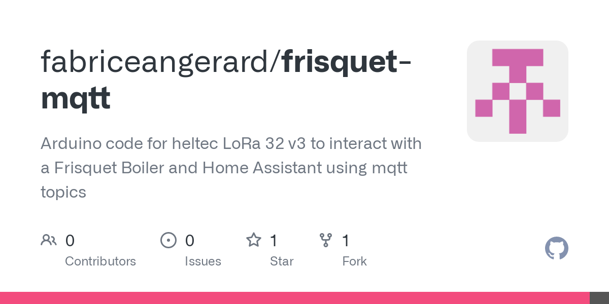

@Didier67 ,
Il faut suivre ce qui est indiqué dans le readme sur GitHub et complèter le code avec vos propres user / mdp, ainsi que vos ID tels que récupérés en commençant pas charger le petit bout de code indiqué également dans le readme.

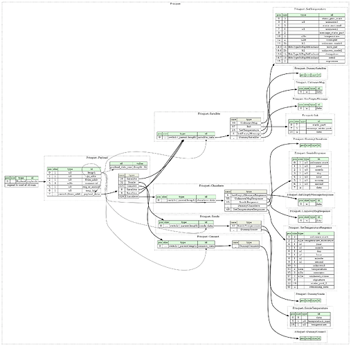

Super initiative, mais une partie du decodage du protocole est déjà écrite dans le fichier ksy de mon repository github sx1211-arduino/frisquet.ksy at master · mgrenonville/sx1211-arduino · GitHub, et avec le code deku rust, il y a les briques manquantes.
Voici un extrait image du protocole, via kaitai struct + conversion en graphviz.
Pour info, la taille seule ne permet pas d’identifier un message à coup sur, il faut passer par le from / to + la taille du message.
La temperature est codée en multipliant par 10, sur 2 octets, en signed int. Donc quand on passe dans le négatif, on obtient des valeurs en complément à 2 (si je dis pas de bêtises)
Si je dis pas de bêtises, @0xd33d33 a déjà en grande partie décodé le protocole de connect, et pour ma part, avec l’aide de @jnilo, j’ai décodé celui de la sonde extérieure.
Le protocole du satellite est assez facile et se compose de deux messages, eux aussi décodés.
