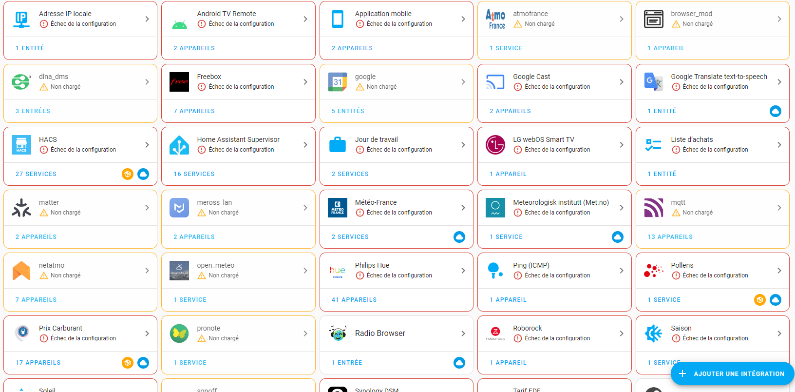

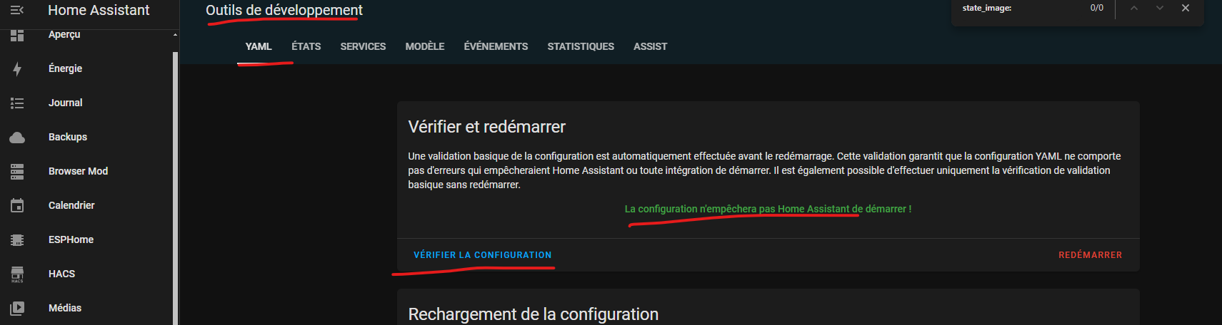

Problème de démarrage - Intégrations ne se charge pas
Comme le montre l’image tout en bas de ce post et les différentes erreurs et warning, j’ai un soucis avec mon Home Assistant au démarrage.
Très lent et surtout les intégrations ne ce charge pas.
J’ai mis les logs du démarrage
Avez vous un conseil pour résoudre mon problème ? Merci

  File "/usr/src/homeassistant/homeassistant/loader.py", line 1126, in async_get_platforms
    await self.hass.async_add_import_executor_job(
asyncio.exceptions.CancelledError: Global task timeout
  File "/usr/src/homeassistant/homeassistant/helpers/discovery.py", line 166, in async_load_platform
    setup_success = await setup.async_setup_component(hass, component, hass_config)
  File "/usr/src/homeassistant/homeassistant/setup.py", line 160, in async_setup_component
    return await existing_setup_future
asyncio.exceptions.InvalidStateError: invalid state
2024-05-25 12:04:36.359 ERROR (MainThread) [homeassistant] Error doing job: Task exception was never retrieved
2024-05-25 12:04:52.971 WARNING (MainThread) [homeassistant.bootstrap] Waiting on integrations to complete setup: {('roborock', '708b24635aaf12d66e881f0201676341'): 372640.095796269, ('season', '71d9024d851cdad33f975b144239fe2d'): 372640.499140195, ('meteo_france', '304deab2747cd01555b851a409cecf50'): 372640.62139208, ('meteo_france', 'c5cb9f48075accc3ccde062ddca32509'): 372640.623744776, ('prix_carburant', '91b7fb007dfde5a854505a3b32e34b82'): 372640.625746425, ('freebox', '82d083563150fb72a93c9a0da75874c3'): 372647.815552278, ('webostv', '9a6f35ec2d2a5ada6da88b6b523d6811'): 372656.446688979, ('cast', '2daffdd4997a361cbf699e5e7bdc264d'): 372666.916595383, ('pollens', '66f39417acb08abc8f32ca84ef560ed6'): 372668.947759902, ('tarif_edf', '38d1c505ab1793fb61be734f66ba4162'): 372668.987728899, ('androidtv_remote', 'd4259a7e40db7987d217187fef5af370'): 372671.766102671, ('androidtv_remote', '7525f3cb36bd8bb94d4293f1f9fd91c2'): 372671.774521374, ('hue', 'e6e69f0018838d81ec72c53fa42b102a'): 372686.047306995, ('workday', 'c012e73e77787851ca601a8d2802a858'): 372687.159271333, ('workday', '77fda4d32ba17b6acfc3feec9e61b559'): 372687.160840556, ('synology_dsm', '47939ebcbeef259eae59af48b46be7eb'): 372692.66221197, ('ping', 'e1ed1da34756b383bdb96647bc7af739'): 372695.761310624, ('met', 'e0365e5e374bc71b4ce6809a3fbafbd2'): 372695.79036197, ('local_ip', '6f79565b68e37171da89c9f788ca258b'): 372695.79672573, ('upnp', '4875bcbfb950422e9dd7ffac067f3e27'): 372696.694482881, ('google_translate', '5d9bd6d765464be00b7d036e6b3d7d0c'): 372696.750909613, ('shopping_list', '83217708b2dadf8895a1ec76a3ac5dbf'): 372706.496212058, ('holiday', '65d78a333b7f538f0d8b3e652f9b79bc'): 372709.081584437, ('holiday', '6b0e31d269bb7ca642202b479706ee91'): 372709.082362389}
2024-05-25 12:05:27.123 ERROR (ImportExecutor_0) [homeassistant] Error doing job: Task exception was never retrieved
2024-05-25 12:05:29.474 WARNING (MainThread) [homeassistant.helpers.frame] Detected that custom integration 'hacs' accesses hass.components.frontend. This is deprecated and will stop working in Home Assistant 2024.9, it should be updated to import functions used from frontend directly at custom_components/hacs/frontend.py, line 68: hass.components.frontend.async_register_built_in_panel(, please create a bug report at https://github.com/hacs/integration/issues
2024-05-25 12:05:57.443 WARNING (MainThread) [homeassistant.bootstrap] Waiting on integrations to complete setup: {('roborock', '708b24635aaf12d66e881f0201676341'): 372640.095796269, ('season', '71d9024d851cdad33f975b144239fe2d'): 372640.499140195, ('meteo_france', '304deab2747cd01555b851a409cecf50'): 372640.62139208, ('meteo_france', 'c5cb9f48075accc3ccde062ddca32509'): 372640.623744776, ('prix_carburant', '91b7fb007dfde5a854505a3b32e34b82'): 372640.625746425, ('freebox', '82d083563150fb72a93c9a0da75874c3'): 372647.815552278, ('webostv', '9a6f35ec2d2a5ada6da88b6b523d6811'): 372656.446688979, ('cast', '2daffdd4997a361cbf699e5e7bdc264d'): 372666.916595383, ('pollens', '66f39417acb08abc8f32ca84ef560ed6'): 372668.947759902, ('tarif_edf', '38d1c505ab1793fb61be734f66ba4162'): 372668.987728899, ('androidtv_remote', 'd4259a7e40db7987d217187fef5af370'): 372671.766102671, ('androidtv_remote', '7525f3cb36bd8bb94d4293f1f9fd91c2'): 372671.774521374, ('hue', 'e6e69f0018838d81ec72c53fa42b102a'): 372686.047306995, ('workday', 'c012e73e77787851ca601a8d2802a858'): 372687.159271333, ('workday', '77fda4d32ba17b6acfc3feec9e61b559'): 372687.160840556, ('synology_dsm', '47939ebcbeef259eae59af48b46be7eb'): 372692.66221197, ('ping', 'e1ed1da34756b383bdb96647bc7af739'): 372695.761310624, ('met', 'e0365e5e374bc71b4ce6809a3fbafbd2'): 372695.79036197, ('local_ip', '6f79565b68e37171da89c9f788ca258b'): 372695.79672573, ('upnp', '4875bcbfb950422e9dd7ffac067f3e27'): 372696.694482881, ('google_translate', '5d9bd6d765464be00b7d036e6b3d7d0c'): 372696.750909613, ('shopping_list', '83217708b2dadf8895a1ec76a3ac5dbf'): 372706.496212058, ('holiday', '65d78a333b7f538f0d8b3e652f9b79bc'): 372709.081584437, ('holiday', '6b0e31d269bb7ca642202b479706ee91'): 372709.082362389, ('hacs', '2e81929c80a2d8d2f35db5d972dc1b4a'): 372749.609494233}
2024-05-25 12:06:58.820 WARNING (MainThread) [homeassistant.bootstrap] Waiting on integrations to complete setup: {('roborock', '708b24635aaf12d66e881f0201676341'): 372640.095796269, ('season', '71d9024d851cdad33f975b144239fe2d'): 372640.499140195, ('meteo_france', '304deab2747cd01555b851a409cecf50'): 372640.62139208, ('meteo_france', 'c5cb9f48075accc3ccde062ddca32509'): 372640.623744776, ('prix_carburant', '91b7fb007dfde5a854505a3b32e34b82'): 372640.625746425, ('freebox', '82d083563150fb72a93c9a0da75874c3'): 372647.815552278, ('webostv', '9a6f35ec2d2a5ada6da88b6b523d6811'): 372656.446688979, ('cast', '2daffdd4997a361cbf699e5e7bdc264d'): 372666.916595383, ('pollens', '66f39417acb08abc8f32ca84ef560ed6'): 372668.947759902, ('tarif_edf', '38d1c505ab1793fb61be734f66ba4162'): 372668.987728899, ('androidtv_remote', 'd4259a7e40db7987d217187fef5af370'): 372671.766102671, ('androidtv_remote', '7525f3cb36bd8bb94d4293f1f9fd91c2'): 372671.774521374, ('hue', 'e6e69f0018838d81ec72c53fa42b102a'): 372686.047306995, ('workday', 'c012e73e77787851ca601a8d2802a858'): 372687.159271333, ('workday', '77fda4d32ba17b6acfc3feec9e61b559'): 372687.160840556, ('synology_dsm', '47939ebcbeef259eae59af48b46be7eb'): 372692.66221197, ('ping', 'e1ed1da34756b383bdb96647bc7af739'): 372695.761310624, ('met', 'e0365e5e374bc71b4ce6809a3fbafbd2'): 372695.79036197, ('local_ip', '6f79565b68e37171da89c9f788ca258b'): 372695.79672573, ('upnp', '4875bcbfb950422e9dd7ffac067f3e27'): 372696.694482881, ('google_translate', '5d9bd6d765464be00b7d036e6b3d7d0c'): 372696.750909613, ('shopping_list', '83217708b2dadf8895a1ec76a3ac5dbf'): 372706.496212058, ('holiday', '65d78a333b7f538f0d8b3e652f9b79bc'): 372709.081584437, ('holiday', '6b0e31d269bb7ca642202b479706ee91'): 372709.082362389, ('hacs', '2e81929c80a2d8d2f35db5d972dc1b4a'): 372749.609494233}
2024-05-25 12:07:18.713 ERROR (MainThread) [homeassistant.config_entries] Error setting up entry lepalois@gmail.com for roborock
  File "/usr/src/homeassistant/homeassistant/config_entries.py", line 584, in async_setup
    result = await component.async_setup_entry(hass, self)
  File "/usr/src/homeassistant/homeassistant/components/roborock/__init__.py", line 81, in async_setup_entry
    await hass.config_entries.async_forward_entry_setups(entry, PLATFORMS)
  File "/usr/src/homeassistant/homeassistant/config_entries.py", line 1959, in async_forward_entry_setups
    await integration.async_get_platforms(platforms)
  File "/usr/src/homeassistant/homeassistant/loader.py", line 1156, in async_get_platforms
    import_future.result()
  [Previous line repeated 6 more times]
2024-05-25 12:07:18.732 ERROR (MainThread) [homeassistant.config_entries] Error setting up entry Season for season
  File "/usr/src/homeassistant/homeassistant/components/season/__init__.py", line 11, in async_setup_entry
2024-05-25 12:07:18.739 ERROR (MainThread) [homeassistant.config_entries] Error setting up entry Pau - Aquitaine (64) - FR for meteo_france
  File "/usr/src/homeassistant/homeassistant/components/meteo_france/__init__.py", line 145, in async_setup_entry
  File "/usr/src/homeassistant/homeassistant/loader.py", line 1174, in async_get_platforms
    platforms[platform_name] = await future
2024-05-25 12:07:18.746 ERROR (MainThread) [homeassistant.config_entries] Error setting up entry Eaux-Bonnes - Aquitaine (64) - FR for meteo_france
  File "/usr/src/homeassistant/homeassistant/loader.py", line 1151, in async_get_platforms
    import_future.set_exception(ex)
2024-05-25 12:07:18.757 ERROR (MainThread) [homeassistant.config_entries] Error setting up entry Prix Carburant for prix_carburant
  File "/config/custom_components/prix_carburant/__init__.py", line 89, in async_setup_entry
2024-05-25 12:07:18.787 ERROR (MainThread) [homeassistant.config_entries] Error setting up entry t43v2e39.fbxos.fr for freebox
  File "/usr/src/homeassistant/homeassistant/components/freebox/__init__.py", line 41, in async_setup_entry
  [Previous line repeated 4 more times]
2024-05-25 12:07:18.800 ERROR (MainThread) [homeassistant.config_entries] Error setting up entry [LG] webOS TV UK6200PLA for webostv
  File "/usr/src/homeassistant/homeassistant/components/webostv/__init__.py", line 105, in async_setup_entry
2024-05-25 12:07:18.808 ERROR (MainThread) [homeassistant.config_entries] Error setting up entry Google Cast for cast
  File "/usr/src/homeassistant/homeassistant/components/cast/__init__.py", line 30, in async_setup_entry
2024-05-25 12:07:18.829 ERROR (MainThread) [homeassistant.config_entries] Error setting up entry Pollens Pyrénées-Atlantiques for pollens
  File "/config/custom_components/pollens/__init__.py", line 86, in async_setup_entry
2024-05-25 12:07:18.849 ERROR (MainThread) [homeassistant.config_entries] Error setting up entry Option BASE, 6kVA for tarif_edf
  File "/config/custom_components/tarif_edf/__init__.py", line 35, in async_setup_entry
2024-05-25 12:07:18.863 ERROR (MainThread) [homeassistant.config_entries] Error setting up entry Freebox Player POP for androidtv_remote
  File "/usr/src/homeassistant/homeassistant/components/androidtv_remote/__init__.py", line 69, in async_setup_entry
2024-05-25 12:07:18.869 ERROR (MainThread) [homeassistant.config_entries] Error setting up entry choupinette for androidtv_remote
2024-05-25 12:07:18.878 ERROR (MainThread) [homeassistant.config_entries] Error setting up entry Hue Bridge 001788761e19 for hue
  File "/usr/src/homeassistant/homeassistant/components/hue/__init__.py", line 23, in async_setup_entry
    if not await bridge.async_initialize_bridge():
  File "/usr/src/homeassistant/homeassistant/components/hue/bridge.py", line 116, in async_initialize_bridge
    await self.hass.config_entries.async_forward_entry_setups(

    self.environment.handle_exception()
  File "/usr/local/lib/python3.12/site-packages/jinja2/environment.py", line 939, in handle_exception
    raise rewrite_traceback_stack(source=source)
  File "<template>", line 2, in top-level template code
TypeError: '<' not supported between instances of 'str' and 'NoneType'
  File "/usr/src/homeassistant/homeassistant/helpers/template.py", line 713, in async_render_to_info
    render_info._result = self.async_render(
  File "/usr/src/homeassistant/homeassistant/helpers/template.py", line 587, in async_render
    raise TemplateError(err) from err
homeassistant.exceptions.TemplateError: TypeError: '<' not supported between instances of 'str' and 'NoneType'
2024-05-25 12:07:45.659 ERROR (MainThread) [homeassistant.components.template.template_entity] TemplateError('TypeError: '<' not supported between instances of 'str' and 'NoneType'') while processing template 'Template<template=({% set aujourdhui = now().strftime('%Y-%m-%d')%}
{% if aujourdhui < state_attr('sensor.vacances_scolaires', 'start_date') or aujourdhui > state_attr('sensor.vacances_scolaires', 'end_date') %}
false
true
{% endif %}) renders=4>' for attribute '_state' in entity 'binary_sensor.vacances_scolaires_aujourdhui'
2024-05-25 12:07:45.664 ERROR (MainThread) [homeassistant.helpers.event] Error while processing template: Template<template=({% set demain = (as_timestamp(now()) + (24*3600)) | timestamp_custom('%Y-%m-%d', True) %}
{% if demain < state_attr('sensor.vacances_scolaires', 'start_date') or demain > state_attr('sensor.vacances_scolaires', 'end_date') %}
false
true
{% endif %}) renders=2>
  File "/usr/src/homeassistant/homeassistant/helpers/template.py", line 585, in async_render
    render_result = _render_with_context(self.template, compiled, **kwargs)
  File "/usr/src/homeassistant/homeassistant/helpers/template.py", line 2600, in _render_with_context
    return template.render(**kwargs)
  File "/usr/local/lib/python3.12/site-packages/jinja2/environment.py", line 1304, in render
2024-05-25 12:07:45.670 ERROR (MainThread) [homeassistant.components.template.template_entity] TemplateError('TypeError: '<' not supported between instances of 'str' and 'NoneType'') while processing template 'Template<template=({% set demain = (as_timestamp(now()) + (24*3600)) | timestamp_custom('%Y-%m-%d', True) %}
false
true
{% endif %}) renders=4>' for attribute '_state' in entity 'binary_sensor.vacances_scolaires_demain'
2024-05-25 12:07:48.527 ERROR (Recorder) [homeassistant] Error doing job: Task exception was never retrieved
  File "/usr/src/homeassistant/homeassistant/components/mobile_app/__init__.py", line 134, in async_setup_entry
  File "/usr/src/homeassistant/homeassistant/config_entries.py", line 1960, in async_forward_entry_setups
    await asyncio.gather(
  File "/usr/src/homeassistant/homeassistant/config_entries.py", line 1988, in _async_forward_entry_setup
    result = await async_setup_component(
2024-05-25 12:08:06.367 WARNING (ImportExecutor_0) [homeassistant.helpers.typing] HomeAssistantType was used from aqara_gateway, this is a deprecated alias which will be removed in HA Core 2025.5. Use homeassistant.core.HomeAssistant instead, please report it to the author of the 'aqara_gateway' custom integration

N’oublie pas de valider la config avant de relancer :
Il peut même faire redémarrer directement, car sa check aussi la configuration et t’ouvre la fenêtre de choix si c’est OK. Sa économise 1 click :crazy_face:
Oui sauf que manifestement ça démarre (a démarré) avec une config bancale, d’où l’importance du test explicite à mon avis
Possible, j’ai jamais essayer avec une configuration invalide. J’aime pas jouer avec le feu :sweat_smile:
En théorie ca devrais bloquer et au pire des cas tu verra un message configuration invalide en arrière plan.
Oui en principe, ça bloque, le seul cas que je peux imaginer c’est une sauvegarde de config bancale, pas de vérif manuelle, puis un reboot électrique surprise Et là c’est le drame
