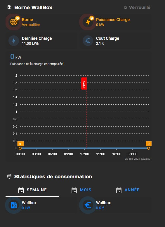

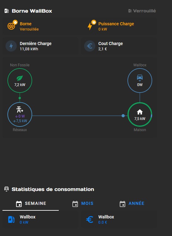

@Sigalou merci pour le partage des images mais la borne Wallbox socket plus n’a pas exactement les mêmes statuts, je n’ai donc pas pu utiliser tes créations :wink: dans ma lovelace ! Dommage !!
Ci-dessous le dashboard pour la borne :

                    entity: sensor.wallbox_pulsar_plus_charging_power
                    fill_container: true
                    layout: horizontal
                    badge_icon: >-
                      {% set temp =
                      states('sensor.wallbox_pulsar_plus_charging_power') |
                      float %}
                      {% if temp == 0 %}
                      mdi:lock
                      mdi:check-bold
                    badge_color: ''
                    card_mod:
                      style:
                        mushroom-state-info$: |
                          .container {
                              {% set temp = states('sensor.wallbox_pulsar_plus_charging_power') | float %}
                              {% if temp == 0 %}
                              --card-primary-color: orange ;
                              --card-secondary-color: orange;
                              --card-primary-color: ;
                                --card-secondary-color: #0080FF;
                        mushroom-badge-icon$: |
                          .badge {
                           {% if temp > 0 %}
                           animation: ping2 2s infinite;
                          @keyframes ping2 {
                                      0% {box-shadow: 0 0 0 0 rgba(var(--rgb-blue), 0.7);}
                                      70% {box-shadow: 0 0 0 10px transparent;}
                                      100% {box-shadow: 0 0 0 0 transparent;}
                        mushroom-shape-icon$: |
                          .shape {
                              {% if temp == 0 %}
                              --shape-animation: ping2 5s infinite;
                              --shape-color: none;
                              --shape-color-disabled: transparent !important;
                              --icon-symbol-size: 0.8em;
                              --icon-color: orange
                              --shape-animation: ping 5s infinite;
                              color:  #0080FF !important;
                              --icon-color:  #0080FF
                          @keyframes ping {
                                70% {box-shadow: 0 0 0 15px transparent;}
                          @keyframes ping2 {
                                0% {box-shadow: 0 0 0 0 rgba(var(--rgb-red), 0.7);}
                          mushroom-badge-icon {
                            {% if temp  == 0 %}
                            animation: wobbling 0.7s linear infinite alternate;
                            --main-color: orange !important;
                            --main-color: green !important;
                          @keyframes wobbling {
                            0% {transform: rotate(-80deg);}
                            100% {transform: rotate(40deg);}
          - type: tile
            entity: sensor.wallbox_pulsar_plus_added_energy
          - type: tile
            entity: sensor.prixcharge
            icon: mdi:currency-eur
          - type: custom:swipe-card
            card_width: 185px
            start_card: 1
            reset_after: 10
            parameters:
              spaceBetween: 8
              scrollbar:
                hide: true
                draggable: true
                snapOnRelease: true
              - type: custom:power-flow-card-plus
                  home:
                    entity: sensor.power_114
                    color_icon: null
                    override_state: true
                    use_metadata: false
                  fossil_fuel_percentage:
                    entity: sensor.co2_signal_grid_fossil_fuel_percentage
                    icon: mdi:leaf
                    color_icon: true
                    display_zero: true
                    state_type: power
                  grid:
                    icon: mdi:transmission-tower-export
                    entity:
                      consumption: sensor.power_114
                  individual:
                    - entity: sensor.wallbox_pulsar_plus_charging_power
                      color_icon: true
                      display_zero: true
                      color: steelblue
                      icon: mdi:car-electric
                clickable_entities: true
                use_new_flow_rate_model: true
                w_decimals: 0
                kw_decimals: 1
                min_flow_rate: 0.75
                max_expected_power: 10000
                min_expected_power: 1
                watt_threshold: 1000
                transparency_zero_lines: 0
                max_flow_rate: 6
              - type: custom:apexcharts-card
                experimental:
                  color_threshold: true
                graph_span: 24h
                show:
                  last_updated: true
                  loading: false
                header:
                  standard_format: false
                  show: true
                  show_states: true
                  colorize_states: true
                now:
                  show: true
                  color: red
                  label: Now
                span:
                  start: day
                series:
                    stroke_width: 5
                    color_threshold:
                      - value: 1000
                        color: steelblue
                      - value: 2000
                        color: midnightblue
                      - value: 3000
                        color: orange
                      - value: 4000
                        color: orangered
                      - value: 60000
                        color: red
                    group_by:
                      duration: 30sec
                    show:
                      extremas: true
                      header_color_threshold: true
                    header_actions:
                      tap_action:
                        action: navigate
                        navigation_path: /energy
          - type: heading
            icon: mdi:car-electric-outline
            heading: Statistiques de consommation
            heading_style: title
            badges: []
            tap_action:
              action: none
            card_mod:
              style:
                  ha-card {
                  font-family: "Days One";
          - type: custom:tabbed-card
