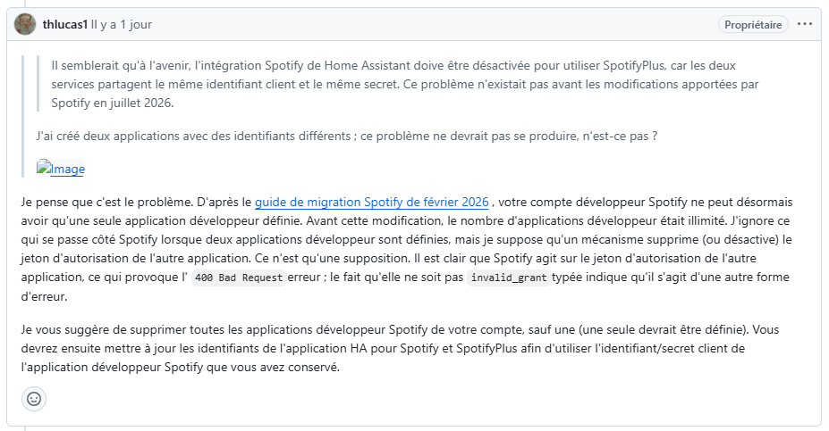

## Summary
Intermittent authorization failures when controlling playback (e.g. pressing "Next Track" on the SpotifyPlus media player card, or issuing `media_player`/`spotifyplus` service calls from automations/pyscript). The failing call is not the playback command itself — it appears to originate from a background "Spotify Connect Directory Task" trying to refresh the dynamic device list via `GetPlayerPlaybackState`.
## Environment
- SpotifyPlus version: Version v1.0.201
- Home Assistant Core version: 2026.7.2
- Installation method: Home Assistant OS/Supervised
- Spotify account: Premium (active subscription, not free tier)
- Media player affected: WiiM Pro (`media_player.wiim_pro_player`) via Spotify Connect
## Observed Error
Exact text captured from the SpotifyPlus media player card:
Control action failed: Spotify Connect Directory Task - Could not retrieve dynamic device list: SAM1001E - Spotify Web API returned an error status while processing the "GetPlayerPlaybackState" method. Status: 401 - Unauthorized Message: "Access token missing"
A second, differently-worded error ("Premium account required") is also seen intermittently for the same underlying action, despite the account being an active Premium subscription. This suggests "Premium account required" may be a misleading surface message for the same underlying auth-attachment failure rather than a real permissions issue.
## What I've Ruled Out
- **Not a Premium/permissions issue** — account is Premium, and the official Spotify desktop app works without issue at the same time.
- **Not (solely) a stale-credentials issue** — uninstalled and reinstalled the SpotifyPlus integration with fresh OAuth credentials; the intermittent errors continued afterward.
- **Not specific to the Lovelace card** — the same intermittent auth failures occur when calling SpotifyPlus/media_player services directly from Home Assistant automations/pyscript, not just from the UI card.
## Suspected Cause
The error text says "Access token missing" rather than "access token expired" — these read like distinct strings from Spotify's API. "Missing" suggests the outgoing request may have gone out with no Authorization header attached at all, rather than with a stale/expired one. Combined with:
- the failure occurring on a background "Spotify Connect Directory Task" rather than the user-initiated command itself, and
- an immediate retry usually succeeding, with no need to wait out a token expiry/refresh window,
this looks more like a race condition in when/how the access token gets attached to outgoing requests for this specific background device-list-refresh task, rather than a genuinely expired/invalid token or a Spotify-side outage.
### Reproduction steps
1. Use the SpotifyPlus media player card (or call a `spotifyplus.*`/`media_player.*` service from an automation or pyscript) to control playback — e.g. skip to next track.
2. Intermittently (not on every attempt) the action fails with an error banner instead of executing.
3. Retrying the same action — usually immediately, sometimes needs 2+ attempts — succeeds.

- Does the "Spotify Connect Directory Task" run on its own schedule/thread separate from the main token refresh logic? Could there be a window where it fires before a refresh completes, or after the token is cleared but before it's repopulated?
- Is there a debug logging flag that would help confirm this is a token-attachment timing issue rather than something Spotify-side?
Happy to provide debug logs, exact version numbers, and to test a patched build if that's useful.
