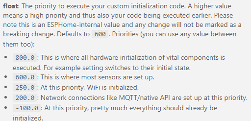

  on_boot:
    - priority: 800
      then:
        - switch.turn_on: relay
le priority a 800
