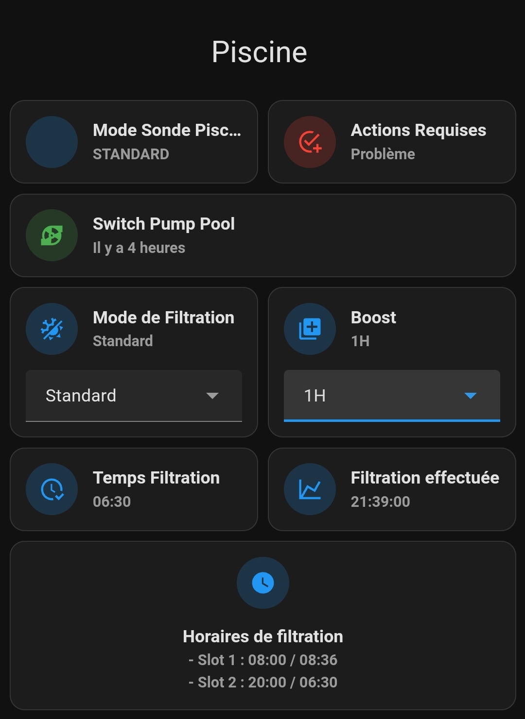

ci-dessous le code de l’app et ma config appdaemon
2023-06-02 19:46:22.910604 INFO pool_pump_manager: Initialized
2023-06-02 19:46:22.919178 CRITICAL pool_pump_manager: Entity defined in 'pump_sensor_id' configuration don't exist. Please update your configuration !
2023-06-02 19:46:22.924212 INFO pool_pump_manager: Error in configuration. Stopping app waiting configuration correction
2023-06-02 19:46:22.927094 DEBUG pool_pump_manager: call_service: app/stop, {'app': 'pool_pump_manager', 'namespace': 'admin', '__name': 'pool_pump_manager'}
2023-06-02 20:22:45.660484 INFO pool_pump_manager: Initialized
2023-06-02 20:22:45.675961 DEBUG pool_pump_manager: get state: input_datetime.pool_start_slot1, {} from pool_pump_manager
2023-06-02 20:22:45.737805 DEBUG pool_pump_manager: get state: input_datetime.pool_start_slot2, {} from pool_pump_manager
2023-06-02 20:22:45.746759 DEBUG pool_pump_manager: get state: input_select.pool_mode, {} from pool_pump_manager
2023-06-02 20:22:45.751525 INFO pool_pump_manager: INIT - Pool is in mode Standard
2023-06-02 20:22:45.754449 DEBUG pool_pump_manager: get state: input_select.pool_mode, {} from pool_pump_manager
2023-06-02 20:22:45.758745 DEBUG pool_pump_manager: get state: input_datetime.pool_start_slot1, {} from pool_pump_manager
2023-06-02 20:22:45.767421 DEBUG pool_pump_manager: Registering run_every starting 2023-06-03 06:00:00+02:00 in 86400s intervals for pool_pump_manager
2023-06-02 20:22:45.776034 INFO pool_pump_manager: Generate a daily task at 06:00:00 for slot1 start
2023-06-02 20:22:45.779353 DEBUG pool_pump_manager: get state: input_datetime.pool_start_slot2, {} from pool_pump_manager
2023-06-02 20:22:45.785738 DEBUG pool_pump_manager: Registering run_every starting 2023-06-03 14:00:00+02:00 in 86400s intervals for pool_pump_manager
2023-06-02 20:22:45.794868 INFO pool_pump_manager: Generate a daily task at 14:00:00 for slot2 start
2023-06-02 20:22:45.797459 DEBUG pool_pump_manager: Checking timer with handle for pool_pump_manager
2023-06-02 20:22:45.801771 DEBUG pool_pump_manager: get state: input_datetime.pool_stop_slot1, {} from pool_pump_manager
2023-06-02 20:22:45.804621 DEBUG pool_pump_manager: Registering run_at at 2023-06-02 00:00:00+02:00 for pool_pump_manager
2023-06-02 20:22:45.811483 DEBUG pool_pump_manager: get state: input_datetime.pool_stop_slot1, {} from pool_pump_manager
2023-06-02 20:22:45.816809 INFO pool_pump_manager: INIT - Based on slot1 end time in input_datetime.pool_stop_slot1, we create a task with handler 3515d0ff3796433296d22ab0d6f5dde1 at 00:00:00
2023-06-02 20:22:45.819558 DEBUG pool_pump_manager: Checking timer with handle for pool_pump_manager
2023-06-02 20:22:45.824834 DEBUG pool_pump_manager: get state: input_datetime.pool_stop_slot2, {} from pool_pump_manager
2023-06-02 20:22:45.827736 DEBUG pool_pump_manager: Registering run_at at 2023-06-02 00:00:00+02:00 for pool_pump_manager
2023-06-02 20:22:45.834453 DEBUG pool_pump_manager: get state: input_datetime.pool_stop_slot2, {} from pool_pump_manager
2023-06-02 20:22:45.839907 INFO pool_pump_manager: INIT - Based on slot2 end time in input_datetime.pool_stop_slot2, we create a task with handler 5108a884a08547b489409f2ed6763c4e at 00:00:00
2023-06-02 20:22:45.845484 DEBUG pool_pump_manager: Calling listen_state for input_datetime.pool_start_slot1, {'duration': 1, 'slot': 1} from pool_pump_manager
2023-06-02 20:22:45.851943 DEBUG pool_pump_manager: Calling listen_state for input_datetime.pool_start_slot2, {'duration': 1, 'slot': 2} from pool_pump_manager
2023-06-02 20:22:45.857296 DEBUG pool_pump_manager: Calling listen_state for input_select.pool_mode, {'duration': 1} from pool_pump_manager
2023-06-02 20:22:45.862473 DEBUG pool_pump_manager: Calling listen_state for input_select.pool_boost, {} from pool_pump_manager
2023-06-02 20:22:45.866789 DEBUG pool_pump_manager: Calling listen_event for pool_pump_manager
2023-06-02 20:22:45.877247 DEBUG pool_pump_manager: Existing Handlers => Date : 2023-06-03 00:00:00 / repeat : False / interval : None / callback : callback_stop_filtration / kwargs : slot=1 message=Slot1 Automation
2023-06-02 20:22:45.883115 DEBUG pool_pump_manager: Existing Handlers => Date : 2023-06-03 00:00:00 / repeat : False / interval : None / callback : callback_stop_filtration / kwargs : slot=2 message=Slot2 Automation
2023-06-02 20:22:45.889134 DEBUG pool_pump_manager: Existing Handlers => Date : 2023-06-03 06:00:00 / repeat : True / interval : 1 day, 0:00:00 / callback : callback_slot_start / kwargs : interval=86400 slot=1
2023-06-02 20:22:45.894838 DEBUG pool_pump_manager: Existing Handlers => Date : 2023-06-03 14:00:00 / repeat : True / interval : 1 day, 0:00:00 / callback : callback_slot_start / kwargs : interval=86400 slot=2
2023-06-02 20:23:08.461818 INFO pool_pump_manager: Change in boost trigger detected : 1H (Old: Aucun)
2023-06-02 20:23:08.465355 DEBUG pool_pump_manager: call_service: timer/start, {'entity_id': 'timer.pool_boost', 'duration': '01:00:00'}
2023-06-02 20:23:08.475109 DEBUG pool_pump_manager: get state: switch.pool_switch, {} from pool_pump_manager
2023-06-02 20:23:08.487456 INFO pool_pump_manager: Starting Pump - Boost 1H
2023-06-02 20:23:08.493244 DEBUG pool_pump_manager: call_service: homeassistant/turn_on, {'entity_id': 'switch.pool_switch'}
2023-06-02 20:23:10.450576 INFO pool_pump_manager: Change in boost trigger detected : 4H (Old: 1H)
2023-06-02 20:23:10.454372 DEBUG pool_pump_manager: call_service: timer/start, {'entity_id': 'timer.pool_boost', 'duration': '04:00:00'}
2023-06-02 20:23:10.462499 DEBUG pool_pump_manager: get state: switch.pool_switch, {} from pool_pump_manager
2023-06-02 20:23:10.475733 INFO pool_pump_manager: Boost 4H - Pump is already On !
2023-06-02 20:23:19.325828 INFO pool_pump_manager: Change in boost trigger detected : Aucun (Old: 4H)
2023-06-02 20:23:19.328698 DEBUG pool_pump_manager: call_service: timer/cancel, {'entity_id': 'timer.pool_boost'}
2023-06-02 20:23:19.336617 DEBUG pool_pump_manager: get state: input_datetime.pool_start_slot1, {} from pool_pump_manager
2023-06-02 20:23:19.341572 DEBUG pool_pump_manager: get state: input_datetime.pool_stop_slot1, {} from pool_pump_manager
2023-06-02 20:23:19.354854 INFO pool_pump_manager: As boost change from mode 4H to Aucun during normal filtration time, pump stopping is canceled
2023-06-02 20:37:15.427046 INFO pool_pump_manager: Change detected in input_datetime.pool_start_slot2 time - old value 14:00:00 / new value : 21:00:00
2023-06-02 20:37:15.431911 DEBUG pool_pump_manager: get state: input_datetime.pool_start_slot2, {} from pool_pump_manager
2023-06-02 20:37:15.438597 DEBUG pool_pump_manager: Registering run_every starting 2023-06-02 21:00:00+02:00 in 86400s intervals for pool_pump_manager
2023-06-02 20:37:15.448049 INFO pool_pump_manager: Generate a daily task at 21:00:00 for slot2 start
2023-06-02 20:37:15.454228 INFO pool_pump_manager: Generate a new task with handler 16c922577179496d9e4bcdf60385e653 for slot2 - at 21:00:00
2023-06-02 20:37:15.457874 DEBUG pool_pump_manager: Canceling timer with handle 21c1e3dc51644d778795a2b748752f68 for pool_pump_manager
2023-06-02 20:37:15.465596 DEBUG pool_pump_manager: New handler 16c922577179496d9e4bcdf60385e653 stored for slot2
2023-06-02 20:37:19.684072 INFO pool_pump_manager: Change detected in input_datetime.pool_start_slot2 time - old value 21:00:00 / new value : 20:00:00
2023-06-02 20:37:19.688176 DEBUG pool_pump_manager: get state: input_datetime.pool_start_slot2, {} from pool_pump_manager
2023-06-02 20:37:19.694505 DEBUG pool_pump_manager: Registering run_every starting 2023-06-03 20:00:00+02:00 in 86400s intervals for pool_pump_manager
2023-06-02 20:37:19.703801 INFO pool_pump_manager: Generate a daily task at 20:00:00 for slot2 start
2023-06-02 20:37:19.710036 INFO pool_pump_manager: Generate a new task with handler 04a94eb75dce4f828763a9b18eedfddc for slot2 - at 20:00:00
2023-06-02 20:37:19.713448 DEBUG pool_pump_manager: Canceling timer with handle 16c922577179496d9e4bcdf60385e653 for pool_pump_manager
2023-06-02 20:37:19.720724 DEBUG pool_pump_manager: New handler 04a94eb75dce4f828763a9b18eedfddc stored for slot2
2023-06-02 20:37:23.048443 INFO pool_pump_manager: Change detected in input_datetime.pool_start_slot2 time - old value 20:00:00 / new value : 20:38:00
2023-06-02 20:37:23.052945 DEBUG pool_pump_manager: get state: input_datetime.pool_start_slot2, {} from pool_pump_manager
2023-06-02 20:37:23.059125 DEBUG pool_pump_manager: Registering run_every starting 2023-06-02 20:38:00+02:00 in 86400s intervals for pool_pump_manager
2023-06-02 20:37:23.069843 INFO pool_pump_manager: Generate a daily task at 20:38:00 for slot2 start
2023-06-02 20:37:23.076507 INFO pool_pump_manager: Generate a new task with handler a326d716435f487a9fbba7fa0f9f2a98 for slot2 - at 20:38:00
2023-06-02 20:37:23.080660 DEBUG pool_pump_manager: Canceling timer with handle 04a94eb75dce4f828763a9b18eedfddc for pool_pump_manager
2023-06-02 20:37:23.089165 DEBUG pool_pump_manager: New handler a326d716435f487a9fbba7fa0f9f2a98 stored for slot2
2023-06-02 20:38:00.016106 DEBUG pool_pump_manager: get state: sensor.temps_de_filtration_ecoule, {} from pool_pump_manager
2023-06-02 20:38:00.019242 DEBUG pool_pump_manager: get state: sensor.recommandation_duree_de_filtration_sonde_piscine, {} from pool_pump_manager
2023-06-02 20:38:00.023388 DEBUG pool_pump_manager: call_service: input_number/set_value, {'value': 390, 'entity_id': 'input_number.filtration_duration_calculated'}
2023-06-02 20:38:00.031814 DEBUG pool_pump_manager: get state: sensor.recommandation_duree_de_filtration_sonde_piscine, {} from pool_pump_manager
2023-06-02 20:38:00.042907 INFO pool_pump_manager: Based on configuration, filtration duration is 390 minutes (iopool recommandation is 390 minutes)
2023-06-02 20:38:00.050738 INFO pool_pump_manager: Slot2 - Elapsed time of filtration : 12 minutes / Remaining time : 378 minutes
2023-06-02 20:38:00.054799 DEBUG pool_pump_manager: get state: input_datetime.pool_start_slot2, {} from pool_pump_manager
2023-06-02 20:38:00.059522 DEBUG pool_pump_manager: set state: input_datetime.pool_stop_slot2, {'state': '02:56:00'} from pool_pump_manager
2023-06-02 20:38:00.914059 INFO pool_pump_manager: Slot2 Filtration times - Start : 20:38:00 / End : 02:56:00
2023-06-02 20:38:00.917636 DEBUG pool_pump_manager: Checking timer with handle 5108a884a08547b489409f2ed6763c4e for pool_pump_manager
2023-06-02 20:38:00.920671 DEBUG pool_pump_manager: Canceling timer with handle 5108a884a08547b489409f2ed6763c4e for pool_pump_manager
2023-06-02 20:38:00.928820 INFO pool_pump_manager: Cancel existing timer for slot2 with handler 5108a884a08547b489409f2ed6763c4e
2023-06-02 20:38:00.932998 DEBUG pool_pump_manager: get state: switch.pool_switch, {} from pool_pump_manager
2023-06-02 20:38:00.941382 INFO pool_pump_manager: Starting Pump - Pump starting for slot 2
2023-06-02 20:38:00.946228 DEBUG pool_pump_manager: call_service: homeassistant/turn_on, {'entity_id': 'switch.pool_switch'}
2023-06-02 20:38:00.956446 DEBUG pool_pump_manager: Registering run_at at 2023-06-02 02:56:00+02:00 for pool_pump_manager
2023-06-02 20:38:00.967737 INFO pool_pump_manager: Create new timer for slot2 with handler 28c303d367534f688ee3f56a695dcc7b
2023-06-03 00:00:00.024175 DEBUG pool_pump_manager: get state: timer.pool_boost, {} from pool_pump_manager
2023-06-03 00:00:00.028487 DEBUG pool_pump_manager: get state: switch.pool_switch, {} from pool_pump_manager
2023-06-03 00:00:00.034364 INFO pool_pump_manager: Stopping Pump - Slot1 Automation
2023-06-03 00:00:00.040732 DEBUG pool_pump_manager: call_service: homeassistant/turn_off, {'entity_id': 'switch.pool_switch'}
2023-06-03 02:56:00.026505 DEBUG pool_pump_manager: get state: timer.pool_boost, {} from pool_pump_manager
2023-06-03 02:56:00.029458 DEBUG pool_pump_manager: get state: switch.pool_switch, {} from pool_pump_manager
2023-06-03 02:56:00.034716 INFO pool_pump_manager: Stopping Pump - Slot2 Automation
2023-06-03 02:56:00.038888 DEBUG pool_pump_manager: call_service: homeassistant/turn_off, {'entity_id': 'switch.pool_switch'}
2023-06-03 02:56:00.047113 DEBUG pool_pump_manager: get state: sensor.recommandation_duree_de_filtration_sonde_piscine, {} from pool_pump_manager
2023-06-03 02:56:00.054790 DEBUG pool_pump_manager: call_service: input_number/set_value, {'value': 390, 'entity_id': 'input_number.filtration_duration_calculated'}
2023-06-03 02:56:00.067146 DEBUG pool_pump_manager: get state: sensor.recommandation_duree_de_filtration_sonde_piscine, {} from pool_pump_manager
2023-06-03 02:56:00.086876 INFO pool_pump_manager: Based on configuration, filtration duration is 390 minutes (iopool recommandation is 390 minutes)
2023-06-03 02:56:00.092941 DEBUG pool_pump_manager: get state: sensor.temps_de_filtration_ecoule, {} from pool_pump_manager
2023-06-03 02:56:00.101478 DEBUG pool_pump_manager: get state: timer.pool_boost, {} from pool_pump_manager
2023-06-03 06:00:00.027302 DEBUG pool_pump_manager: get state: switch.pool_switch, {} from pool_pump_manager
2023-06-03 06:00:00.033215 INFO pool_pump_manager: Pump starting for slot 1 - Pump is already On !
2023-06-03 06:00:00.036613 DEBUG pool_pump_manager: get state: input_datetime.pool_start_slot2, {} from pool_pump_manager
2023-06-03 06:00:00.040136 DEBUG pool_pump_manager: get state: input_datetime.pool_start_slot1, {} from pool_pump_manager
2023-06-03 06:00:00.043257 DEBUG pool_pump_manager: get state: sensor.recommandation_duree_de_filtration_sonde_piscine, {} from pool_pump_manager
2023-06-03 06:00:00.047086 DEBUG pool_pump_manager: call_service: input_number/set_value, {'value': 390, 'entity_id': 'input_number.filtration_duration_calculated'}
2023-06-03 06:00:00.055139 DEBUG pool_pump_manager: get state: sensor.recommandation_duree_de_filtration_sonde_piscine, {} from pool_pump_manager
2023-06-03 06:00:00.065087 INFO pool_pump_manager: Based on configuration, filtration duration is 390 minutes (iopool recommandation is 390 minutes)
2023-06-03 06:00:00.078474 DEBUG pool_pump_manager: Duration Between slots : 878 minutes / Filtration Duration : 156 (minutes)
2023-06-03 06:00:00.080914 DEBUG pool_pump_manager: get state: input_datetime.pool_start_slot1, {} from pool_pump_manager
2023-06-03 06:00:00.084601 DEBUG pool_pump_manager: set state: input_datetime.pool_stop_slot1, {'state': '08:36:00'} from pool_pump_manager
2023-06-03 06:00:00.117766 INFO pool_pump_manager: Slot1 Filtration times - Start : 06:00:00 / End : 08:36:00
2023-06-03 06:00:00.121046 DEBUG pool_pump_manager: Checking timer with handle 3515d0ff3796433296d22ab0d6f5dde1 for pool_pump_manager
2023-06-03 06:00:00.123922 DEBUG pool_pump_manager: Registering run_at at 2023-06-03 08:36:00+02:00 for pool_pump_manager
2023-06-03 06:00:00.134572 INFO pool_pump_manager: Create new timer for slot1 with handler f22e862e85b84498acf160944e55ec7d
2023-06-03 08:36:00.016981 DEBUG pool_pump_manager: get state: timer.pool_boost, {} from pool_pump_manager
2023-06-03 08:36:00.019756 DEBUG pool_pump_manager: get state: switch.pool_switch, {} from pool_pump_manager

2023-06-03 21:34:14.685004 INFO pool_pump_manager: New mode detected : Active (Old: Standard)
2023-06-03 21:34:14.688281 DEBUG pool_pump_manager: call_service: app/restart, {'app': 'pool_pump_manager', 'namespace': 'admin', '__name': 'pool_pump_manager'}
2023-06-03 21:34:14.723556 INFO pool_pump_manager: Initialized
2023-06-03 21:34:14.735159 DEBUG pool_pump_manager: get state: input_datetime.pool_start_slot1, {} from pool_pump_manager
2023-06-03 21:34:14.738711 DEBUG pool_pump_manager: get state: input_datetime.pool_start_slot2, {} from pool_pump_manager
2023-06-03 21:34:14.742832 DEBUG pool_pump_manager: get state: input_select.pool_mode, {} from pool_pump_manager
2023-06-03 21:34:14.747955 INFO pool_pump_manager: INIT - Pool is in mode Active
2023-06-03 21:34:14.751350 DEBUG pool_pump_manager: get state: input_select.pool_mode, {} from pool_pump_manager
2023-06-03 21:34:14.754684 DEBUG pool_pump_manager: get state: input_select.pool_mode, {} from pool_pump_manager
2023-06-03 21:34:14.760556 DEBUG pool_pump_manager: Registering run_every starting 2023-06-04 02:00:00+02:00 in 86400s intervals for pool_pump_manager
2023-06-03 21:34:14.767238 DEBUG pool_pump_manager: Registering run_every starting 2023-06-04 04:00:00+02:00 in 86400s intervals for pool_pump_manager
2023-06-03 21:34:14.772536 DEBUG pool_pump_manager: Calling listen_state for input_select.pool_mode, {'duration': 1} from pool_pump_manager
2023-06-03 21:34:14.776369 DEBUG pool_pump_manager: Calling listen_state for input_select.pool_boost, {} from pool_pump_manager
2023-06-03 21:34:14.779321 DEBUG pool_pump_manager: Calling listen_event for pool_pump_manager
2023-06-03 21:34:14.787579 DEBUG pool_pump_manager: Existing Handlers => Date : 2023-06-04 02:00:00 / repeat : True / interval : 1 day, 0:00:00 / callback : callback_start_filtration / kwargs : interval=86400 message=Active Winter
2023-06-03 21:34:14.793648 DEBUG pool_pump_manager: Existing Handlers => Date : 2023-06-04 04:00:00 / repeat : True / interval : 1 day, 0:00:00 / callback : callback_stop_filtration / kwargs : interval=86400 message=Active Winter
2023-06-03 21:35:09.126130 INFO pool_pump_manager: New mode detected : Standard (Old: Active)
2023-06-03 21:35:09.129059 DEBUG pool_pump_manager: call_service: app/restart, {'app': 'pool_pump_manager', 'namespace': 'admin', '__name': 'pool_pump_manager'}
2023-06-03 21:35:09.159501 INFO pool_pump_manager: Initialized
2023-06-03 21:35:09.169463 DEBUG pool_pump_manager: get state: input_datetime.pool_start_slot1, {} from pool_pump_manager
2023-06-03 21:35:09.172762 DEBUG pool_pump_manager: get state: input_datetime.pool_start_slot2, {} from pool_pump_manager
2023-06-03 21:35:09.178214 DEBUG pool_pump_manager: get state: input_select.pool_mode, {} from pool_pump_manager
2023-06-03 21:35:09.183755 INFO pool_pump_manager: INIT - Pool is in mode Standard
2023-06-03 21:35:09.187003 DEBUG pool_pump_manager: get state: input_select.pool_mode, {} from pool_pump_manager
2023-06-03 21:35:09.189932 DEBUG pool_pump_manager: get state: input_datetime.pool_start_slot1, {} from pool_pump_manager
2023-06-03 21:35:09.194884 DEBUG pool_pump_manager: Registering run_every starting 2023-06-04 08:00:00+02:00 in 86400s intervals for pool_pump_manager
2023-06-03 21:35:09.202237 INFO pool_pump_manager: Generate a daily task at 08:00:00 for slot1 start
2023-06-03 21:35:09.205206 DEBUG pool_pump_manager: get state: input_datetime.pool_start_slot2, {} from pool_pump_manager
2023-06-03 21:35:09.210609 DEBUG pool_pump_manager: Registering run_every starting 2023-06-04 20:00:00+02:00 in 86400s intervals for pool_pump_manager
2023-06-03 21:35:09.219674 INFO pool_pump_manager: Generate a daily task at 20:00:00 for slot2 start
2023-06-03 21:35:09.222313 DEBUG pool_pump_manager: Checking timer with handle for pool_pump_manager
2023-06-03 21:35:09.225449 DEBUG pool_pump_manager: get state: input_datetime.pool_stop_slot1, {} from pool_pump_manager
2023-06-03 21:35:09.228486 DEBUG pool_pump_manager: Registering run_at at 2023-06-03 08:36:00+02:00 for pool_pump_manager
2023-06-03 21:35:09.234623 DEBUG pool_pump_manager: get state: input_datetime.pool_stop_slot1, {} from pool_pump_manager
2023-06-03 21:35:09.241128 INFO pool_pump_manager: INIT - Based on slot1 end time in input_datetime.pool_stop_slot1, we create a task with handler 180be82a443e45889840b66782093ba5 at 08:36:00
2023-06-03 21:35:09.243745 DEBUG pool_pump_manager: Checking timer with handle for pool_pump_manager
2023-06-03 21:35:09.246530 DEBUG pool_pump_manager: get state: input_datetime.pool_stop_slot2, {} from pool_pump_manager
2023-06-03 21:35:09.249317 DEBUG pool_pump_manager: Registering run_at at 2023-06-03 06:30:00+02:00 for pool_pump_manager
2023-06-03 21:35:09.255536 DEBUG pool_pump_manager: get state: input_datetime.pool_stop_slot2, {} from pool_pump_manager
2023-06-03 21:35:09.264301 INFO pool_pump_manager: INIT - Based on slot2 end time in input_datetime.pool_stop_slot2, we create a task with handler 802e1f0c94c7464692fee6cccc366945 at 06:30:00
2023-06-03 21:35:09.267640 DEBUG pool_pump_manager: Calling listen_state for input_datetime.pool_start_slot1, {'duration': 1, 'slot': 1} from pool_pump_manager
2023-06-03 21:35:09.272116 DEBUG pool_pump_manager: Calling listen_state for input_datetime.pool_start_slot2, {'duration': 1, 'slot': 2} from pool_pump_manager
2023-06-03 21:35:09.276998 DEBUG pool_pump_manager: Calling listen_state for input_select.pool_mode, {'duration': 1} from pool_pump_manager
2023-06-03 21:35:09.281496 DEBUG pool_pump_manager: Calling listen_state for input_select.pool_boost, {} from pool_pump_manager
2023-06-03 21:35:09.284441 DEBUG pool_pump_manager: Calling listen_event for pool_pump_manager
2023-06-03 21:35:09.293430 DEBUG pool_pump_manager: Existing Handlers => Date : 2023-06-04 06:30:00 / repeat : False / interval : None / callback : callback_stop_filtration / kwargs : slot=2 message=Slot2 Automation
2023-06-03 21:35:09.300063 DEBUG pool_pump_manager: Existing Handlers => Date : 2023-06-04 08:00:00 / repeat : True / interval : 1 day, 0:00:00 / callback : callback_slot_start / kwargs : interval=86400 slot=1
2023-06-03 21:35:09.305934 DEBUG pool_pump_manager: Existing Handlers => Date : 2023-06-04 08:36:00 / repeat : False / interval : None / callback : callback_stop_filtration / kwargs : slot=1 message=Slot1 Automation
2023-06-03 21:35:09.311347 DEBUG pool_pump_manager: Existing Handlers => Date : 2023-06-04 20:00:00 / repeat : True / interval : 1 day, 0:00:00 / callback : callback_slot_start / kwargs : interval=86400 slot=2
2023-06-03 21:37:45.060825 INFO pool_pump_manager: Change in boost trigger detected : 1H (Old: Aucun)
2023-06-03 21:37:45.063918 DEBUG pool_pump_manager: call_service: timer/start, {'entity_id': 'timer.pool_boost', 'duration': '01:00:00'}
2023-06-03 21:37:45.072994 DEBUG pool_pump_manager: get state: switch.pool_switch, {} from pool_pump_manager
2023-06-03 21:37:45.083221 INFO pool_pump_manager: Boost 1H - Pump is already On !
2023-06-03 22:37:45.027798 INFO pool_pump_manager: Boost Timer finish (timer.finished) with data: {'entity_id': 'timer.pool_boost', 'finished_at': '2023-06-03T20:37:45+00:00', 'metadata': {'origin': 'LOCAL', 'time_fired': '2023-06-03T20:37:45.001570+00:00', 'context': {'id': '01H21FNXD9B70RPM7RQ4P6SDN4', 'parent_id': None, 'user_id': None}}}
2023-06-03 22:37:45.031315 DEBUG pool_pump_manager: get state: input_datetime.pool_start_slot1, {} from pool_pump_manager
2023-06-03 22:37:45.034839 DEBUG pool_pump_manager: get state: input_datetime.pool_stop_slot1, {} from pool_pump_manager
2023-06-03 22:37:45.039534 DEBUG pool_pump_manager: get state: input_datetime.pool_start_slot2, {} from pool_pump_manager
2023-06-03 22:37:45.042506 DEBUG pool_pump_manager: get state: input_datetime.pool_stop_slot2, {} from pool_pump_manager
2023-06-03 22:37:45.047031 DEBUG pool_pump_manager: get state: input_select.pool_boost, {} from pool_pump_manager
2023-06-03 22:37:45.053199 INFO pool_pump_manager: As boost 1H end during normal filtration time, pump stopping is canceled
2023-06-03 22:37:45.056601 DEBUG pool_pump_manager: get state: input_select.pool_boost, {} from pool_pump_manager
2023-06-03 22:37:45.089754 DEBUG pool_pump_manager: call_service: input_select/select_option, {'option': 'Aucun', 'entity_id': 'input_select.pool_boost'}
2023-06-03 22:37:45.132793 INFO pool_pump_manager: Change in boost trigger detected : Aucun (Old: 1H)
2023-06-03 22:37:45.135307 DEBUG pool_pump_manager: call_service: timer/cancel, {'entity_id': 'timer.pool_boost'}
2023-06-03 22:37:45.142135 DEBUG pool_pump_manager: get state: input_datetime.pool_start_slot1, {} from pool_pump_manager
2023-06-03 22:37:45.146068 DEBUG pool_pump_manager: get state: input_datetime.pool_stop_slot1, {} from pool_pump_manager
2023-06-03 22:37:45.156975 DEBUG pool_pump_manager: get state: input_datetime.pool_start_slot2, {} from pool_pump_manager
2023-06-03 22:37:45.165520 DEBUG pool_pump_manager: get state: input_datetime.pool_stop_slot2, {} from pool_pump_manager
2023-06-03 22:37:45.177451 INFO pool_pump_manager: As boost change from mode 1H to Aucun during normal filtration time, pump stopping is canceled
