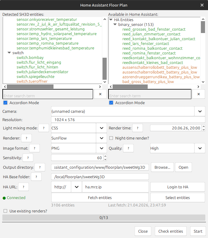

Il y a également un fork qui ajoute pas mal de fonction:
choix du chemin sur HA
pouvoir faire un rendu pour la nuit aussi
ajouter les sensors binaires (ouverture fenetre/porte)
et bien d'autres
Fork: GitHub - dajuly20/home-assistant-floor-plan at feature/ha-integration-improvements · GitHub
Ça arrivera certainement un jour dans l'addon original:
master ← dajuly20:feature/ha-integration-improvements
ouvert 12:11AM - 22 Apr 26 UTC
## Summary
- Add Home Assistant API integration to fetch entities directly from … HA
- Add OAuth2 login flow for secure HA authentication
- Add entity caching with 3000+ entities support and fetch timestamp
- Add dual entity trees: detected SH3D entities and HA entities with search/filter
- Add configurable base folder/subfolder name for output files
- Add camera selection with camera-name based output paths
- Add live render preview and progress indicator (0/13 style)
- Add resolution field configuration
- Improve UI with accordion mode for entity trees
- Add help buttons (?) throughout the interface
- Add "Open" button to quickly access output directory
- Add "Select entities" dialog for entity matching
- Add "Check entities" validation before rendering

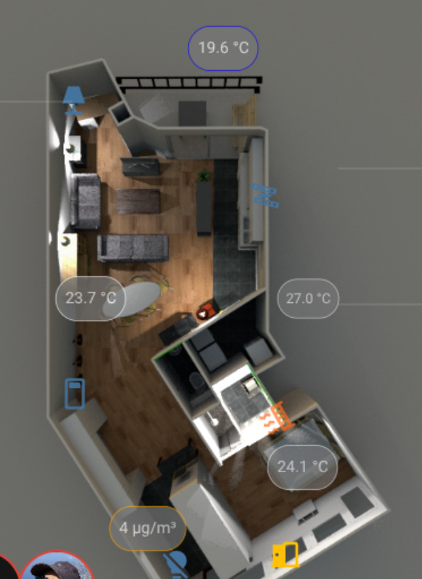

Sinon un autre délire mais qui peut faire la meme chose en verrouillant une vue:
<p align="center">
<img src="assets/logo.svg" alt="Owlnest" width="200" />
</p>
<h1 align="center">Owlnest</h1>
<p align="center">
<strong>Votre maison en 3D, directement dans Home Assistant.</strong><br/>
Chargez un modèle 3D, placez vos appareils, contrôlez tout en temps réel.
</p>
<p align="center">
<a href="#installation"><img src="https://img.shields.io/badge/Home%20Assistant-2024.1%2B-41BDF5?style=for-the-badge&logo=homeassistant&logoColor=white" alt="Home Assistant" /></a>
<a href="#installation"><img src="https://img.shields.io/badge/HACS-Custom-FF6F00?style=for-the-badge&logo=homeassistantcommunitystore&logoColor=white" alt="HACS" /></a>
<a href="https://github.com/MestrieEsteban/ha-owlnest/releases/latest"><img src="https://img.shields.io/github/v/release/MestrieEsteban/ha-owlnest?style=for-the-badge&color=6C63FF" alt="Release" /></a>
<a href="LICENSE"><img src="https://img.shields.io/github/license/MestrieEsteban/ha-owlnest?style=for-the-badge&color=22C55E" alt="License" /></a>
</p>
<p align="center">
<img src="https://img.shields.io/badge/statut-beta-orange?style=for-the-badge" alt="Beta" />
Ce fichier a été tronqué. afficher l'original
C'est tout 3D et le rendu de la lumière est fait directement dedans!!
J'ai exporté mon SweetHome3D en OBJ, ouvert dans Blender et exporté en GLB. Mon plan 3D avait de drole de couleur dans Blender mais ça rend correctement quand meme. Du coup j'ai réalisé que j'ai un plafond dans mon plan que dans la moitié de mon appartement
