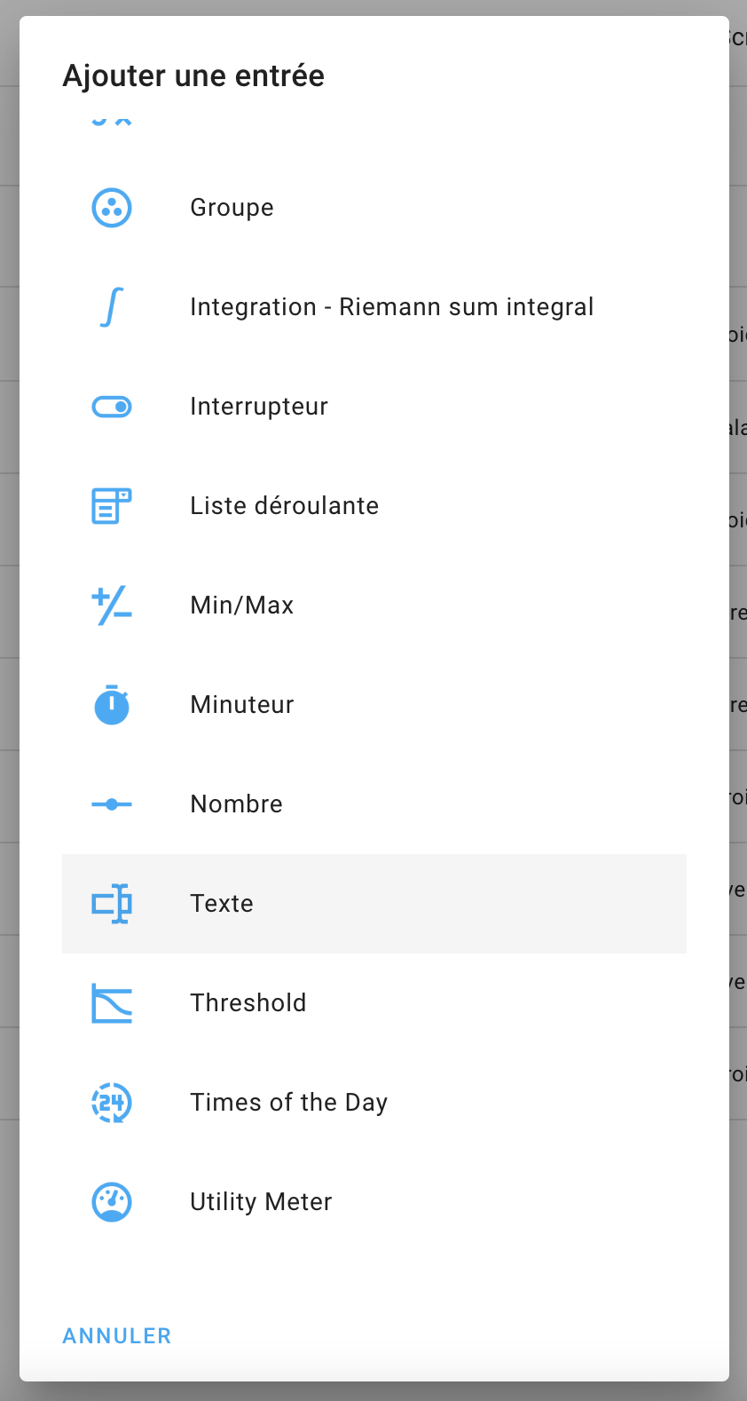

- service: input_text.set_value
value: '{{states("alarm_control_panel.somfy")}}'
entity_id: input_text.backup_alarmstatus
3. Récupération de l’état au démarrage
alias: Alarm Startup Restore Status
description: Restorer le dernier état de l'alarme connu au démarrage
- platform: homeassistant
event: start
- service: ifttt.push_alarm_state
entity_id: alarm_control_panel.somfy
state: '{{states("input_text.backup_alarmstatus")}}'
initial_state: 'on'
