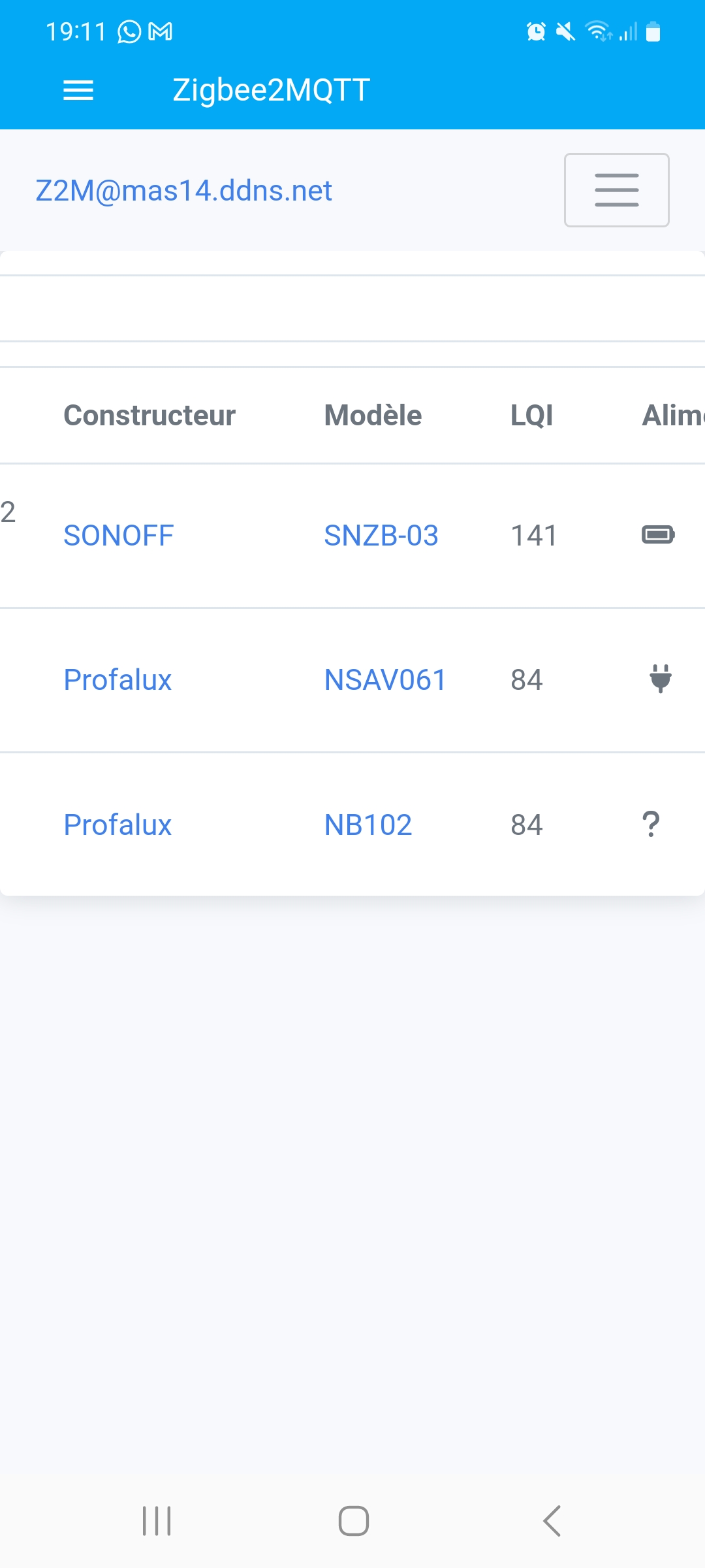

J’ai appairé 1 volet. Voici la fin des log de Z2M.
|[2024-10-13 19:05:23] info: |z2m:mqtt: MQTT publish: topic 'zigbee2mqtt/bridge/event', payload '{data:{definition:{description:Cover remote,exposes:[{access:1,category:diagnostic,description:Link quality (signal strength),label:Linkquality,name:linkquality,property:linkquality,type:numeric,unit:lqi,value_max:255,value_min:0}],model:NB102,options:[],supports_ota:false,vendor:Profalux},friendly_name:0x20978affff000f25,ieee_address:0x20978affff000f25,status:successful,supported:true},type:device_interview}'|
|[2024-10-13 19:05:49] info: |z2m:mqtt: MQTT publish: topic 'zigbee2mqtt/0x00124b002fa10552', payload '{battery:100,battery_low:null,linkquality:141,occupancy:null,voltage:3200}'|
|[2024-10-13 19:06:29] error: |zh:zigate: source endpoint 242, not supported|
|[2024-10-13 19:06:49] info: |z2m:mqtt: MQTT publish: topic 'zigbee2mqtt/0x00124b002fa10552', payload '{battery:100,battery_low:false,linkquality:141,occupancy:false,tamper:false,voltage:3200}'|
|[2024-10-13 19:07:24] error: |zh:zigate: source endpoint 242, not supported|
J’ai redémarré le raspberry pi. J’attends de voir s’il va se passer quelque chose !
Nsav061, c’est le moteur, l autre c est la télécommande. Ne surtout pas la supprimer sinon elle ne pilotera plus le volet.
